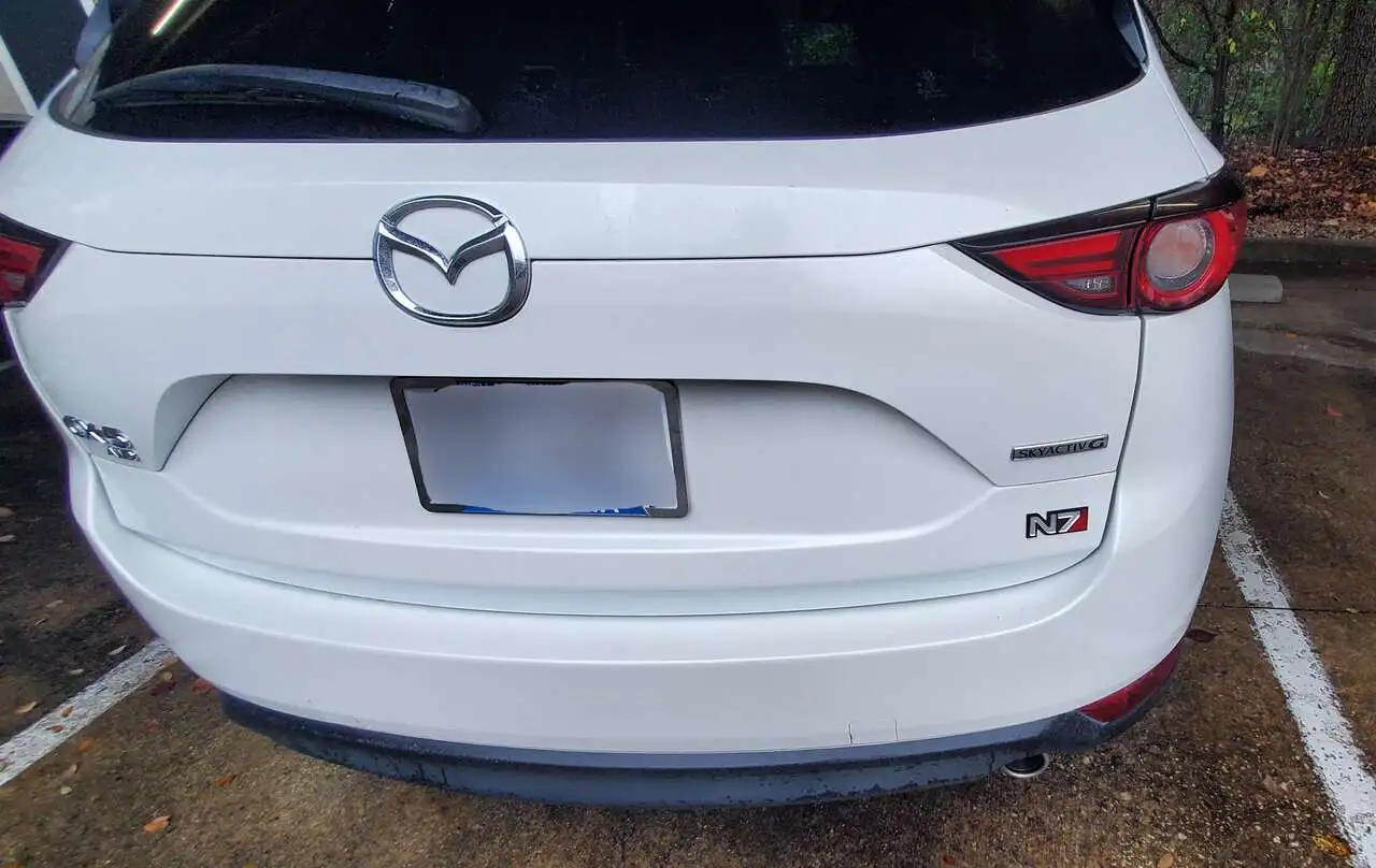

Well... few cents from me - that sound I hear does sounds very electrical. I don't know if you ever ridden an e-bike but honestly it sounds like electrical current whine when you accelerate/decelerate. So another reason could be alternator issues. What's more important, another person on Reddit with exact same whine noise managed to get the transmission replaced under warranty. And the noise was gone! It took him 2 trips to dealership, calling corporate and another trip to a third dealership to get it replaced. Soo... I'll get back to this thread after my trip to dealership in January.
ps: funny, I have N7 tag on my CX5

Show me the N7!
