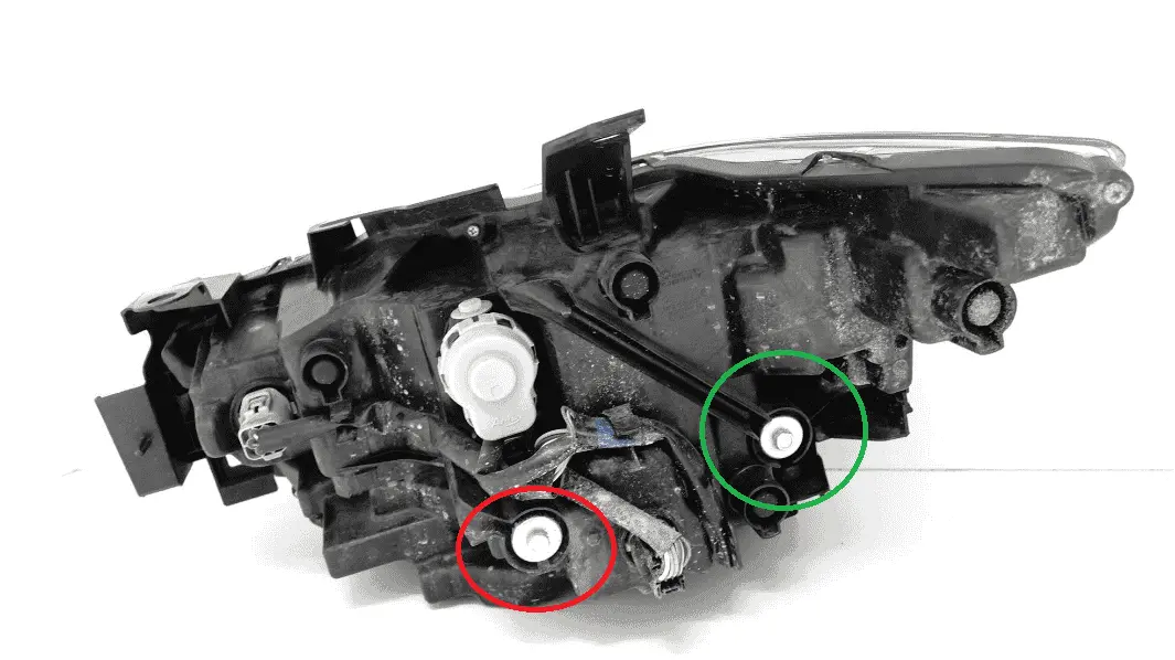

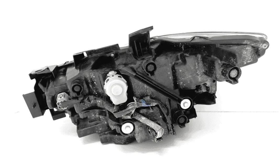

Anyone figured out a way to adjust up/down the new 2022+ lights?
There are 2 screws and i'm not sure which is the correct one for up/down.
This same issue bothered me when I first got my 23 Carbon. I made a custom socket to make the adjustment easier and faster. I would actually drive around my neighborhood at night and get out and adjust them a bit. Took me several weeks of fiddling. I finally gave up and made a compromise between High bean being too high and low being too low. And no they are not adjustable separately. Good luck.
I just need to know what to turn to move it up and down so i can try to set it up myself.
Green or Red is for up/down?

If you are talking about a 23, then with a 10mm socket I think I remember, insert into the back of the housing an turn. I even made a sticker over each light to remind me which way to turn. I'll send you pics of my tool if you want. Send me a PM. If you are talking about a 22, I don't know the answer.

Good movie but with the older head lights. I just want to know if i need to turn Green or Red screw to set it up/down as i don't want to move left / right.
Shine them on a wall at night and turn one of them and see what happens. If it is not what you want, then it is the other. Trial and error.
