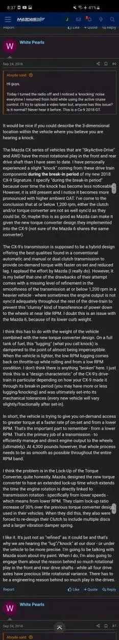

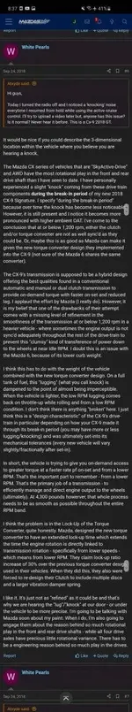

I found this post by a member which I found interesting and informative. I am wondering if it's just the behavior of the CX9? Other than a small occasional knock noise, our CX9 drives perfect and no hard shifts etc.
Really kind of hard to read but I will say that small noises tend to amplify in the cabin. I had a weird noise that came from my rear end (that sounds wrong!) whenever I stopped hard or accelerated hard. Turned out to be lug nut key lock in the trunk "hatch" area that was moving around at times. I swore it came from somewhere else but that was it. I can even hear my eyeglasses moving around in the holder when I wear my sunglasses!
Sorry I just checked and it is tiny on the screen shot. I am copying and pasting below:
"The Mazda CX series of vehicles that are "SkyActive-Drive" and AWD have the most rotational play in the front and rear drive shaft than I have seen to date. I have personally experienced a slight "knock" coming from these drive train components during the break-in period of my new 2018 CX-9 Signature. I specify "during the break-in period" because over time the knock has become less noticeable. However, it is still present and I notice it becomes more pronounced with higher ambient OAT. I've come to the conclusion that at or below 1,200 rpm, either the clutch and/or torque converter are not as well sync'd as they could be. Or, maybe this is as good as Mazda can make it given the new torque converter design they implemented into the CX-9 (not sure of the Mazda 6 shares the same converter).
The CX-9's transmission is supposed to be a hybrid design offering the best qualities found in a conventional automatic and manual or dual clutch transmission to provide on-demand torque with faster on-set and reduced lag. I applaud the effort by Mazda (I really do). However, it is my belief that one of the drawbacks of their attempt comes with a missing level of refinement in the smoothness of the transmission at or below 1,200 rpm in a heavier vehicle - where sometimes the engine output is not sync'd adequately throughout the rest of the drive-train to prevent this "clumsy" kind of transference of power down to the wheels at near idle RPM. I doubt this is an issue with the Mazda 6, because of its lower curb weight.
I think this has to do with the weight of the vehicle combined with the new torque converter design. On a full tank of fuel, this "lugging" (what you call knock) is dampened to the point of almost being imperceptible. When the vehicle is lighter, the low RPM lugging comes back on throttle-up while rolling and from a low RPM condition. I don't think there is anything "broken" here. I just think this is a "design characteristic" of the CX-9's drive-train in particular depending on how your CX-9 made it through its break-in period (you may have more or less lugging/knocking) and was ultimately set-into its mechanical tolerances (every new vehicle will vary slightly/fractionally after set-in).
In short, the vehicle is trying to give you on-demand access to greater torque at a faster rate pf on-set and from a lower RPM. That's the important part to remember - from a lower RPM. That's the primary job of a transmission - to efficiently manage and direct engine output to the wheels (ultimately). At 4,300 pounds howerver, that whole process needs to be as smooth as possible throughout the entire RPM band.
I think the problem is in the Lock-Up of the Torque Converter, quite honestly. Mazda, designed the new torque converter to have an extended lock-up time which extends the time the engine rotation is directly linked to transmission rotation - specifically from lower speeds - which means from lower RPM. They claim lock-up ratio increase of 30% over the previous torque converter design used in their vehicles. When they did this, they also were forced to re-design their Clutch to include multiple discs and a larger vibration damper spring.
I like it. It's just not as "refined" as it could be and that's why we are hearing the "lug"/"knock" at our door - or under the vehicle to be more precise. I'm going to be talking with Mazda soon about my paint. When I do, I'm also going to engage them about the reason behind so much rotational play in the front and rear drive shafts - while all four drive axles have precious little rotational variance. There has to be a engineering reason behind so much play in the drives"
