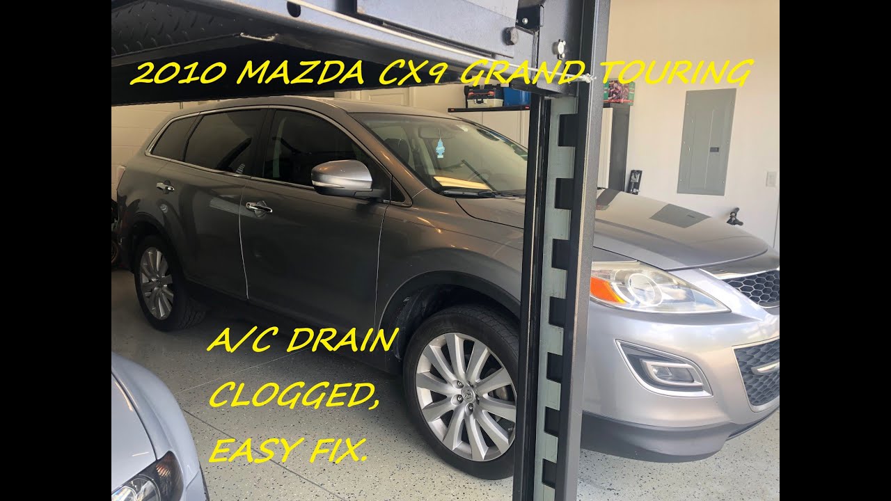

There is no corner of the heat shield to peel back as seen here:
Mazda CX9 Grand Touring, A/C drain is clogged. Easy repair.
Hello Everyone, here is my wife's CX9 with a clogged a/c drain. It's a real easy fix and just took a shop vac and some hose to to fix in the drain port.
