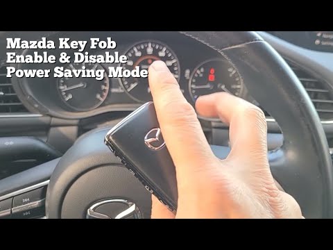

Never knew our cars had this. Seems like a waste of money and unnecessary complexity built into the car to save a $5 key fob battery! Glad you figured it out.
Yeap. YouTube is always a great place to find solutions.
It's my understanding that only the CX models that have the LARGE/HUGE fobs have this 'feature'.
