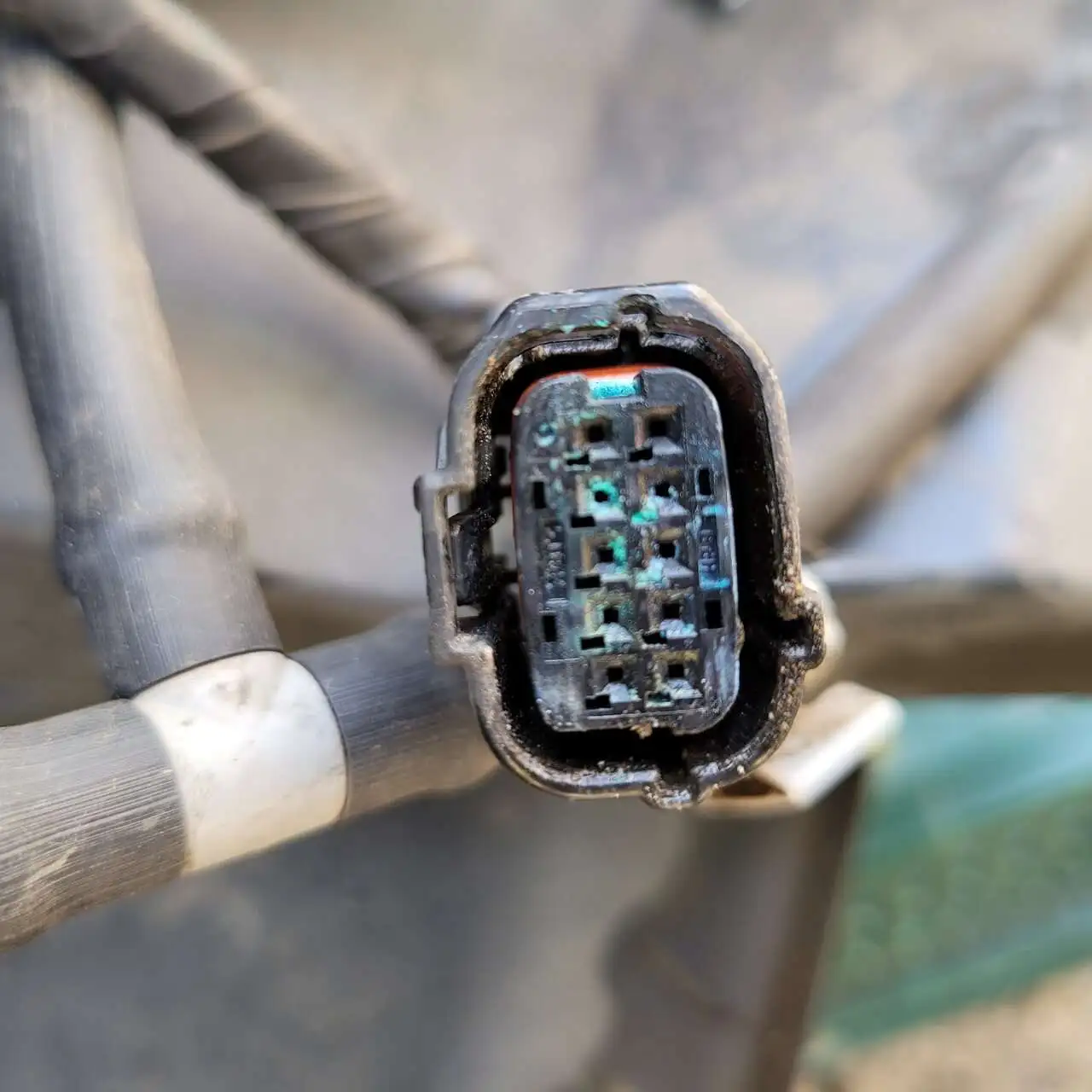

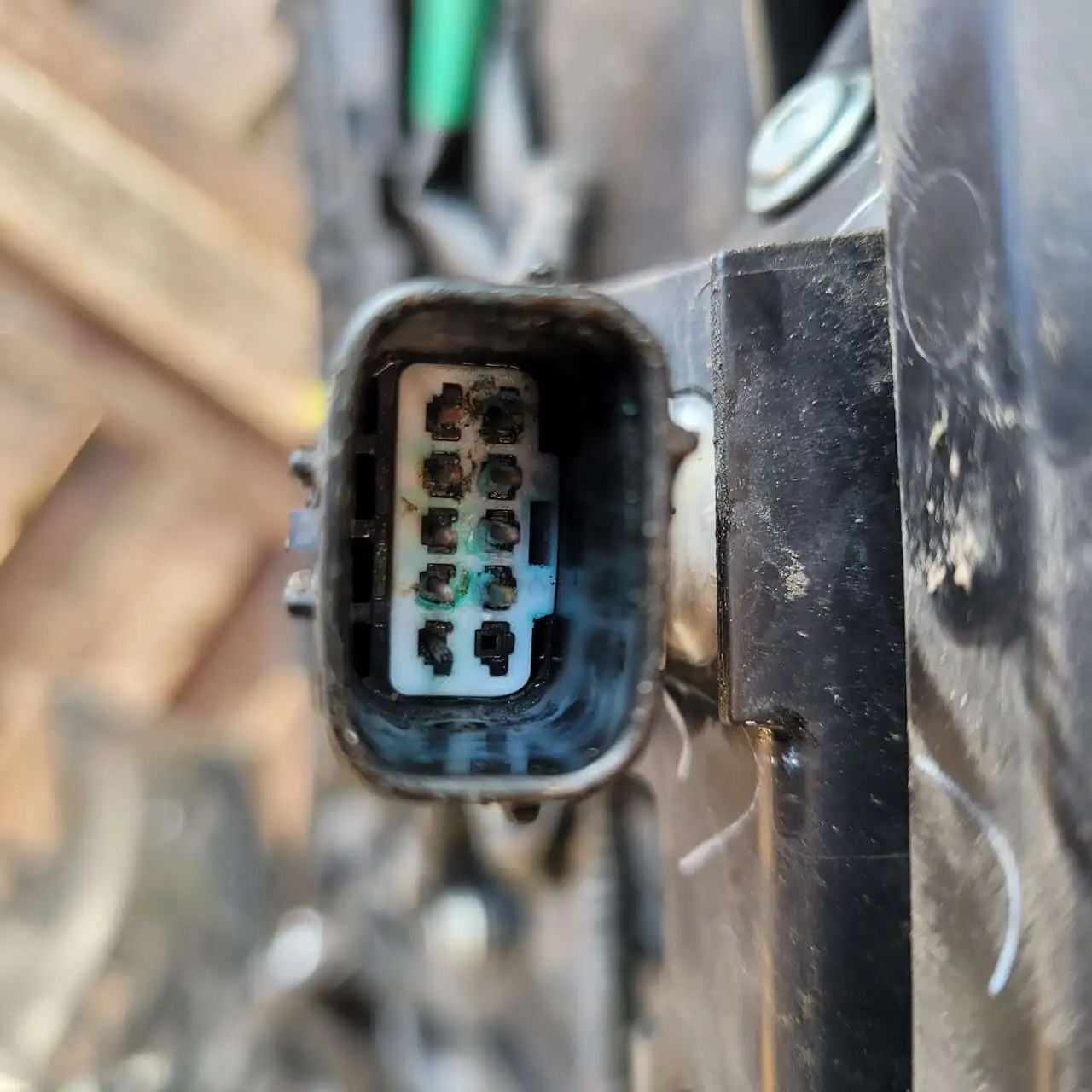

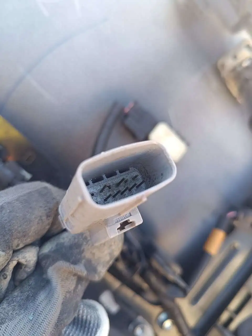

Hello,
Some news, I finally found the issue. Connector wet and connection rusty.

Hello,
I have exactly the same problem / sympthoms - bonnet and parking sensor indicator goes off. Where exactly is this connector located. I'm not able to find it based on the pictures
Thank you

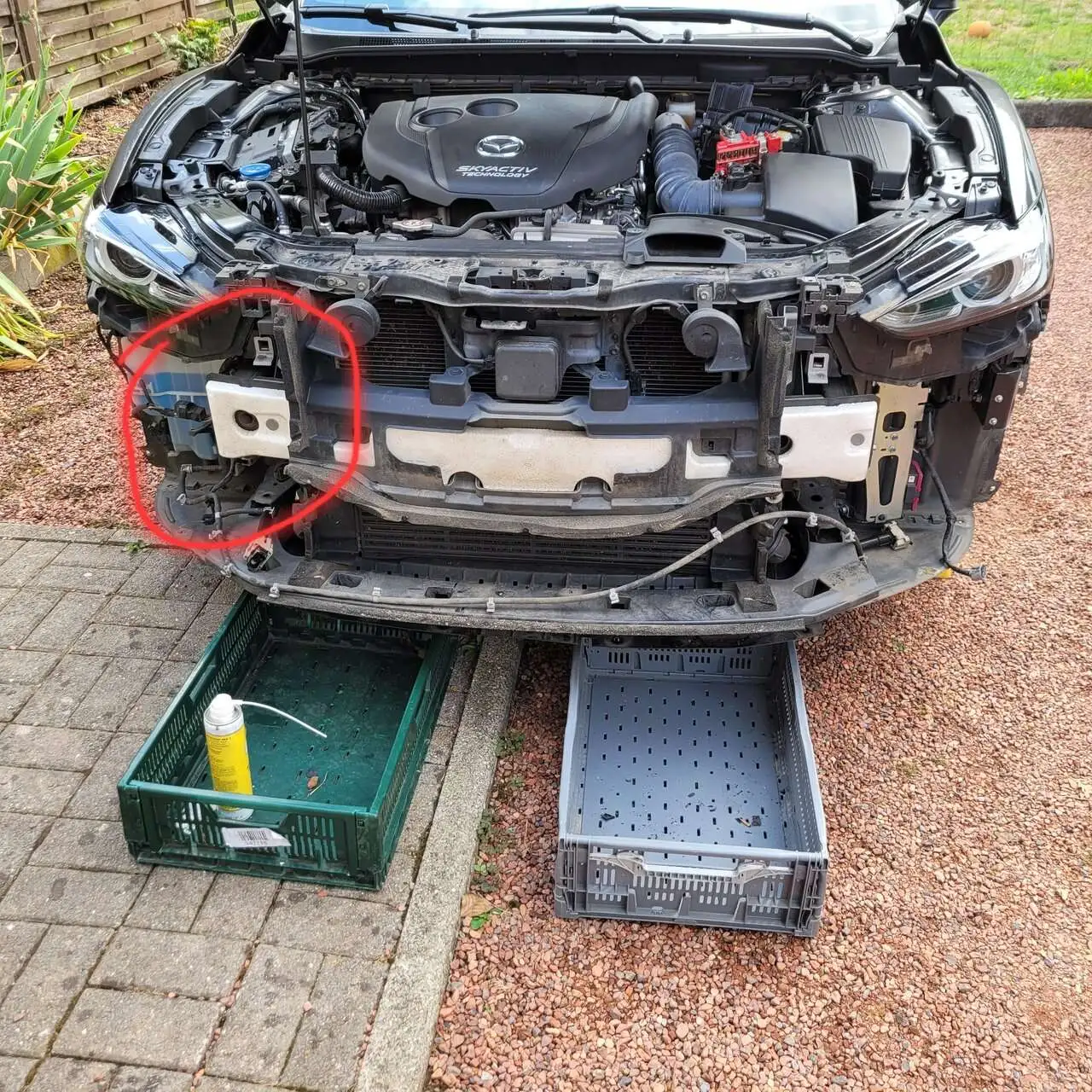

Hello,
The connector is behind the front bumper. It's necessary to remove it (easy job). The connector will be on the left when the bumper will be off.

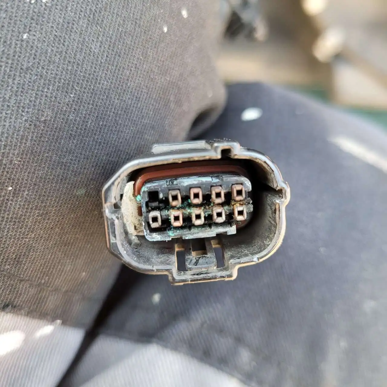

Thank you,
Same problem here after the bumper removal...the connectors were corroded...even some pins are broken off...I will have to replace the connectors...but you saved me a lot of time looking for the issue.
I suspect this is probably a common problem.
Thanks again
