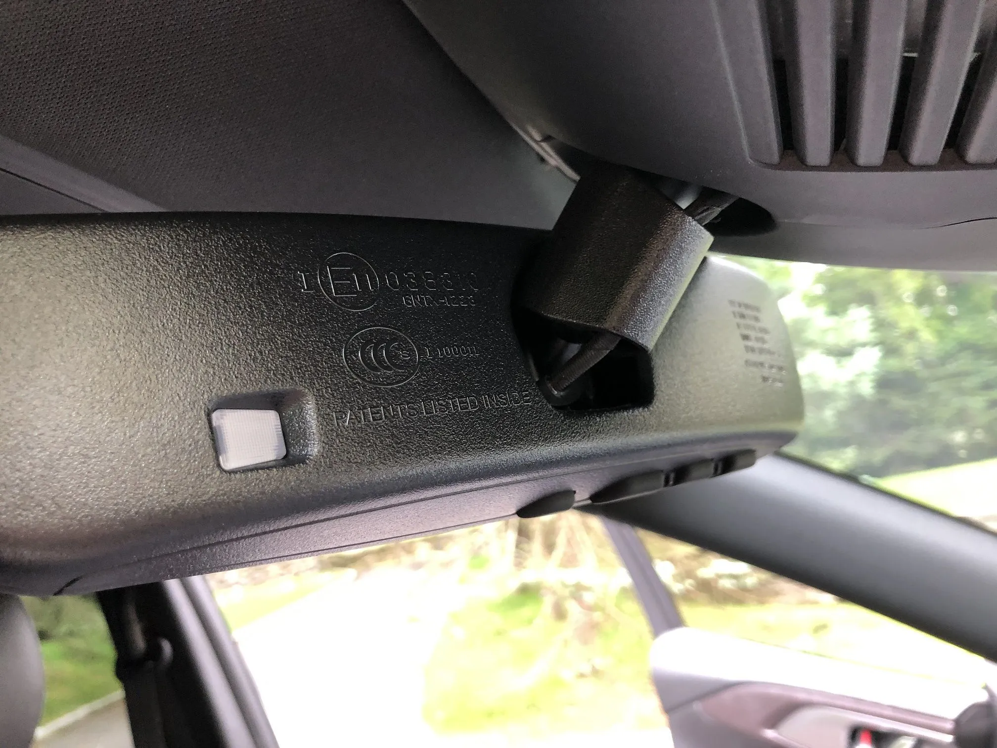

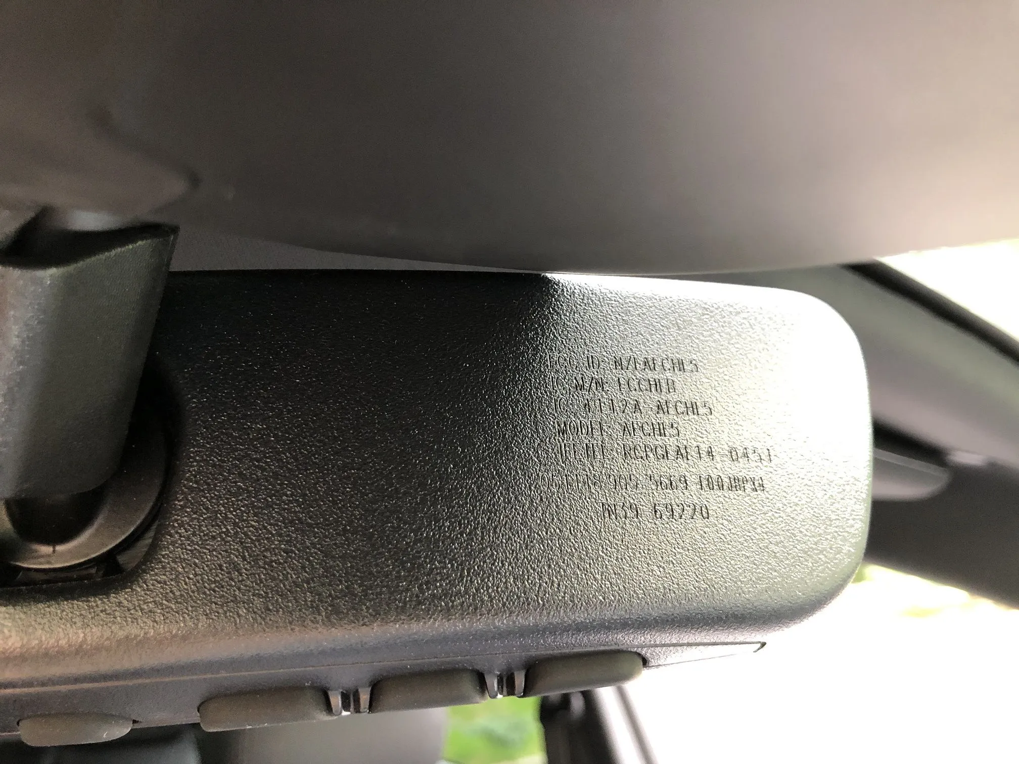

I had a 2017 CX9 and it was easy to mirror tap for switched power so I can power my radar detector.
The 2019 CX9 GT has a different mirror and NO exposed connectors to TAP. Has anyone figured out how to get switch power from the rear view mirror?
View attachment 221035View attachment 221036
The connector may hide behind the interior trim. According to the attached picture, it is not far from where the mirror cable goes into the trim.
Remove the plastic housing for the sensors/camera and you will see the connector. It pries off easy, pull them apart sideways.
