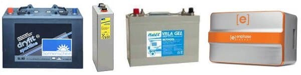

There's multiple reasons you'd want it for a car. One is they tend to deliver current faster and more reliably even in cold weather. They charge faster, making them better for those who regularly drive short trips (like I drive my kids to school which is less than 1km).
The main reason however is their deep-cycle capability, or cycle-rating, which means you can run them down to the point where you can't start your car, and then charge them back up again with little damage (keep doing this however and eventually you will kill it, but a lead-acid would die well before an AGM). Regular lead-acid batteries are damaged severely when they are fully or partially drained, but AGM batteries a lot less so. Also, you can leave them unused for longer periods without worrying about them discharding. GEL batteries are actually even better at this but they also cost more (Optima). But the fact is that led/acid batteries are just really bad in this department, you really need to keep them charged all the time and can't let them sit for too long as they just naturally loose charge. So I think it's worth the extra cost. I used to run Optima batteries, but I find there's little reason to spend that much with AGM batteries being almost as good.
Another advantage is that you don't get that green crud all over your battery terminals.

Ah...absorbed glass mat (AGM) batteries are lead-acid batteries. They are not flooded lead-acid batteries. An Optima spiral cell battery is not gel, it is AGM. "An OPTIMA battery is neither a gel battery nor a regular flooded battery. OPTIMA is a SPIRALCELL TECHNOLOGY AGM battery."
https://www.optimabatteries.com/support
An Optima Red Top (engine starting) Group 35 battery on Amazon is $199 with Prime free shipping. An Interstate flooded lead-acid battery from Costco is $85. It's hard to justify the cost of any of the AGM batteries unless there are special circumstances. AGM is leak proof, very vibration resistant, and somewhat better performance. When I next need a battery, it's off to Costco for me.
