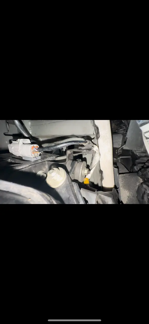

Honestly I don’t even know if I’m looking in the right spot. I talked to someone on Reddit who is helping me. Is it this gray wire and you follow it to the top? I would’ve taken my bumper off already however a stupid screw got threaded and I can’t get it out.
Honestly I can't say for sure, it's hard for me to tell the orientation. The connector is right at the upper left corner of the intercooler if you're looking at it from the front.
One of the reasons I took the bumper off is because of how hard it was to disconnect that connector the first time. I knew where it was and I could feel it going through the lower grille area, but I just couldn't get a good hold on it. If you figure out a way to extract or drill out the stripped screw, it's worth doing. Good luck!
