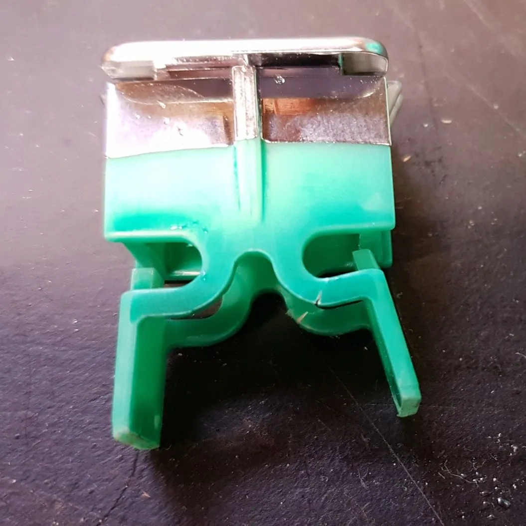

I broke one during the install on my 2016. I used a bit of JB Weld and it was as good as new.
I did get it out. All i know is it won't click into place.
I just installed roof rails on my 2019 CX-5 and one clip broke on installation. I used two surrounding blobs of JB weld to reinforce the break and held the tabs with a mini C-clamp while it cured.

The part number is 0000-8L-R06. I googled around and was able to find the dealership with the lowest shipping cost. My local dealer wanted $10ish for it.

I'm trying to remove my side rails and roof racks. Does anyone know how to get these things out? There are two very small holes on each side.
You push a pin in the small holes and it’ll pop right out (the plastic covers).
Yes I just figured it out and used parts of a cheap clothes hanger. I thought I would have to push in those big green clips at the bottom but its only the tiny little metal looking parts at the top. Thanks for the quick reply!
