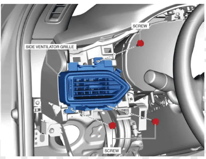

The panels above and below the vent just unclip, then the vent itself is held by 3 screws. Very easy.
Example (lower trim):
.. and vent:
