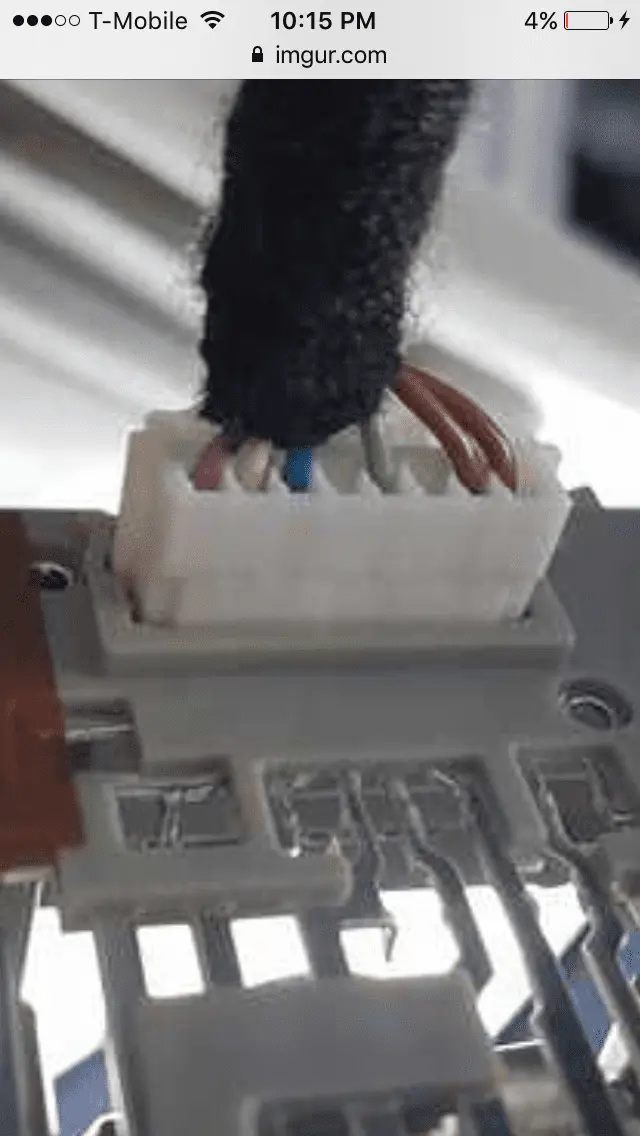

I manage to pop the map light open. These wire are the one I am looking for now at the foot fuse box area with no success. Even if I found it, I wouldn't know which color wire to tap in to.

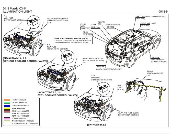

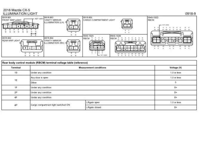

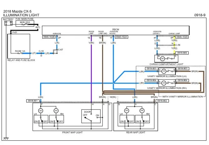

Attached is the illumination light schematic for 2018 CX-5. Find the RBCM in the rear panel on the driver side. You can tap red ("+") / black ("-") wires of your sill-plate LEDs to light-blue(L) ("+"; connector 1F) / brown(BR) ("-"; connector 1B) wires out of RBCM. Or trace light-blue and brown wires from front or rear map light connector which should lead to RBCM. You should be able to tap these 2 wires at any convenience place in between. Of course make sure to use the fuse which is supposed to come with your kit to protect your expensive RBCM.

Not sure how you're able to get the diagram but right now I have a big man crush on you. I tried the red2bue and black2brown but there is a constant draw of about 11.25V. I was playing around and took a gamble on purple instead of brown. I see it flickering and no smokes. It's a good sign. It flows with the map light and turn off slowly when I closed the door. Another good sign. I think I pick the winner. I will do a hard wire tomorrow once I pick up some wires to complete this. Stay tuned. Thanks again yrwei52.
You're right, do red-to-light-blue and black-to-brown wire-tap would give you constant 12V. Based on schematic I'd do red-to-light-blue and black-to-white so that the sill plate LEDs can be totally in sync with map lights including the off/door/on switch functions. White wire is routed from front map lights to rear map lights along the left roof. It seems the easiest way to tap it is at the front map light connector. Here's the picture you took on front map light connector, 0918-901 in schematic and you can see the white wire there on pin G. Tap the black wire to violet (purple) wire with only door-open signal is fine too as you can only see the sill plate when the door is open anyway. But you can't turn them off or constantly on like the map lights.

Thanks for the suggestion but I already tap violet. I can not think of a time where I would need the sill powered on when I won't be able to see it. Got it all wired up. I bought blue/red wire. I connected them in reverse (red on red) and had a hell of a time trying to figure out what I did wrong. This turns out to be a good learning experience. Will share some video of the end result soon and my thought on the whole process.
