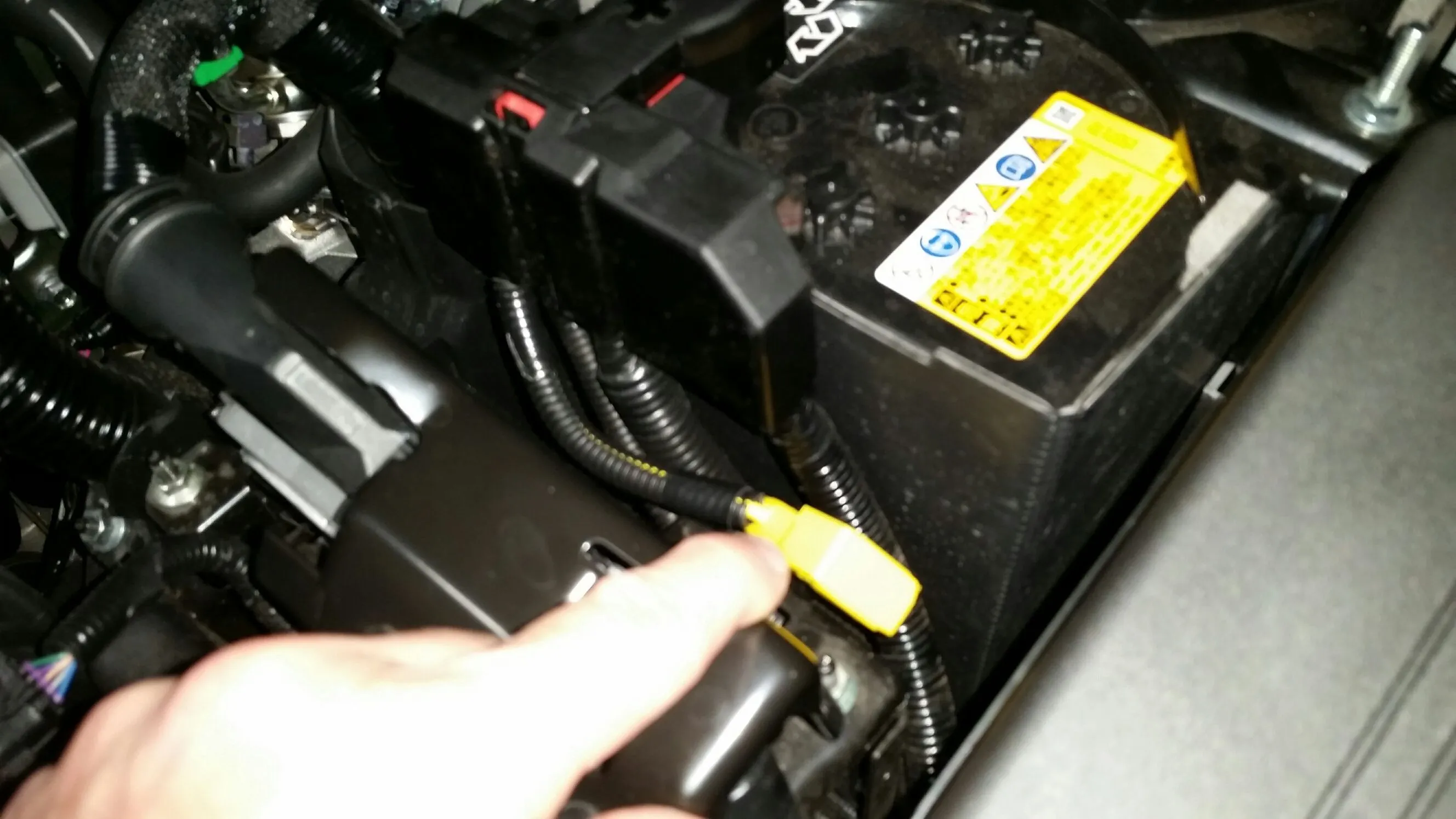

Now the POWER run to the battery. That was easier than the panel removal. The wire runs nicely down the drivers side trim panels. You have to take off the drivers rear so all that is left is removing the drivers front bottom door trim panel. Easily pops off. Wire was run in plastic loom and then up to the drivers side under the dash. From there all you have to do is run the wire through the rubber boot that sits under the dash. I used a rigid plastic fishing wire to get through. Then once inside the engine bay just wire it up to the positive bus terminal. There is a 15 amp fuse that is used to protect the circuit.

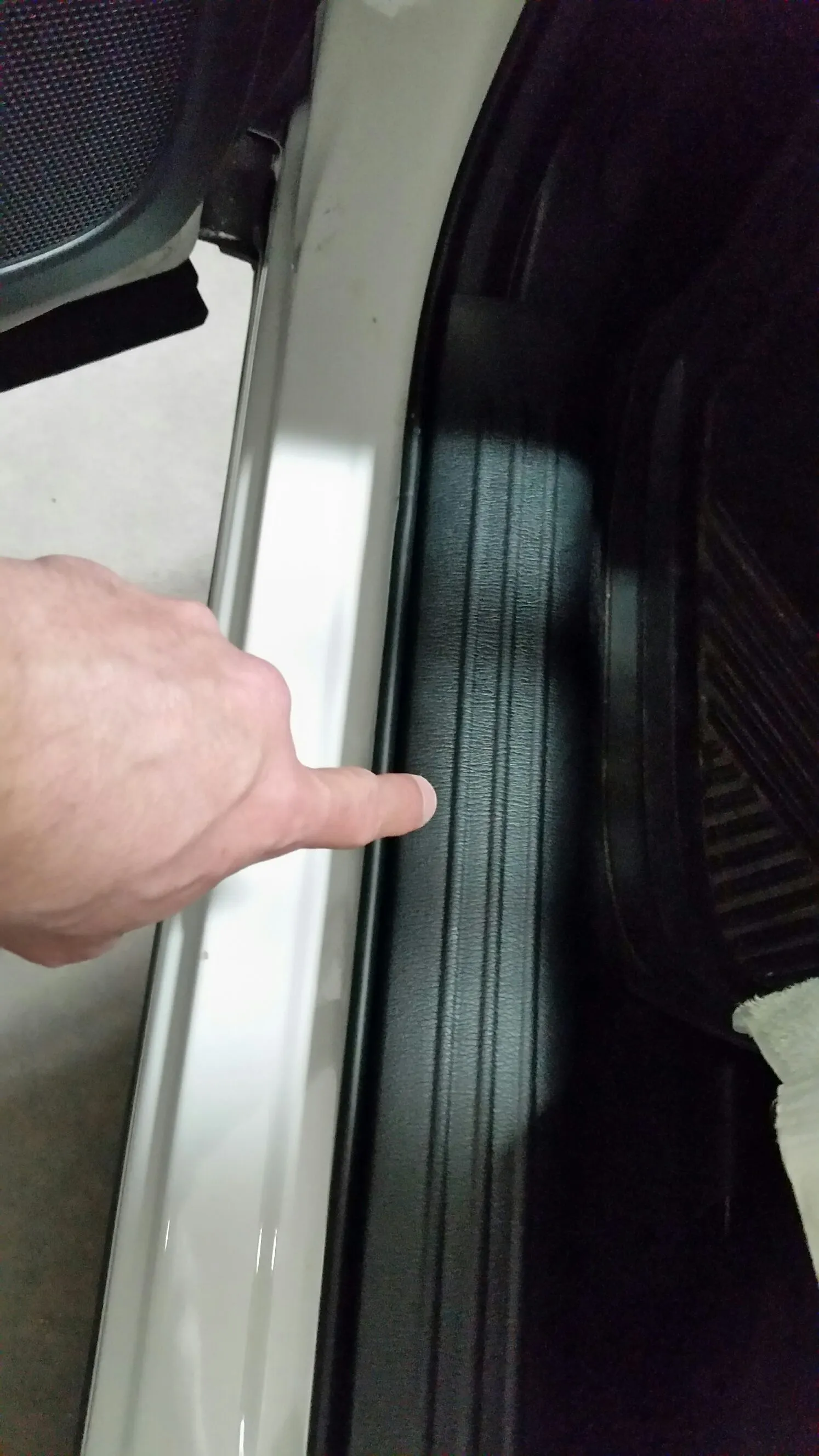

The power wire will start at the box of the hatch and then route it along the door sill area. There is plenty of room there. Just get 1/4" wire loom and encase the wire in it, just like the factory does with all the power wires. The plastic door sills pop out easy with the tool.

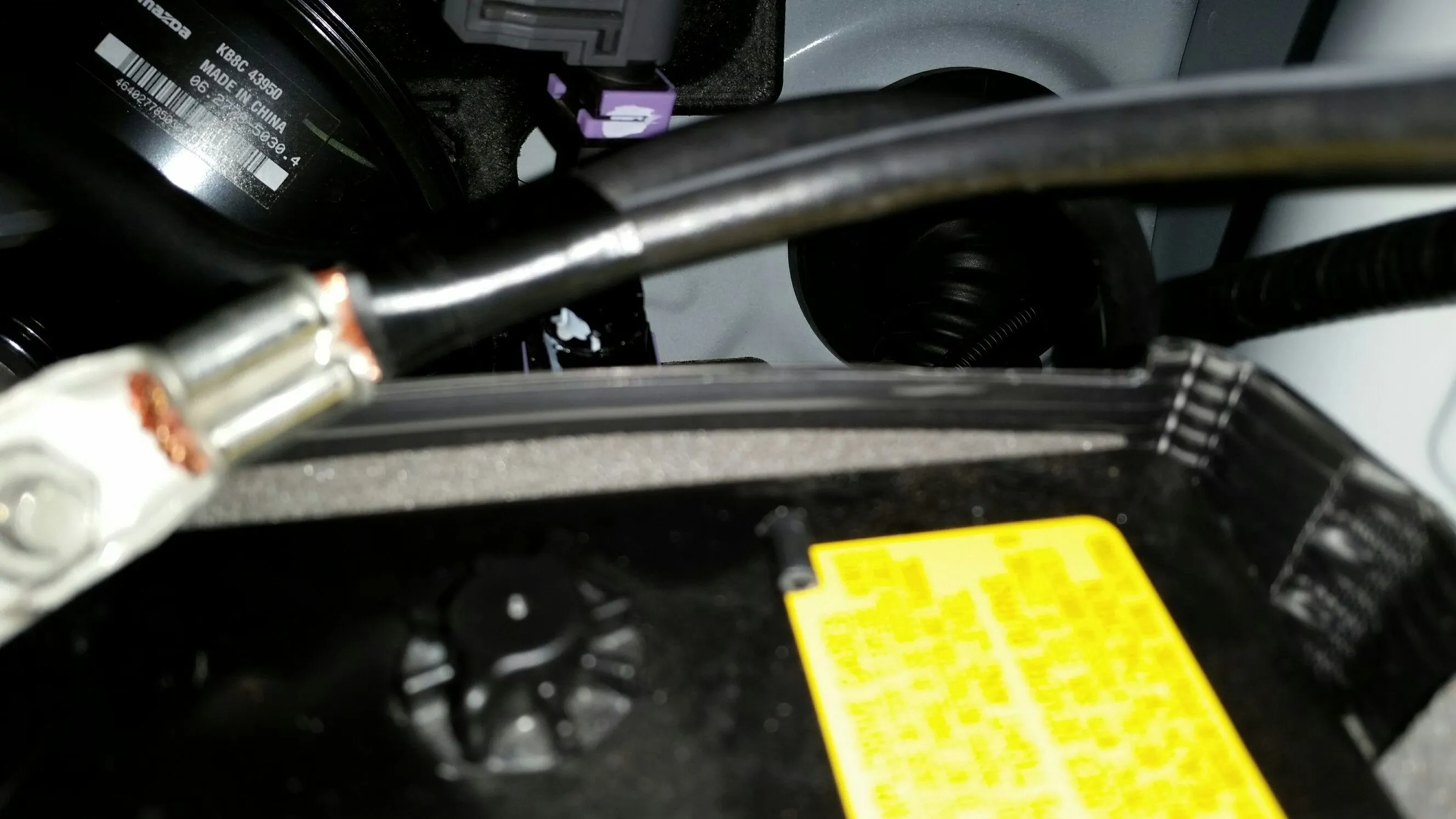

In the pic you can see a rubber boot on the firewall. Just run the power wire through there. A small cut must be made to push the wire through and then it's an easy run to the battery terminal.

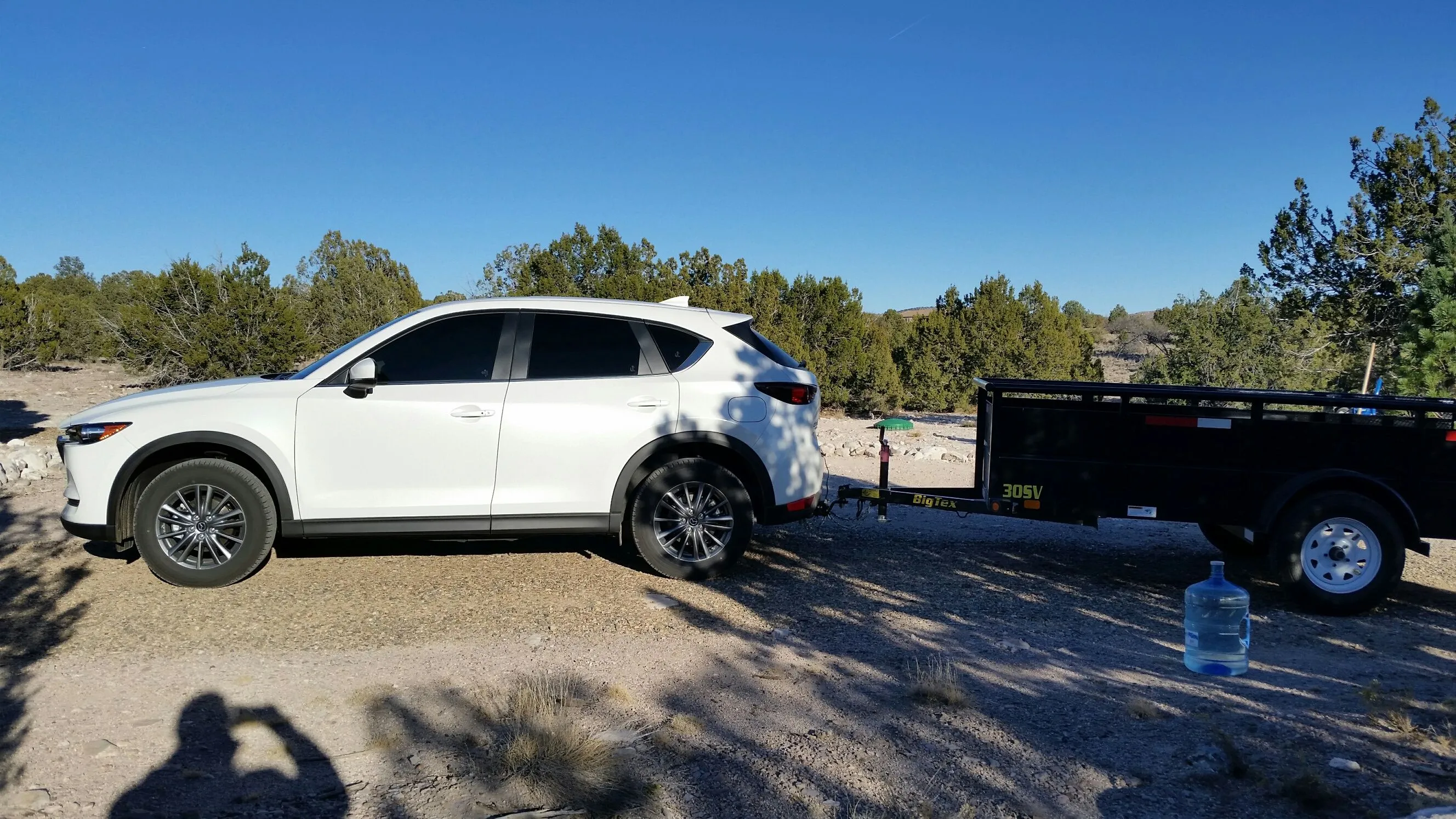

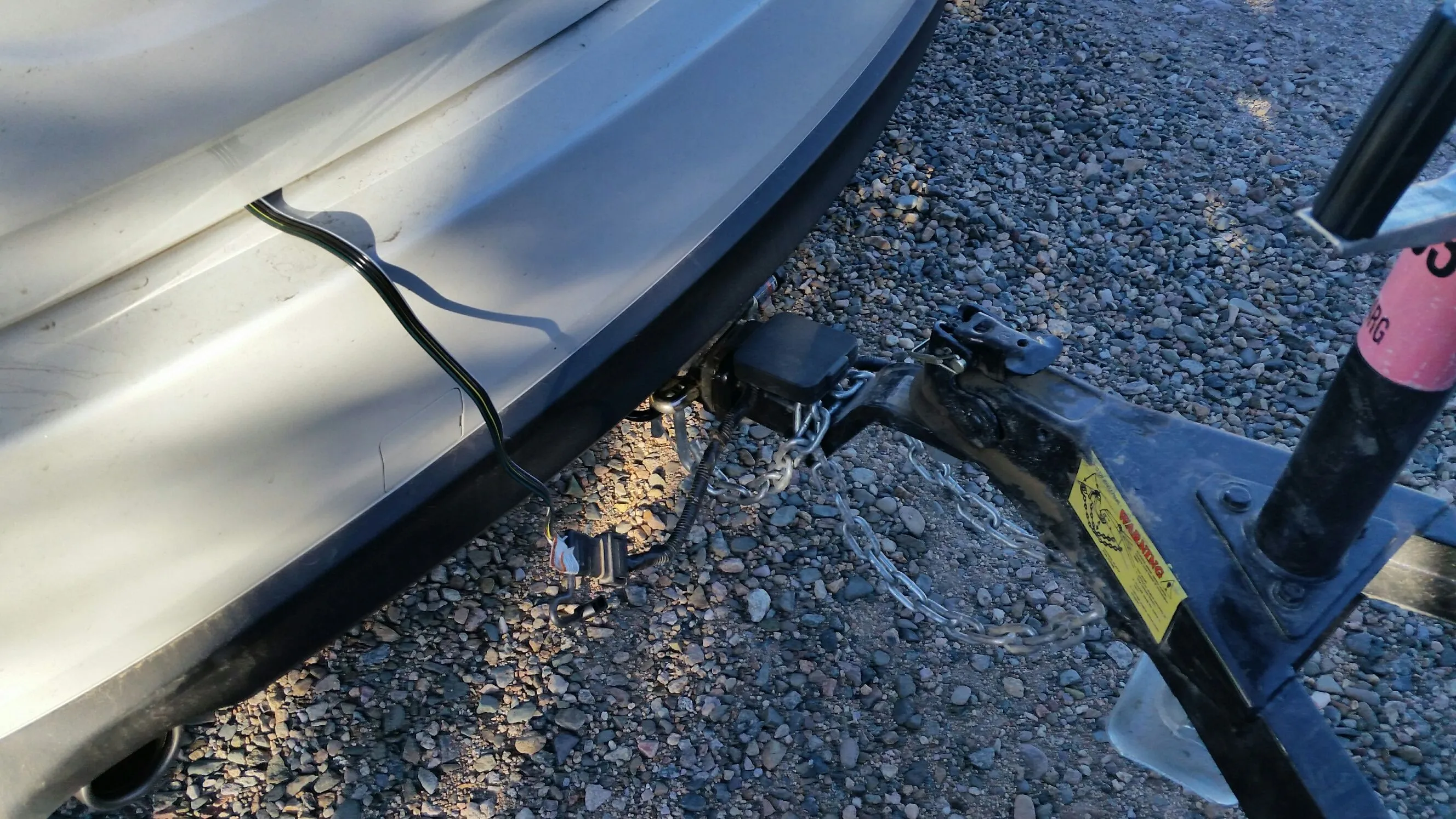

Here are the pics of the TEKONSHA wiring and the trailer. The wiring is flat so it just sits between the hatch gaskets. I like it also that it tucks away when not in use in the spare tire area.

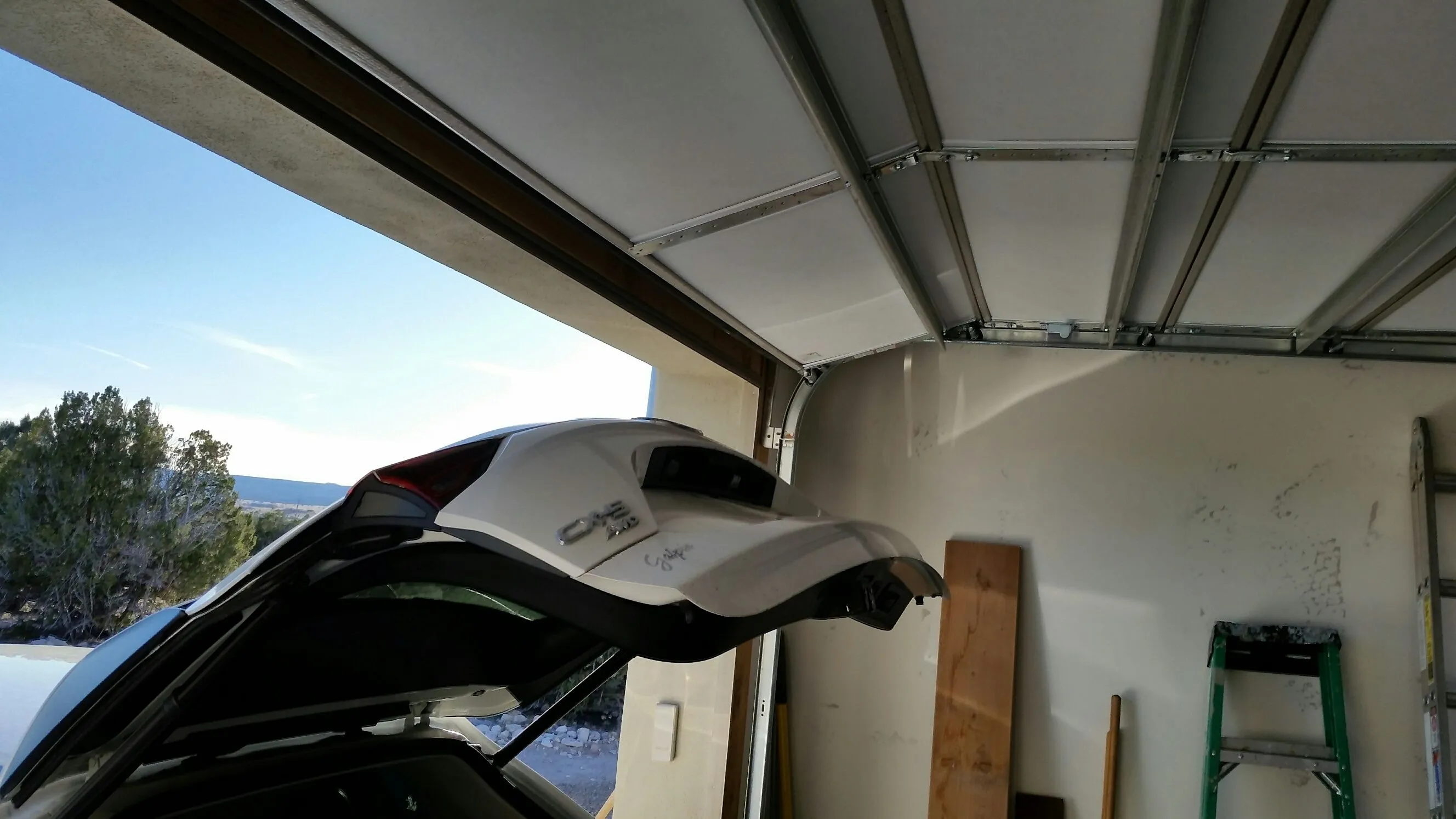

Also, my house/garage is custom built and I designed it for an 8 foot tall door. Most spec homes are 7 feet tall which would cause the hatch to strike the door header. I hate builders who stick in 7 foot tall doors. So lame and it causes a lifetime of headaches.
Looking good. I saw that and wondered, why are you backing into the garage with the hatch up. Duh, installing the trailer stuff indoors.
That looks like a good sized trailer. How much does it weigh? We're only rated at 2K towing capacity.
Thanks. Trailer weighs around 1,000 LBS. Actually the CX5 can handle 3,500 LBS of towing but US regulations limit it to 2,000 LBS. The same CX5 in Europe is allowed to tow 3,500 LBS with no other modifications. So it's not the vehicle that is limiting it, just the US highway regulations.
With that being said, I only tow about 2,000 LBS max since I never needed to tow more. I might have towed around 2,500 LBS back with my 2016 but it did fine. Just allow for greater length for stopping and you might have to wind it out on incline grades.
