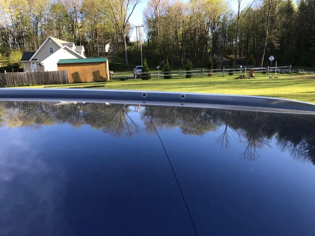

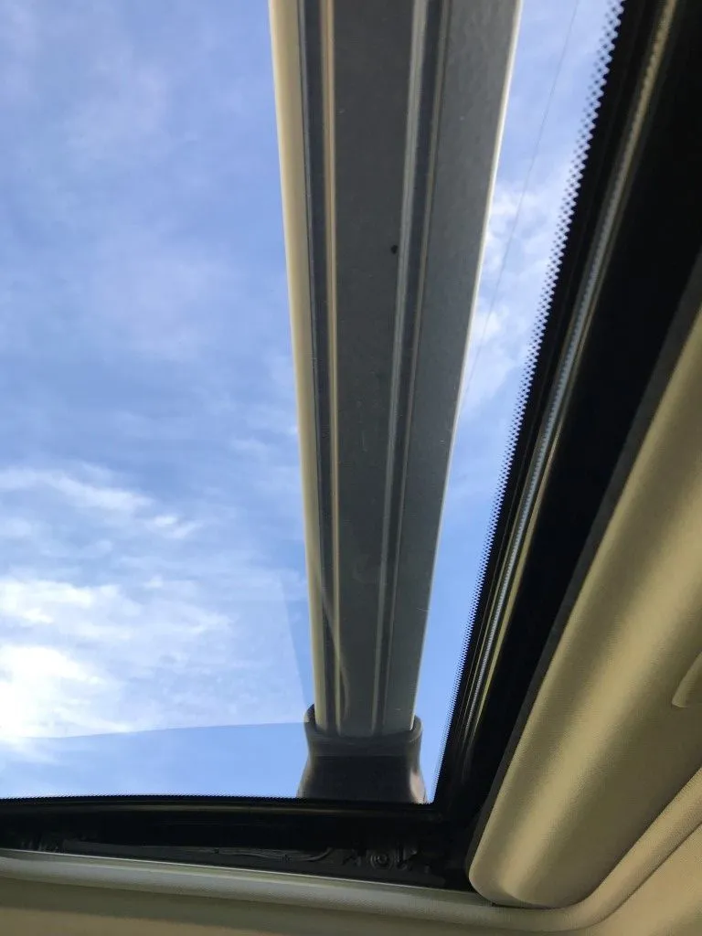

1. The Fit Kit KIT3160 is designed for a Mazda CX-9 with the flush rails. However, I looked at the CX-9 rails and noticed that they had the same mounting holes for the rails as the CX-5.

The fit kit attached to the rail without the installation cover

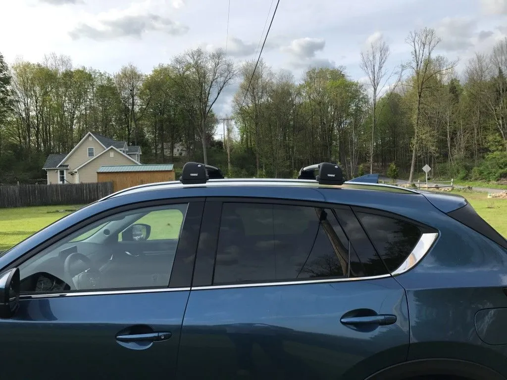

Side view after install

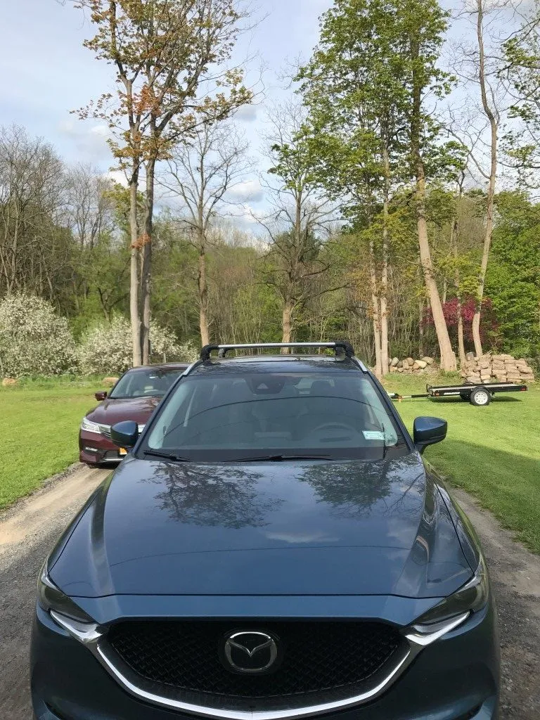

Front view after install

View from inside the car

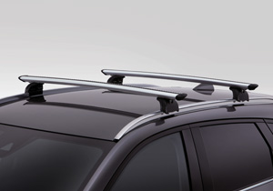

... both the factory cross bars and these aftermarket ones are fixed mount-point style on the rails.
I thought the whole point of the roof rails were so you could move the crossbars forward and back as needed. Is appearance the only reason then not to just mount the crossbars directly to the roof?:

I would bet the farm the factory bars will be the same. Look at the instructions for the CX-9 factory rails:
https://sep.yimg.com/ty/cdn/yhst-24...71.2062191019.1495672515-929585489.1493408302
Fixed mount point.
Plus these rails don't have an inner track as the old CX-5 rails did, so I'm not sure how exactly the cross bars would be able to move along the rail. I understand that it seems like it's cosmetics over function here, but some people seem to indicate they are flush rails for aerodynamic purposes. As far as load stability goes, I can't indicate how things would feel with factory cross bars, but since installing I've driven highway speeds with two 14' kayaks on the roof, everything felt just as good as it did on my prior CX-5.

I didn't even look at the link for the med center mazda cx-5 rails. Instructions for them show they are clearly fixed mount point as well.
https://sep.yimg.com/ty/cdn/yhst-24809172479195/0000-8L-R07.pdf
I notice that these have a 165lb load rating though. The old ones had a 100lb rating, so I would suspect the fixed mount point equates to the ability to carry heavier loads.
Seems like they have different roof rack options for different markets, not sure why. Those pics I posted above were from the Japanese website. And the ones on the rails really look like they can move forward and back.
The Med Center Mazda pic and linked installation guide apparently show the single OEM option in the US, which requires the rails.
The Australia accessories site shows this one (and they don't seem to have an option that uses the roof rails):
WTF?
