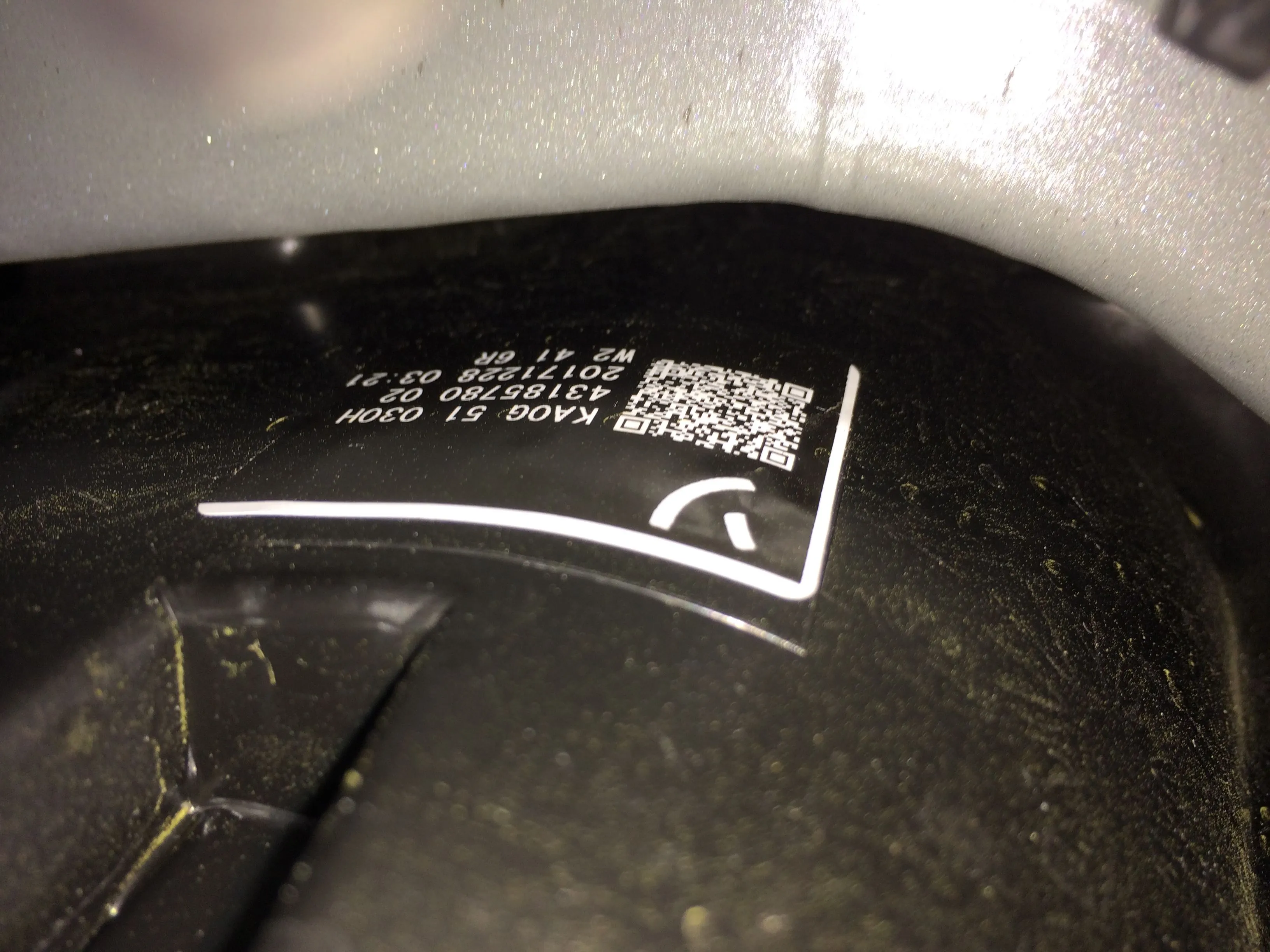

Wife just got back and its raining. Here are the info of my replacement LED headlights:
Passenger's side (installed 3/17/2018):
HL Sticker states: KA0G-51-030H (Manufacture date 12/28/2017)
Invoice states: KA0G-51-031J Unit (R), Head Lamp

Driver's side (installed 3/17/2018):
HL Sticker states: KA0G-51-040H (Manufacture date 12/13/2017)
Invoice states: KA0G-51-041J Unit (L), Head Lamp
attachment.php
So your H version LED headlight seems to be the same as my J version after all. :)

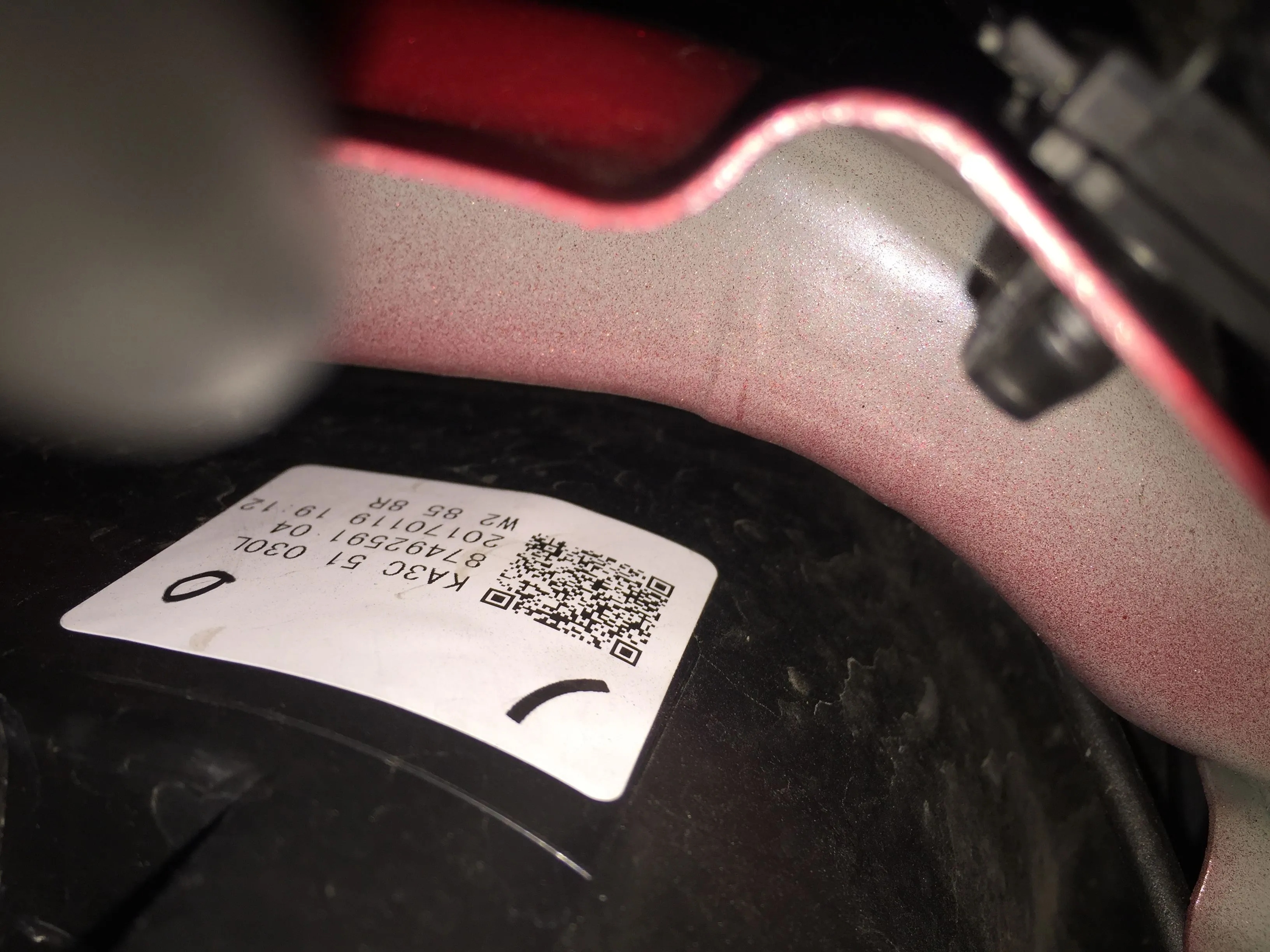

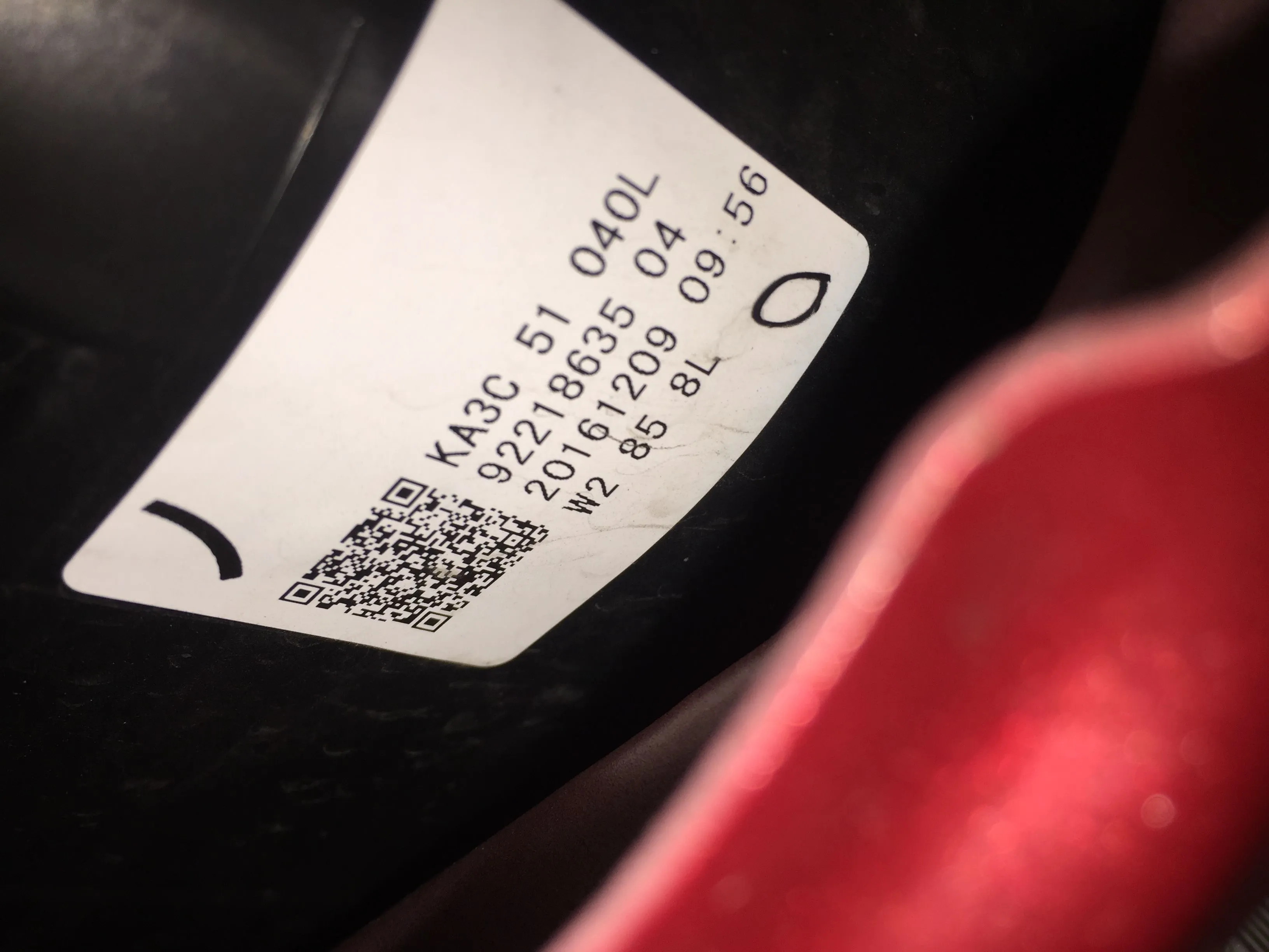

So would these be the good ones or not?

so would these be the good ones or not?

If these LED headlights with AFS, not the fancy ALH available in Australia, are from gen-1 CX-5, I believe KA3C 51 030L / KA3C 51 040L are E-code LED headlights used in everywhere in the world. In US we have DOT approved LED headlights which are different from E-code headlights, hence carry different part numbers.
Judging by the manufacture dates, 20161209 and 20170119, thesere also at the borderline of having the latest J version coming out in the US. Another way to tell is the Signature accent strip DRL on the latest J version LED headlight is a bit dimmer and looks like discrete dot-matrix LEDs instead of fiber-optical like LED DRL from earlier version.
They are the fully monty Australian ALH version, including with AFS, HBC etc as fitted standard to top of the range 2015/16 Akera.
https://www.mazda.com.au/imagination-drives-us/safety-adaptive-led-headlamps/
You have ALH, which is not available in the US, and its totally different from our LED headlights with AFS. Our LED Signature accent strip DRLs look like the pictures posted. Your ALH DRLs may look similar to ours. If they do, they may suffer the same issue from earlier versions.
