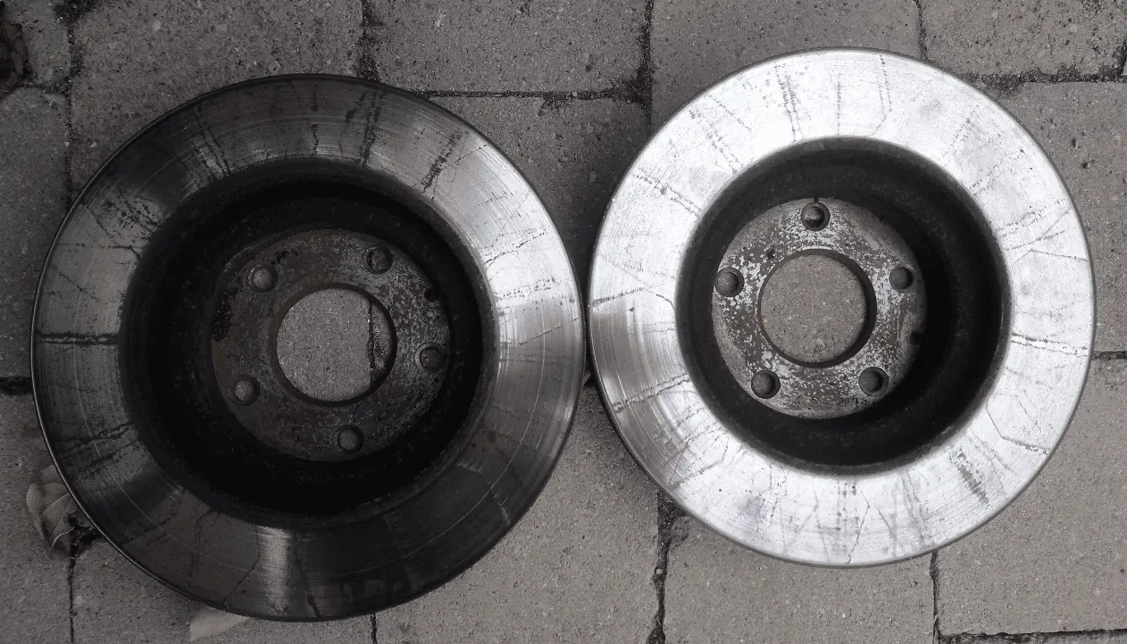

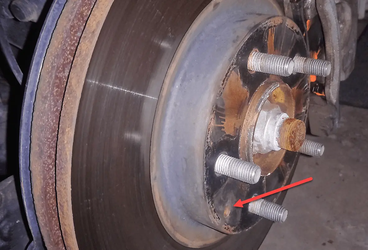

Just change my rotors this morning at the front (rear to follow) for the first since I bought it 2012. It had one pad replacement in between and turn out that its way overdue.
As for removing a rotor, i borrowed a nut from the engine bay (find something that a 12mm socket would fit) and use it on the hole provided in the rotor.
Worked like a charm and did not have to do some hammering/jiggling.
