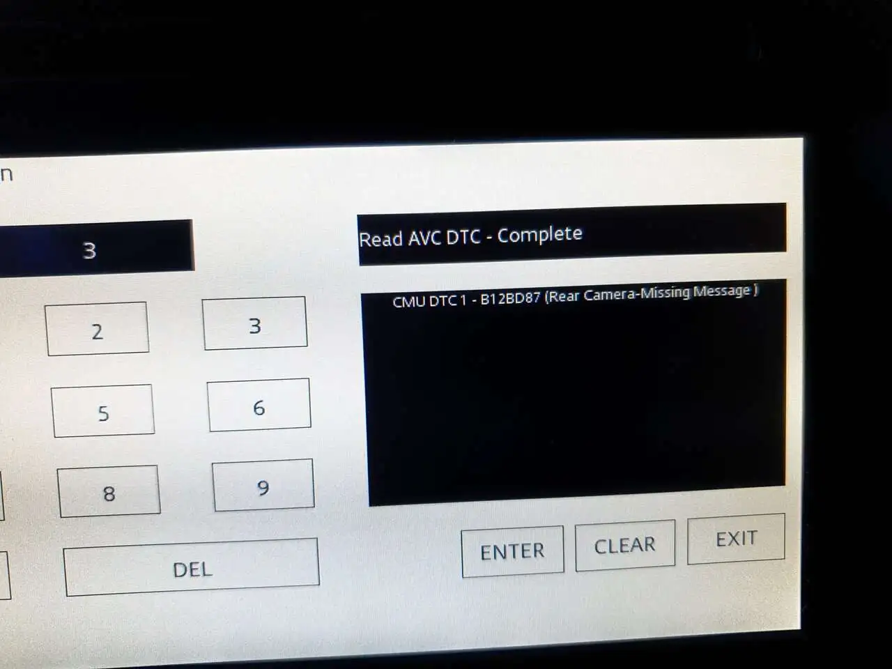

Maybe someone have this problem
i updated my cx5 2016 to ver 70.000.100 EU from 56.... EU
The rear camera working well after the update
But day after its stop working and when i change to Reverse its show black screen
Its happen to someone? I need to update to 74? Or its camera problem
What can i do?

I updated to 74.... and its the same issue.
When i do Factory Reset the camera works fine
But after that if i turn the engine off and lock the car and wait 3 min unlock the car turn the engine on then the camera stop working and show black screen.. but the Reversing sensors works fine.
Maybe its the sensors make this thing?
Or it samthing with the volteg? I dont know :(
I attach pic of the fault
