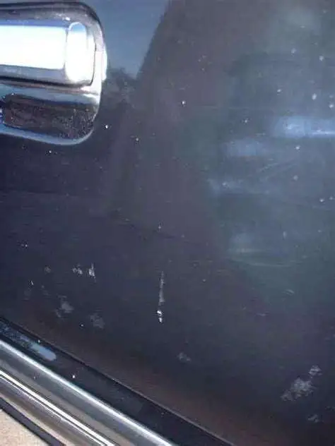

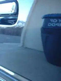

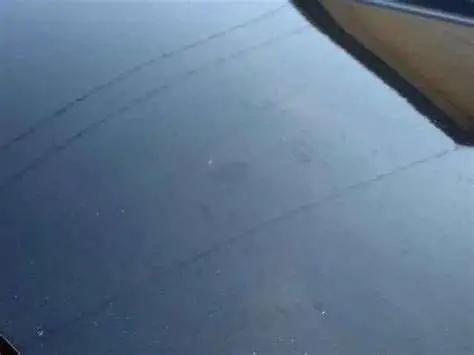

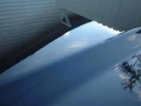

An example: polishing a gloss-black 1984 Ford Mustang that had lived a hard life and had never had a polishing and almost never had a "wax." Took about 8hrs to correct, and that was quick-and-dirty. But the result was night and day, if not perfect. Made all the difference on resale of that car a couple of months later.
