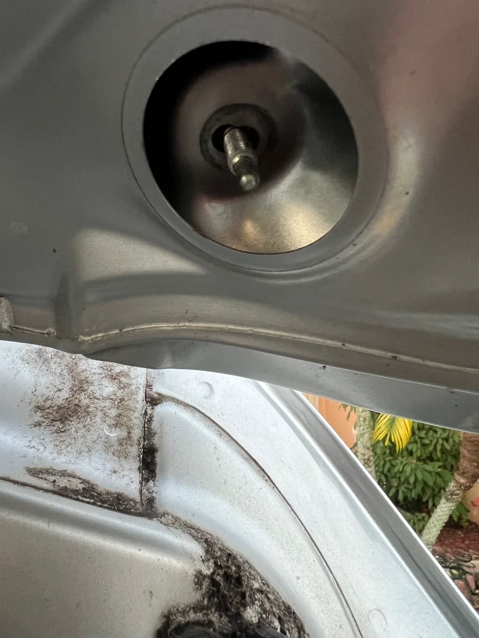

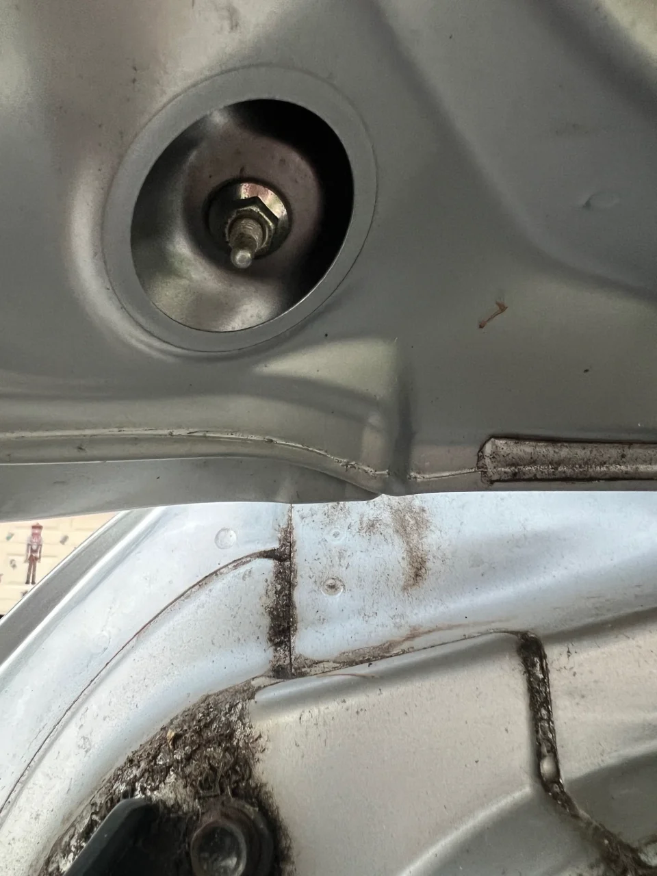

My 2016 CX-5 sport has been making a rattling sound in the rear. As it turns out when you lift the hatch, the right nut is missing. I guess this nut holds the spoiler. On the left side it was loose and I tightened it. What is the part # or type of nut that I can use?
It will be a metric nut. If you have calipers (or even a ruler) measure the diameter of the bolt (or inside diameter of the other side nut). Chances are it's 5mm, if so, you'll need an M5 nut.
Part # 90040-0663, a flange nut, size not given in parts diagram. The original nut may have fallen down inside the hatch, maybe try snaking a magnet in there to see you can retrieve it.

Can't seem to find the part # on a search. Would you be able to post the link to that part? I found that home depot has the following M6 x 1.0 nuts with nylon but they don't have the flange. Wondering if I could use these?
Wouldn’t need any Loctite if M6 is the right size. Double check the spare nut you have from the other side of the spoiler on the m6 post in Home Depot. If it fits, you’re golden. Those lock nuts would work fine
I just got the M6 lock nut from home depot and was able to use a wrench and tighten it up. Should I have used a washer with the nut?
I wouldn’t as long as the lock nut was snug. You’re good to go.
