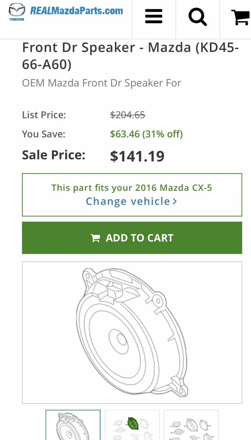

Just getting through the posts this morning; thank you for all the input. I love quality sound but while the Bose system is probably not the best, the system serves my purpose in my CX5. I am going to replace with a Bose replacement, thank you all. Does anybody have a model # and where to purchase the new improved one?
So it appears that the Mazda part # for the front doors are KD45-66-A60. I cant seem to find if its the old or new replacement.

Yes, the part no. for OEM Bose 9” (23cm) Nd front door woofer is KD45-66-A60. You may check other sites finding out the best price available.
