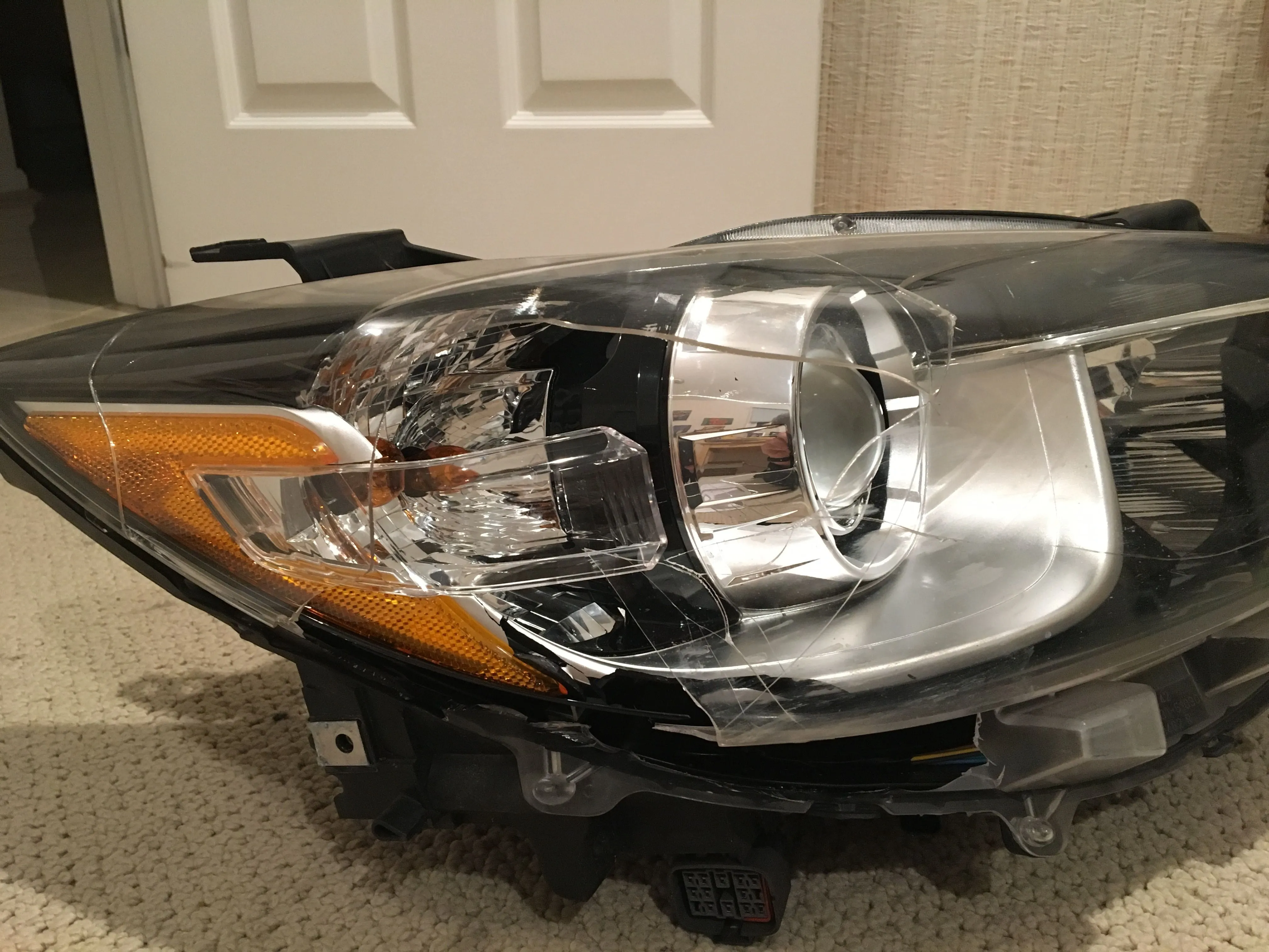

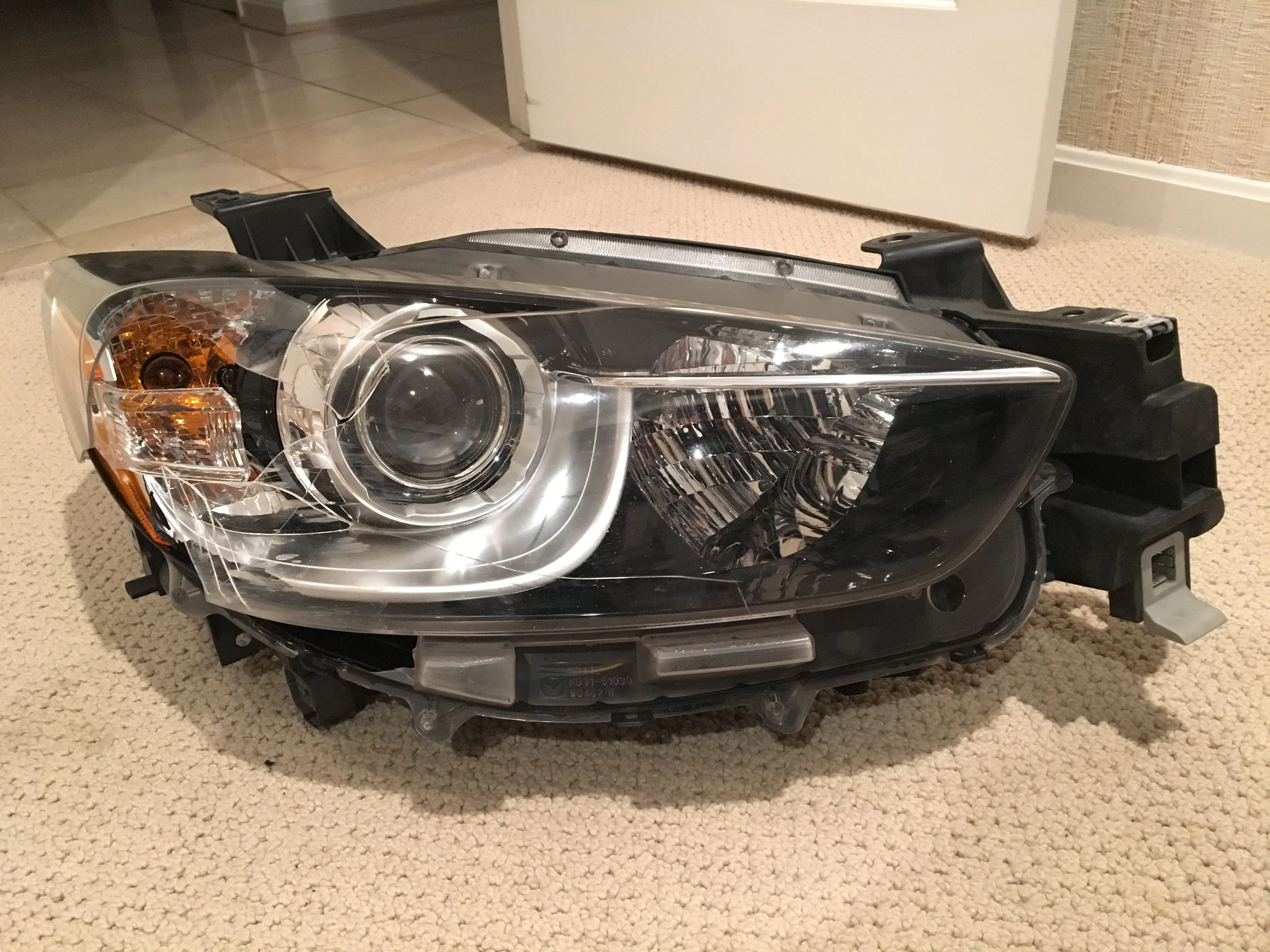

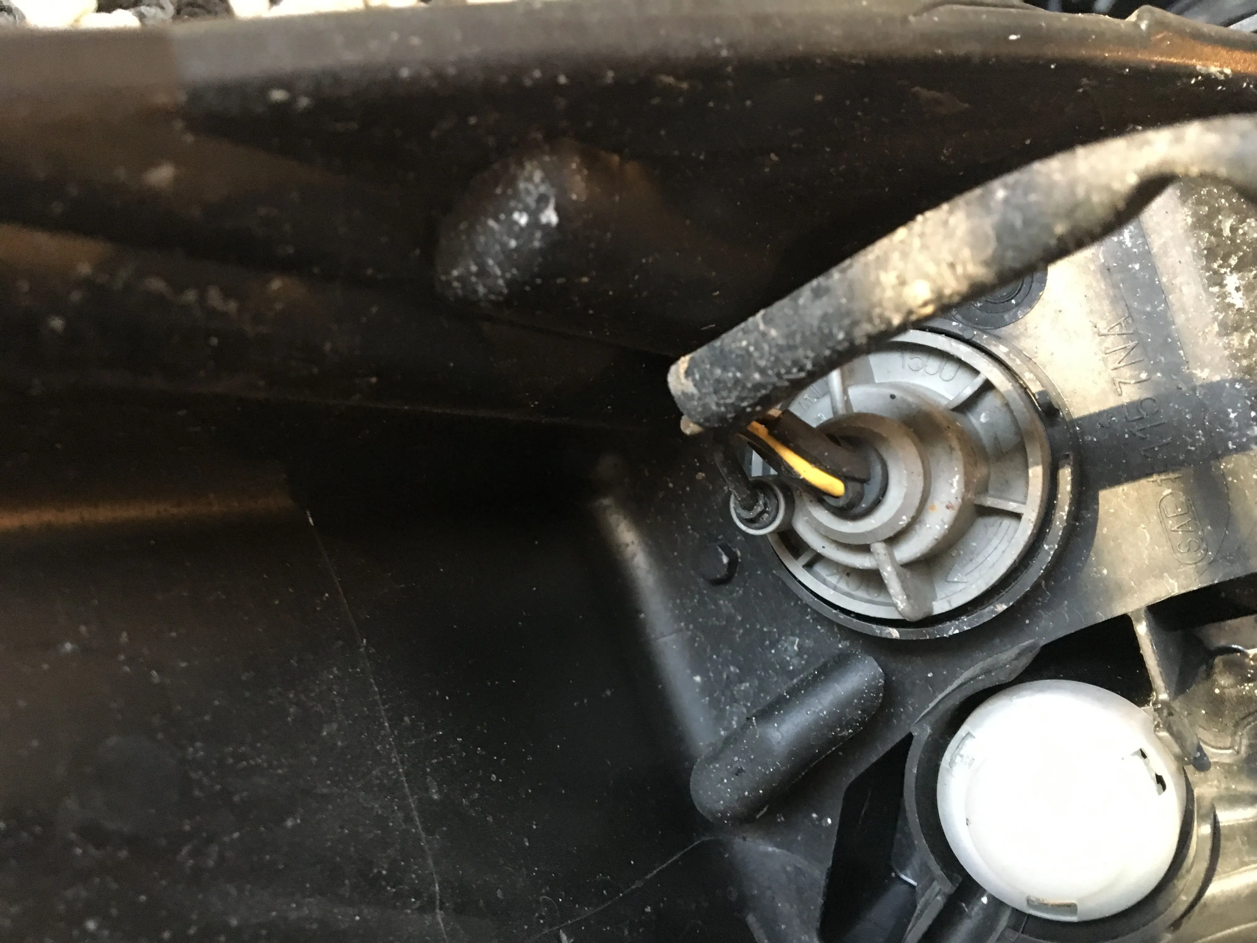

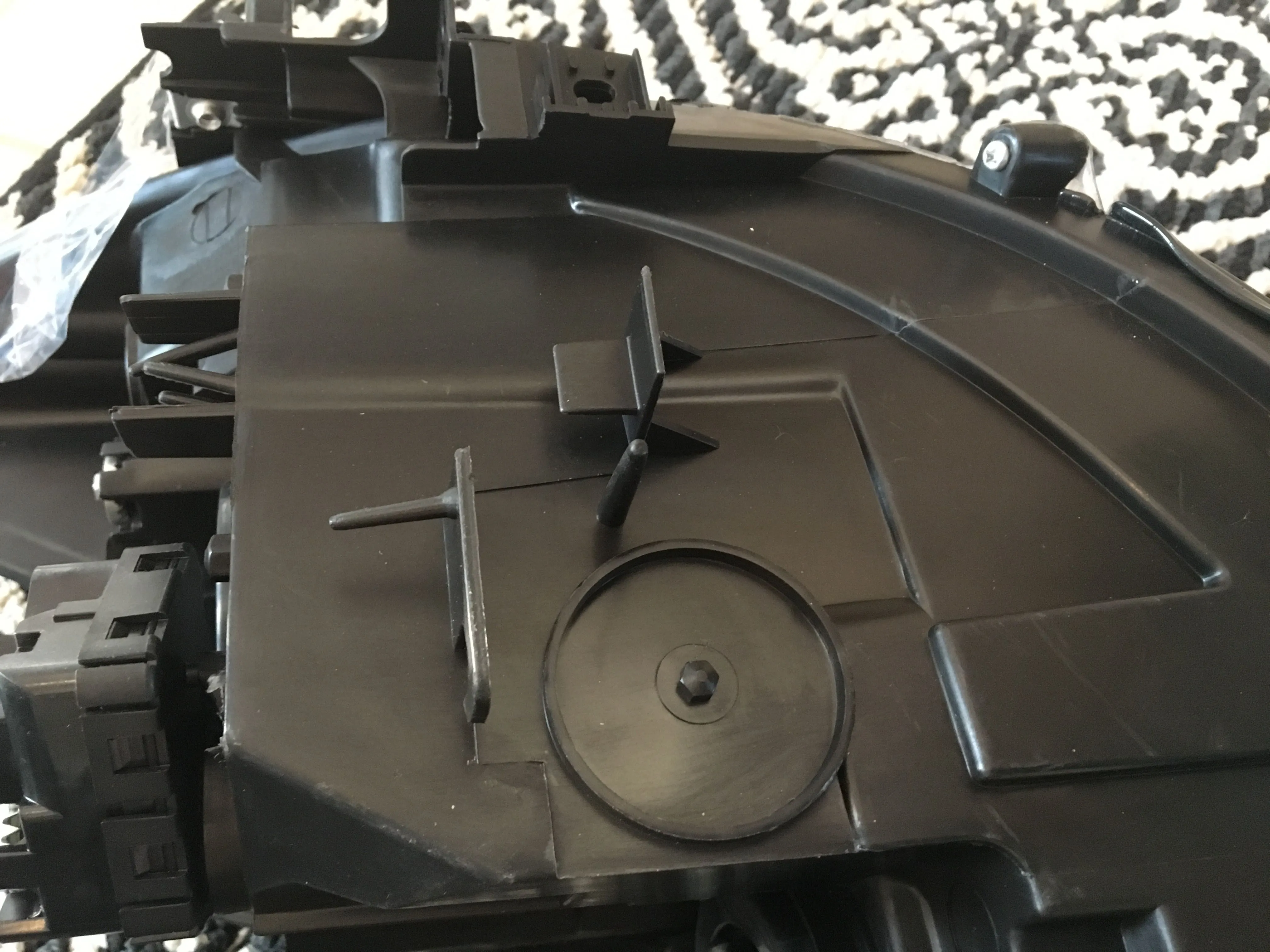

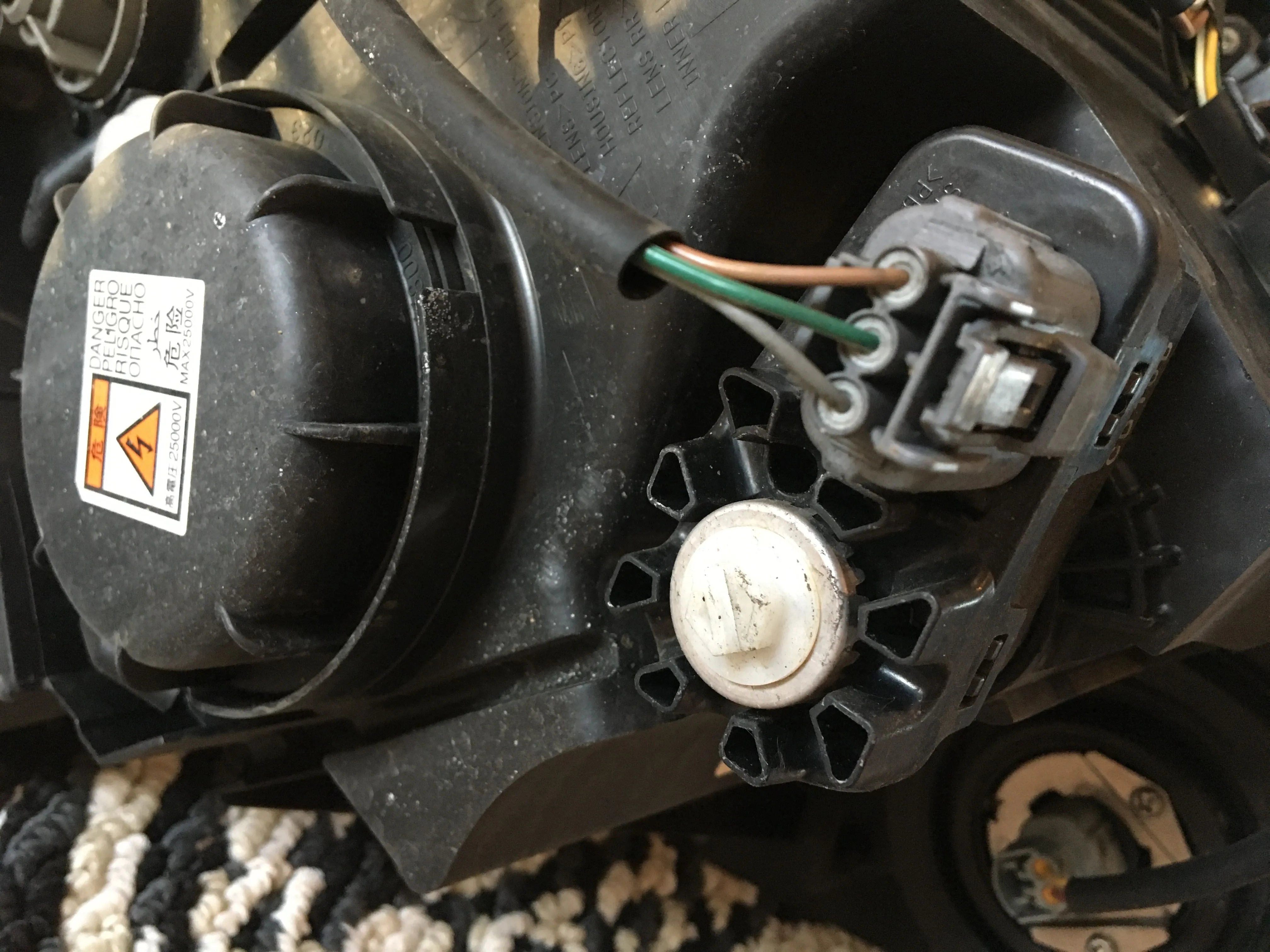

Hi all - my daughter hit the garage entrance and broke the right headlight and I decided to take on the challenge of replacing the headlight. I ordered an aftermarket replacement from ebay and received the headlight today. Comparing to the original one it looks a bit different (see photos attached). Can anyone give me guidance on the wiring harness swap. I see there are differences on the clips. I wonder if I need to order a different set of wiring for the aftermarket headlight or is the part I ordered not a match and I should return it. Much appreciate help on this one.

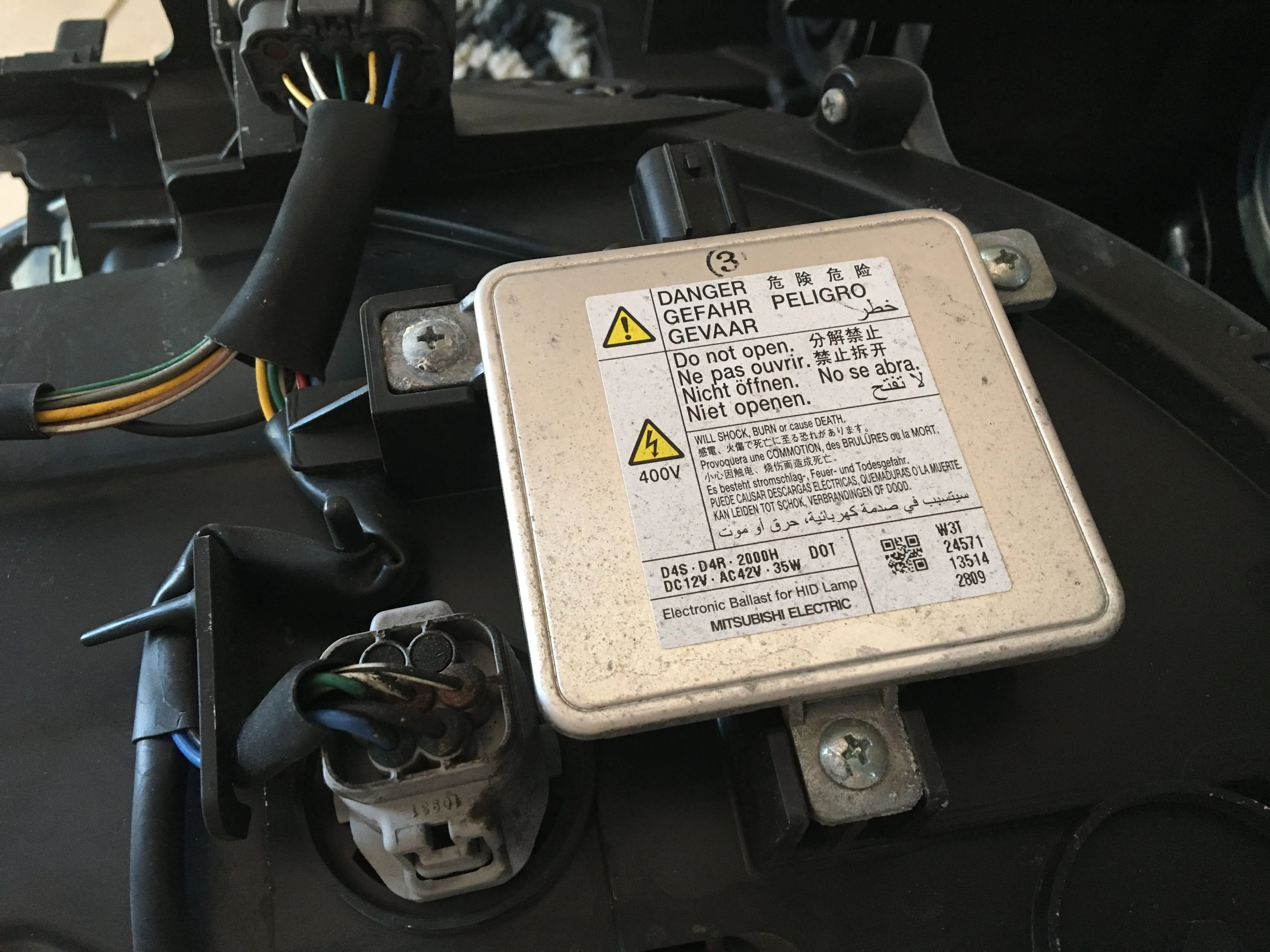

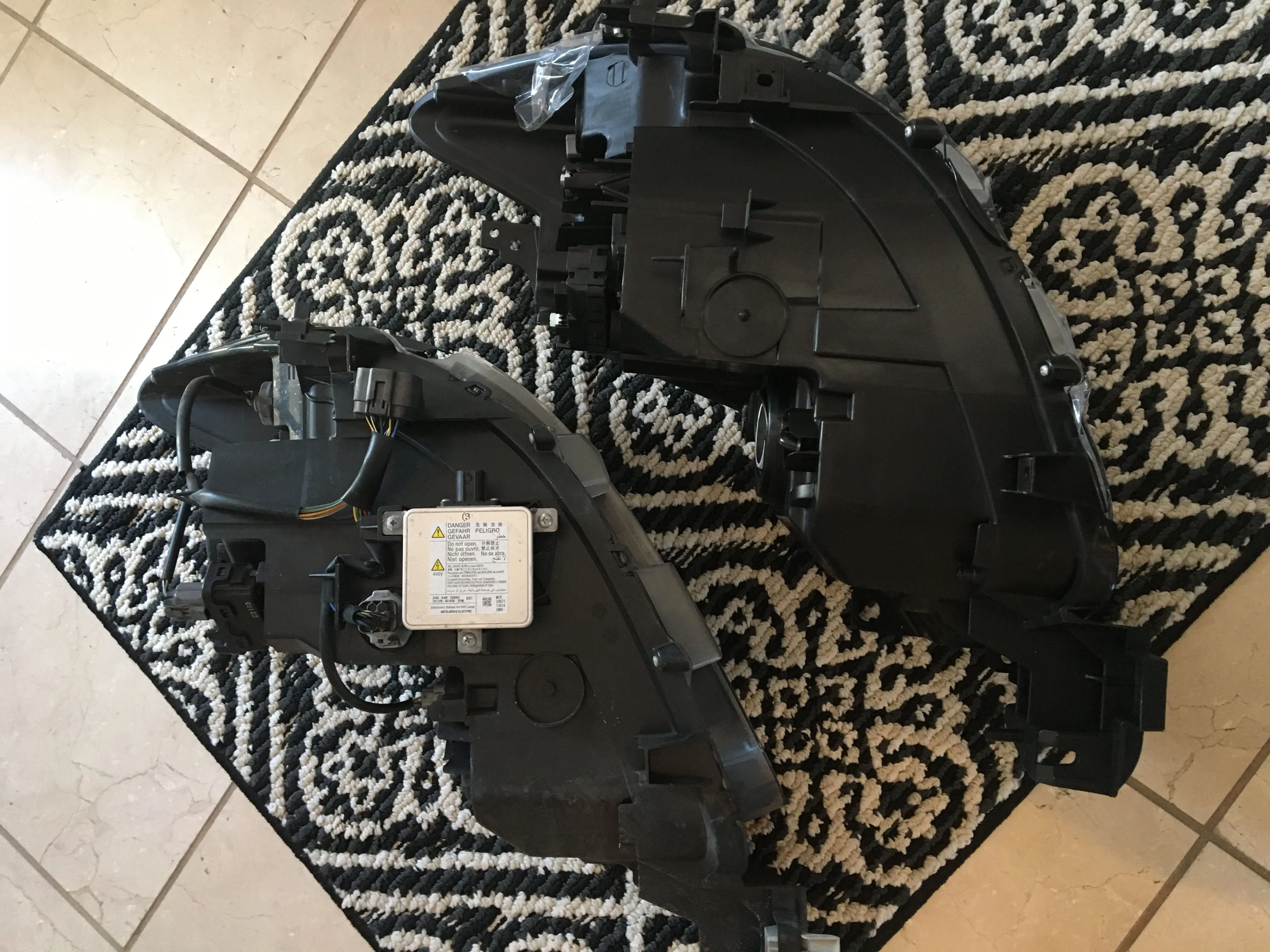

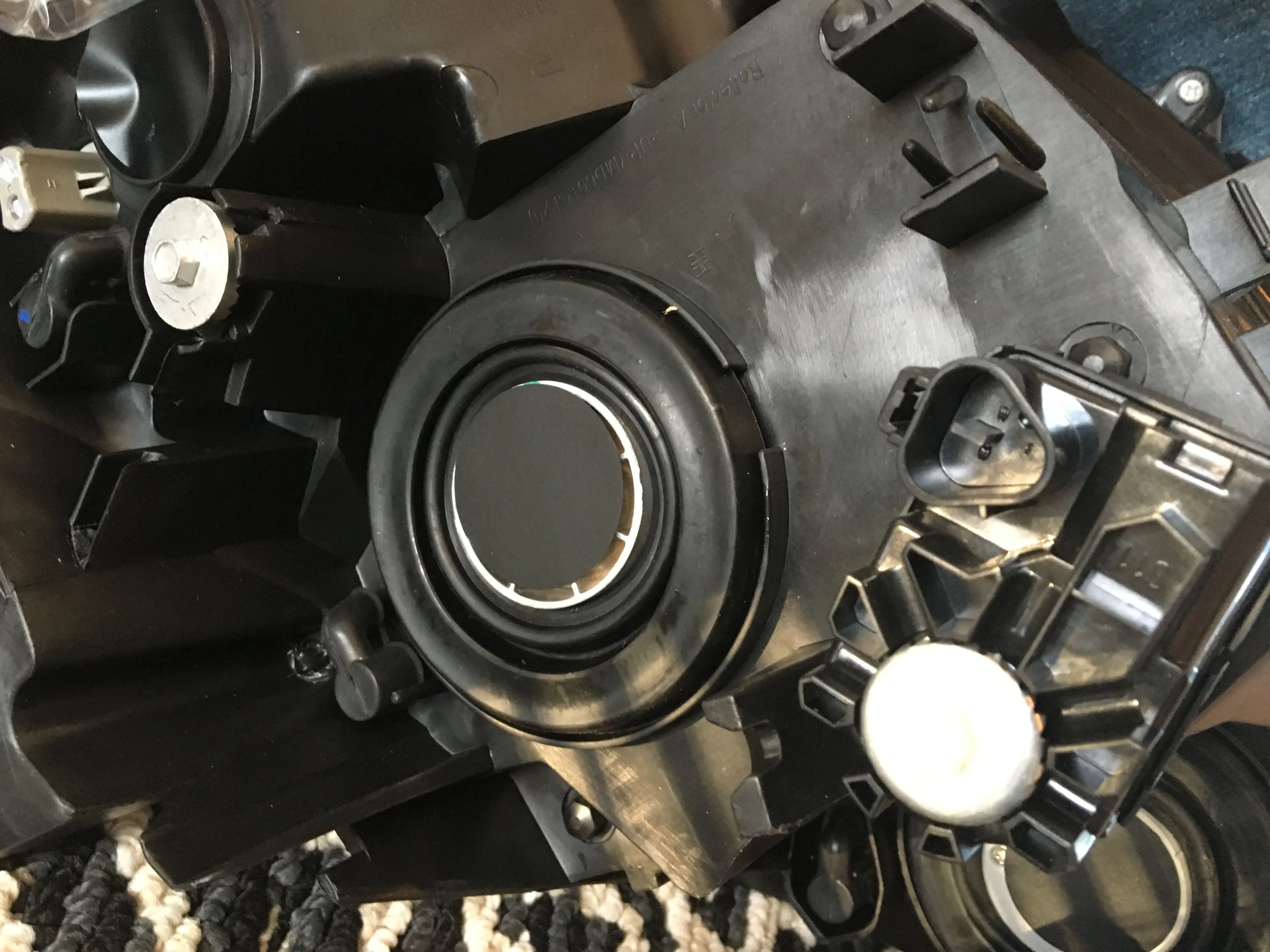

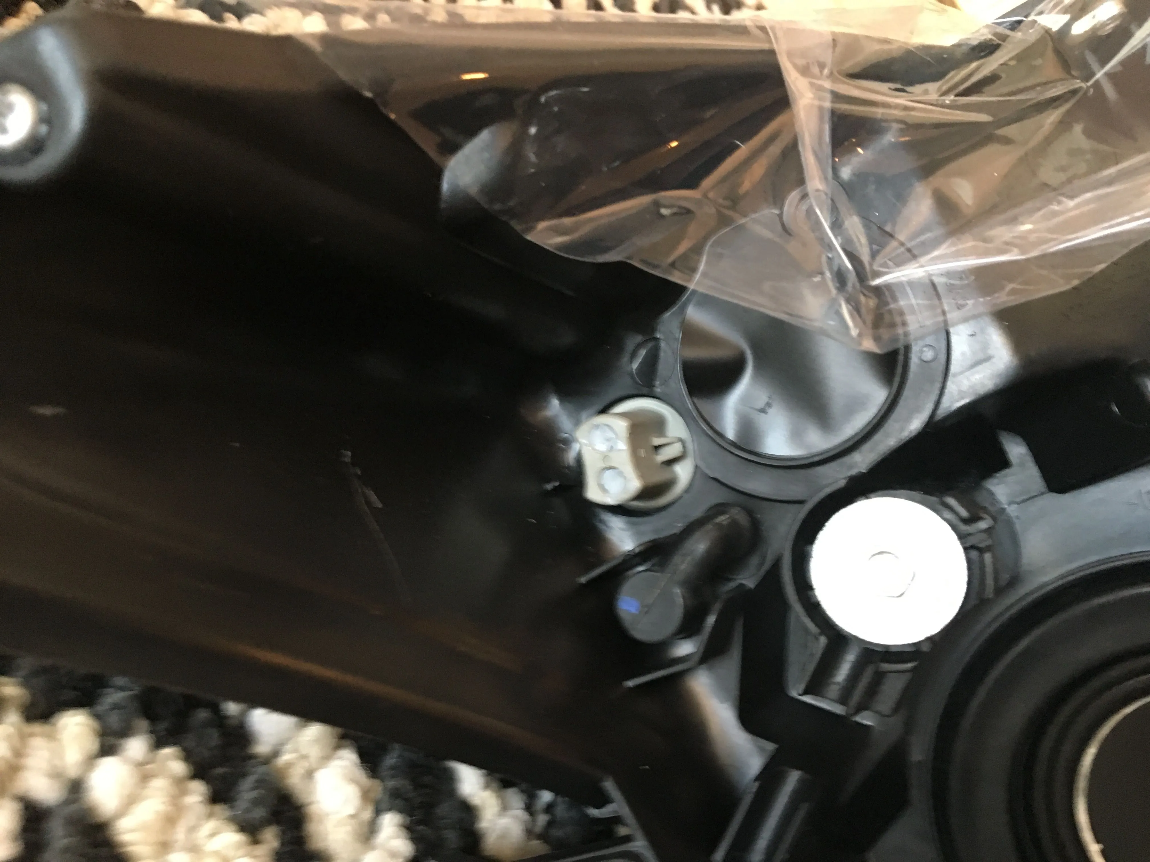

PS: You will see the atermarket part on the right side of Photo 1. Photo 2 shows an electric box on the original headlight, yet there is no place to screw this on the aftermarket part (Photo 3). Photo 4 shows a clip on the oriignal headlight that is rectangular shaped, yet the Socket on the aftermarket part is triangular (Photo 5).

can you take a picture of the actual front of the headlight showing the lens? I'm thinking based on what you posted, your daughter's car is a GT trim with the HIDs (since there is clearly a ballast) and the one you bought is probably not an HID replacement but just a halogen one. It's more expensive, and even more so since you probably can't return the one from Ebay, but you should go OEM on this. The OEM HID lights include auto leveling and also steer into turns so it's better to get the real thing as I'm not sure of any aftermarket lights featuring this.
Thanks for your reply, and yes, you are right. After posting this thread, I read about these online and I am pretty sure what I have is an HID on my Grand Touring. I will try to return what I got and go OEM. Do they not have any aftermarket HIDs out there? The cost of OEM is really high. Attached is the photo of the broken headlight assembly.

Yep, that's 100% HID. You can see how the projector has a gap between it and the surrounding silver trim. On the non-HID you can see how there isn't a gap and the silver surround is much thicker:
I'm not aware of any aftermarket HID housings, however you can look for used housings on Ebay, but they might have broken tabs or other issues. You can find some discount places online like Quirkparts but you'll still be looking at $750-850.

The reason why you can’t find aftermarket HID headlight is mainly because the cost issue. For your 2014 CX-5 GT with Tech Package it came with HID headlights with AFS (Adaptive Front-lighting System) which has motors turning the headlight projector left and right as well as up and down. That’s why it’s expensive in addition to more expensive xenon bulb and HID ballast.
Depending on your annal state safety inspection, you may consider to leave the cracked headlight as is. Or you can try to find a used one from LKQ or car-part.com but you want to make sure getting the correct HID version headlight with ballast attached. I wouldn’t get a new one unless money is no object to me.

It is not just a crack, a section has fallen off making it exposed to weather.
