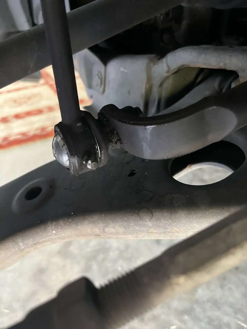

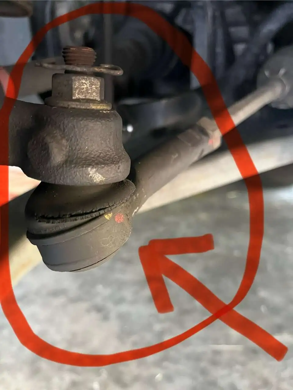

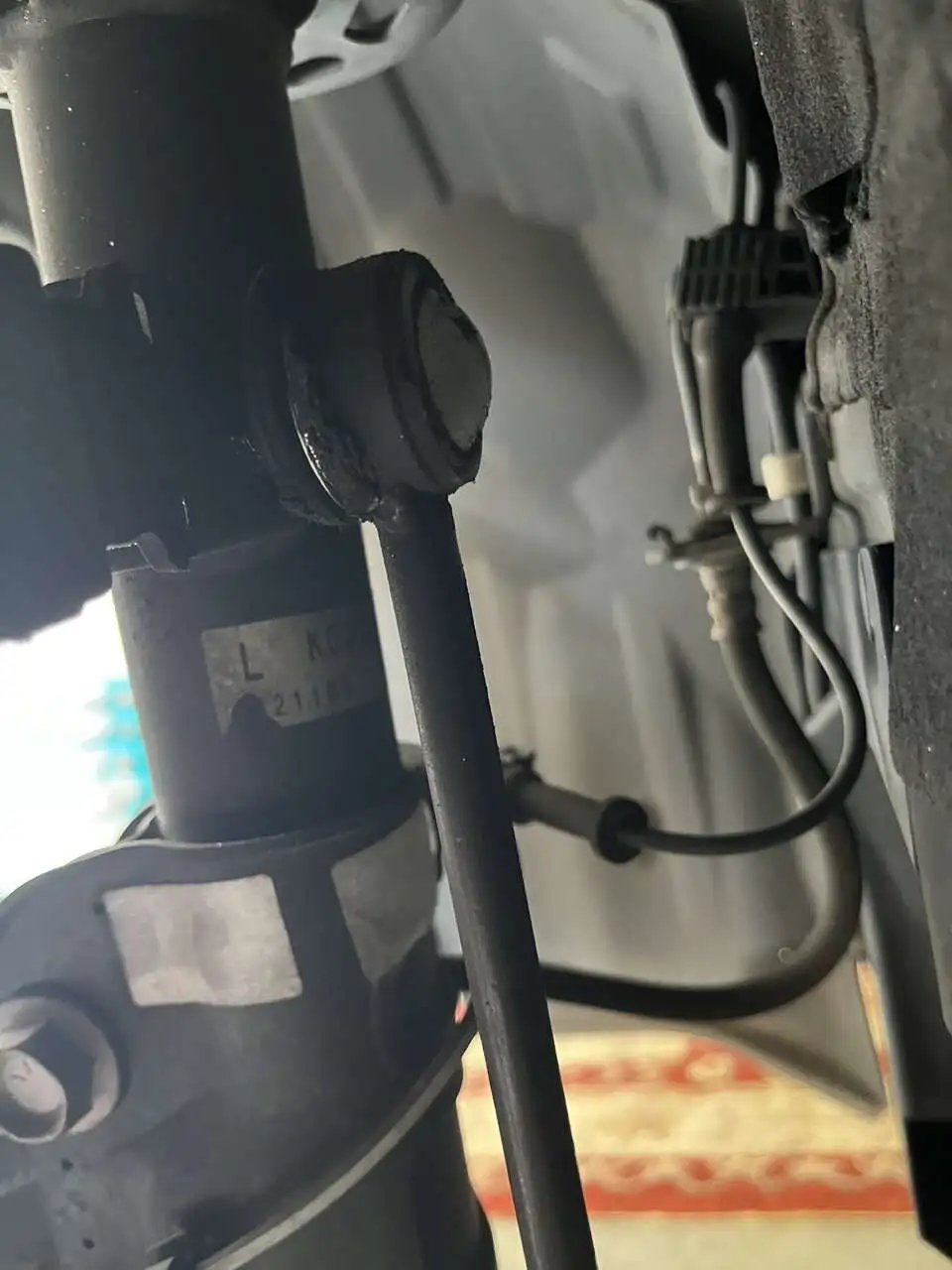

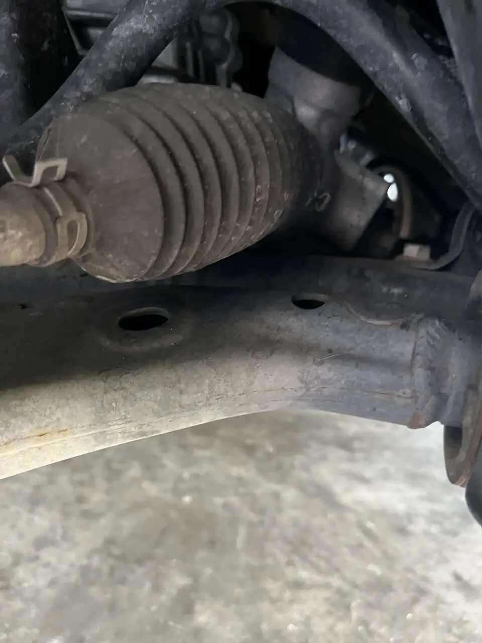

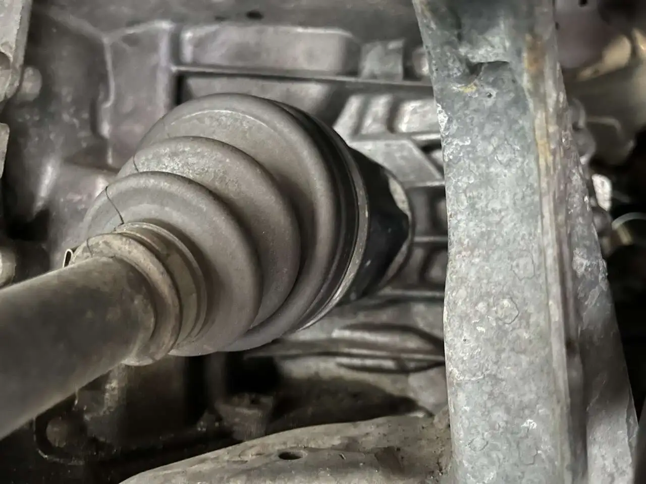

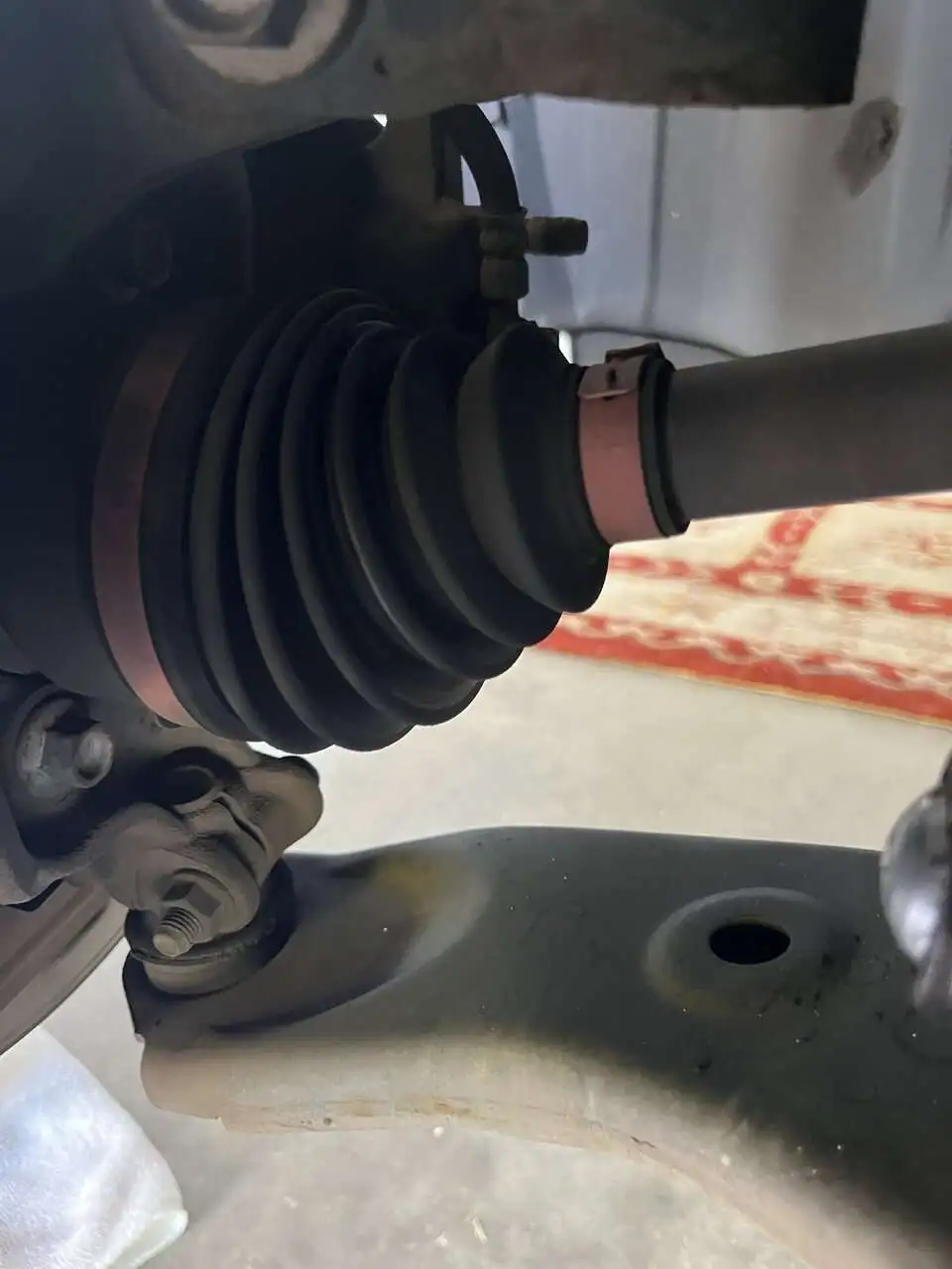

My 2013 CX5 has a periodic “single clunk” sound in the front driver side suspension that has been happening for a year but now is somewhat regular.
I have tried unsuccessfully to reproduce the “clunk” sound by turning the steering wheel, whenever hitting light bumps, accelerating, braking etc but I cannot reproduce it on demand although driving at lower speeds under 30-40 mph, it happens automagically.
Attached are some pictures I just took looking for anything obvious before attempting to repair it myself or being educated enough to direct a repair shop to the possible problem needing repaired.
Has anyone experienced something similar or do the pictures show you anything obvious? There are no leaks, the rubber parts are all still dry and flexible. I only saw one thing circled in red that looks a bit strange.
Thank you for any feedback you may have!
Kind regards, Brian

Is there any play in the steering? The rubber boot that you have circled in red looks damaged. What about the ones with the zerk? Do any o f them have play?

The failed boot is where I would start. Whether it fixes the clunk or not, the outer tie rod is failing. If it fails, breaks if may cause a crash.
It's easy to replace a tie rod end by loosing the bolt and a couple of whacks with a hammer and it poops off. Replace with a quality part, Mazda. Then get it an alignment. This part is even easier to replace than doing a brake job.
IF the clunk persists, disconnect one sway bar end link and drive around and listen for the clunk. It will not hurt anything or be dangerous. I would use a zip tie to move the link away from anything. Worn end links will clunk too. Also check to see if the end link is tight to spec. They will clunk sometimes when they wear a bit. This is another inexpensive part that fails from time to time.
