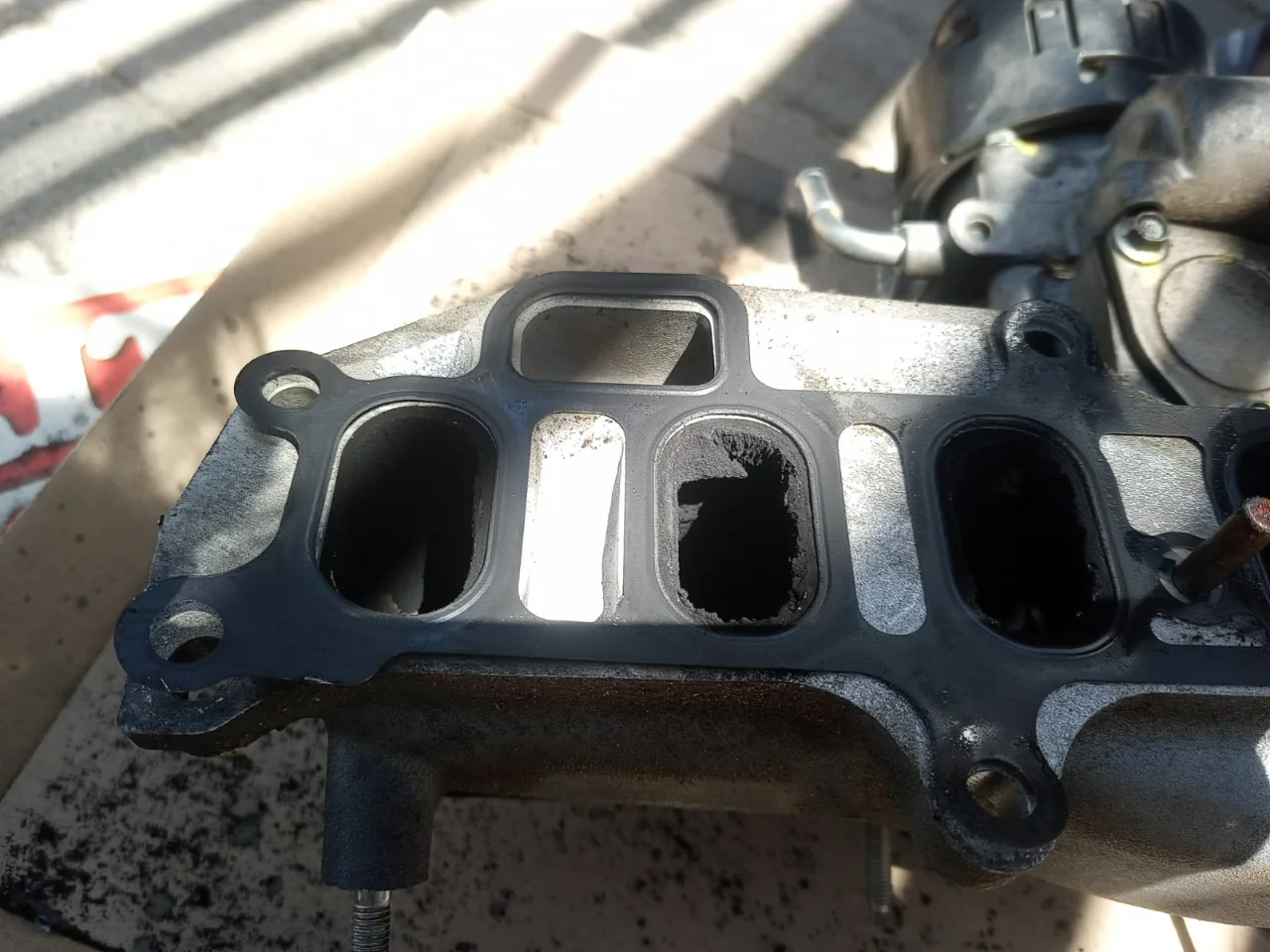

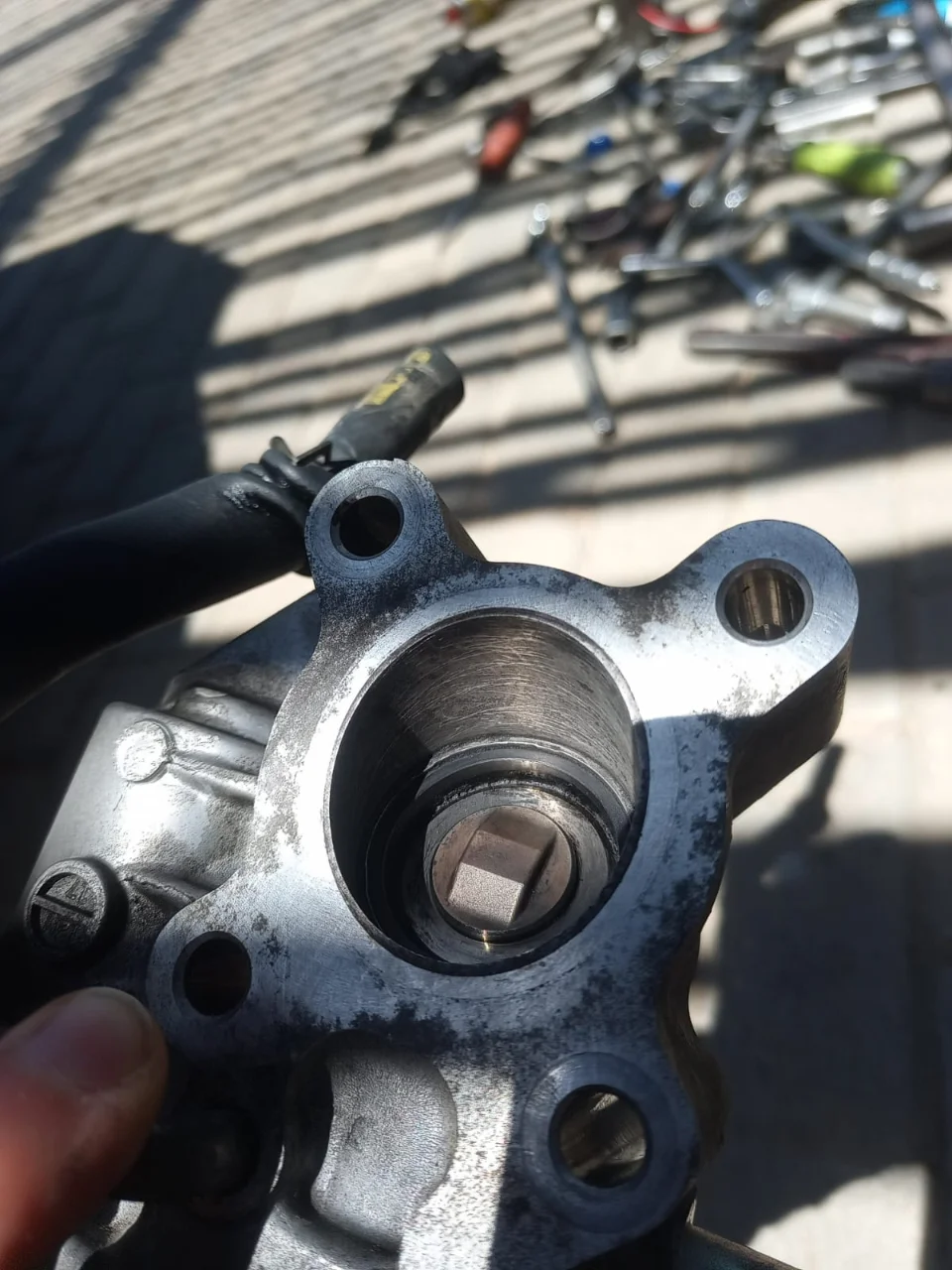

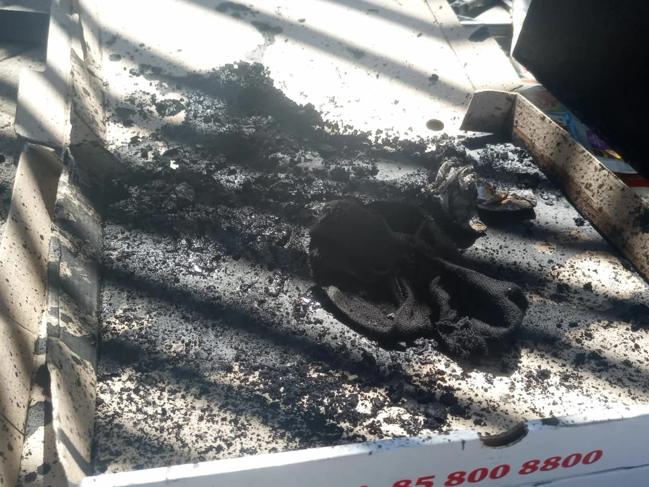

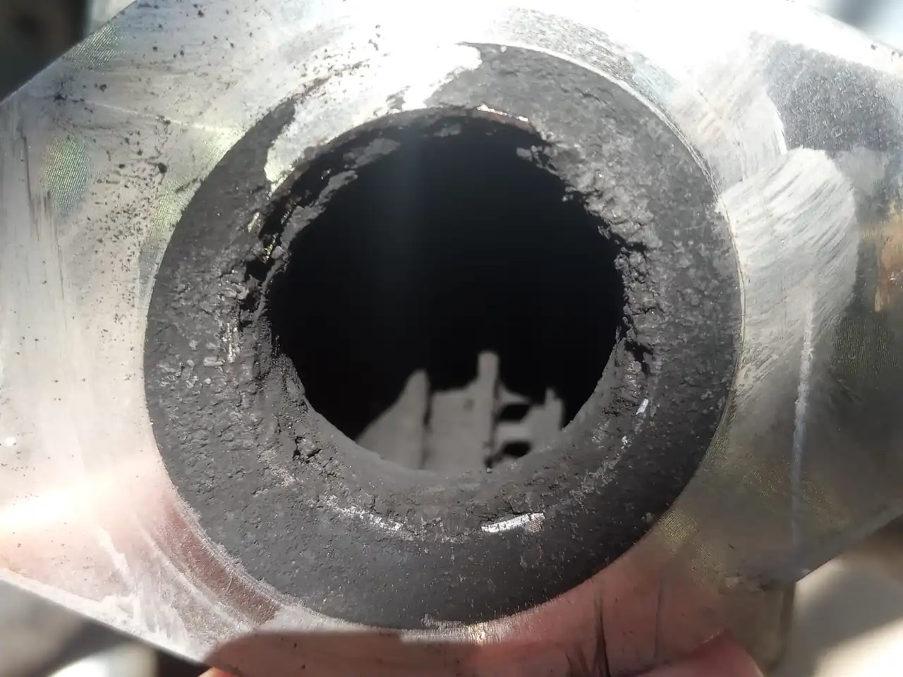

*********** PROBLEM SOLVED ! ************
- No more oscillating RPM bellow 2250RPM in neutral and while driving
- No more acceleration / deceleration or jerking of the car when I drive bellow 50 km/h, it's all smooth now
- No more blue smoke when I fully press on the accelerator pedal in neutral (I didn't mention before because I did the test just before changing the oil and it was massive blue smoke)
So I did :
- oil change, replace 10W40 by 5W30 synthetic
- oil filter
- fuel filter
- cleaned the exhaust manifold, EGR and intercooler... was really impressed by the amount of dirt that was in there, look at the pictures.
- I didn't do the injector cleaner yet, but the car already drive like a charm.
- Still need to reset oil data
Thanks all for the your thoughts and support

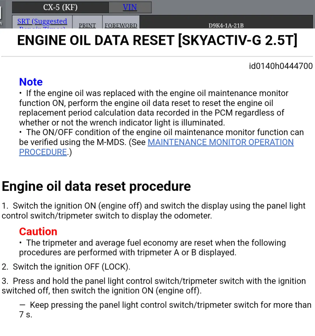

Im pretty sure the oil data reset is done as follows:
Without your foot on the brake (so the engine doesnt start, press and hold down the stalk in the instrument cluster (the one for resetting trips) and while holding it, press the start button twice so it puts the car into accessory mode. Keep holding the stalk down until the orange engine light flashes rapidly a few times. Done.
So I just ran across this and tried it. I got the orange triangle flashing a few times as described. But there is no indication as to what this actually does. Is this something that a Mazda dealership can read from the computer?

Another example, all that s*** in the pizza box in post #23. The EGR is routinely feeding that into the combustion process. You really want an oil formulated for diesel engines to handle that crud.
I had been taking these CX-5s in for service for years before I started doing my own oil changes. As far as I know (which could be wrong) they only reset it in the infotainment system.
My understanding, without getting too technical, is that the diesel engine’s PCM monitors oil quality (dilution) and quantity.
If you don't reset the oil data to tell it that you have changed the oil when you have, it will get to a point where the PCM believes the oil is no good anymore and will generate fault codes. It may also (and I cant be sure) affect how the engine operates as the pcm may compensate for what it believes to be old diluted oil.
I have no idea whether that also applies to petrol engine Mazdas. I will ask when I take the new Akera in for its next service. If I can talk to someone who actually knows what they are talking about, that is.
I always used to reset the 2.2D’s oil data myself using the trip meter stalk method when doing my own interim oil changes. So I never had fault codes.
My Mazda dealer’s “Service Advisor” (read trained monkey at the service desk) once tried to tell me it couldnt be done except by the Mazda scan tool. So I showed her the reset procedure in the owners manual….
My brother however also has a CX5 diesel, his is 2012 year, and a few weeks ago he had a check engine light come on - blinking which means do something quickly. Took it into his Mazda dealer the next day and they kinda almost admitted to forgetting to do the oil data reset at the last service. Reset done, fault code gone, car running fine now.
