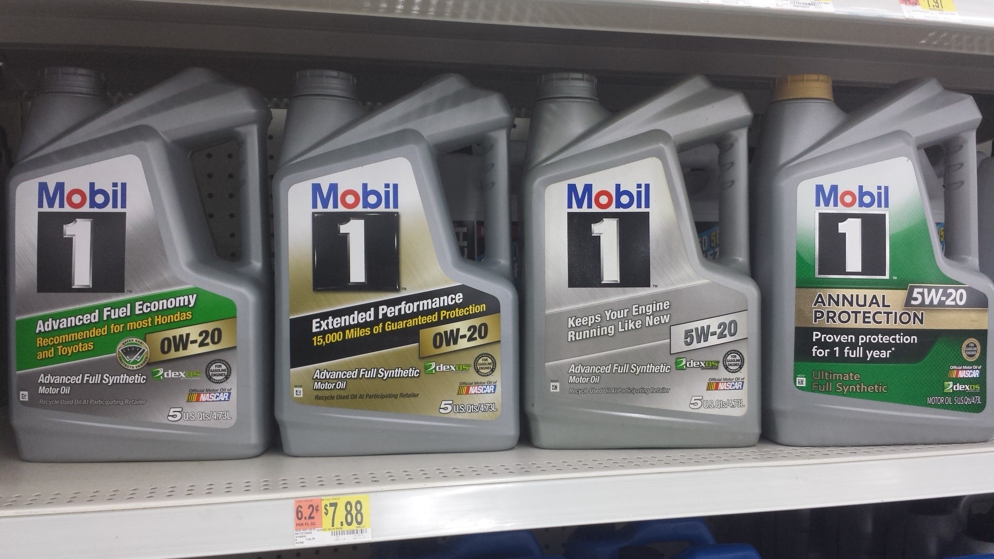

can anyone tell me what the difference is between these 4 mobile one synthetic oils and if there really is that much difference? thanks
Well, here is the good news. All four, in my opinion, are excellent products and will work great in your 5's 2.5L engine. Heck, assuming that the car spends all of its time in FL you can probably even run it on straight 20 or 30 grade all year long... but that has little to do with your post assuming you are picking between Mobil 1 products only. Sorry. :)
The way I see it, M1 markets these oils this way:
1) the "regular" M1 oil is just darn good quality full synthetic motor oil
2) Advanced Fuel Economy (AFE) is an opportunity for someone who is used to the "regular" 10w-XX/5w-XX M1 to get a little bit of fuel economy improvement during cold starts
3) Extended Performance (EP) is for someone who wants to extend oil change intervals to one year or 15k miles
4) Annual Protection (AP) is a new product... sort of an enhanced EP oil as it can be in service for one year/20k miles
I've used "regular" M1, M1 EP, M1 AFE, etc between my 5 and other cars I've serviced/owned. All have been fine to my knowledge. I think I got one or two used oil samples with M1 oil over the years and results were excellent in terms of wear, contamination, etc. In the end, it depends on how you drive and how often you intend to change oil. In my opinion, if you go with 5k or 7.5k mile OCI and don't do any towing, heavy load carrying, excessive idling, etc then you can run any of these motor oils without issues. Just a matter of getting the best price. If you want to extend intervals then you should probably look at the EP and AP varieties exclusively.
I do full-synth M1 every 5K because of heat, dust, all-city use. When I drain it, it looks dirty enough that I wouldn't push 7500.
