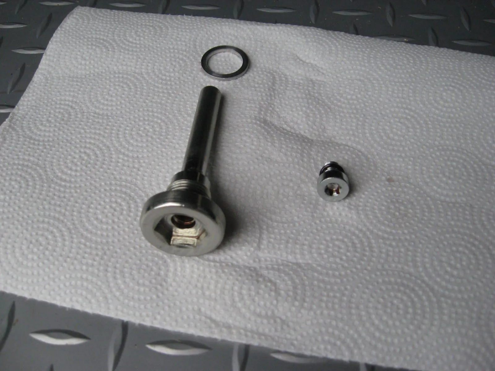

Only about 3.3 quarts comes out with this method. You check the method via a stand pipe that is part of the drain plug. I will take some photos when I do this again (plan for Labor Day weekend) and post them. Basically the drain plug has a 17mm internal hex. Inside this hex is another small drain plug for the stand pipe that is installed/removed via a Torx wrench. I will document the size when I do it. The fill plug is also Torx.

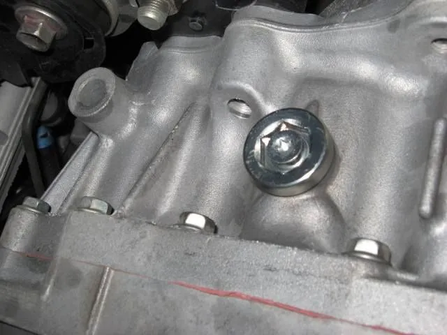

As promised here are some photos and a basic description of the process I used to change the automatic transmission fluid (ATF) in my 2012 CX-9 2WD Grand Touring. This transmission does not have a dipstick to check the level or add fluid. Disclaimer: I provide this as guide to assist other forum readers but I cannot and will not assume any responsibility for any issues you may encounter. The final responsibility always rests with you, the vehicle owner.
To begin this process I park the vehicle on a level surface and remove the air filter box. To do so you must disconnect the mass air flow sensor (MAF) connector and the plastic clamp holding the wire harness to the box. The box is held in place to three hex head capscrews near the cold air entry point and the clamp that secures it to the air inlet assembly. The box then pulls straight up from two rubber dampener grommets (first photo surrounded by red) on the bottom. This will reveal the fill plug which is a T55 Torx fitting. This plug was very tight from the factory.

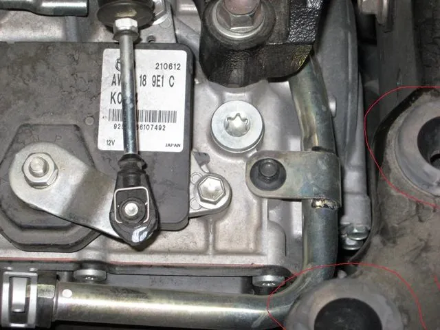

Next, go underneath the vehicle and find the drain & level adjustment plugs. They are shown in the next photo. Remove the level adjustment plug with a T40 Torx bit and let the fluid drain. When there is only a small amount of fluid dripping from it, remove the drain plug with a 17mm hex bit. The next photo shows what the plug assembly looks like when it is out of the vehicle. The crush washer is Mazda part number AW01-19-738 and the o-ring is BT24-19-852. There are many similar crush washers out there from Toyota, Honda, etc. About 3.3 US quarts came out of mine.
When the ATF has all drained it is time to reverse the order. Install the drain plug with a new crush washer and torque to 24-54 N-m. I use the nominal of 39. Install the level adjustment plug with a new o-ring. Tightening torque is 53-77 inch-pounds (65 nominal). Now it is time to add the appropriate new ATF. I used Mazda ATF T-IV / JWS3309 (0000-77-114E-01). The amount to add is just a little more than came out, assuming there have been no leaks. In my case, this was 3.4-3.5 US quarts. Reinstall the fill plug with a new o-ring (AW01-19-476). Tightening torque is the same as the drain plug at 24-54 N-m. Reinstall the air box assembly.
Now you must get the transmission fluid temperature to between 37 and 47 degrees Celsius. If you do this when it is hot outside (I live in Houston Texas) it will not take more than a couple of back and forth drives in a long driveway or short block.
You then, once again, park the vehicle on a level surface with the engine running and remove the level adjustment plug. The fluid will then run out until it is level with the top of the tube that is part of the drain plug. Reinstall the level adjustment plug and you are done. Make sure the ATF temperature stays between 37 and 47 degrees Celsius when doing the level adjustment and the engine is running.

Remove Air Box Etc to expose Fill Plug.
Remove Fill Plug
Remove Level Plug to drain any overage.
Remove Drain Plug to drain the available fluid (3-3.5qts)
Replace Drain Plug
Replace Level Plug
attachment.php
attachment.php
attachment.php
Hope this gives you an idea of the process.
