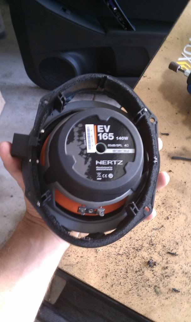

Metraonline.com said that i had 6.5" speakers front and rear... and of coarse they are 6x8"
but i already bought them so i figured i would make it work...

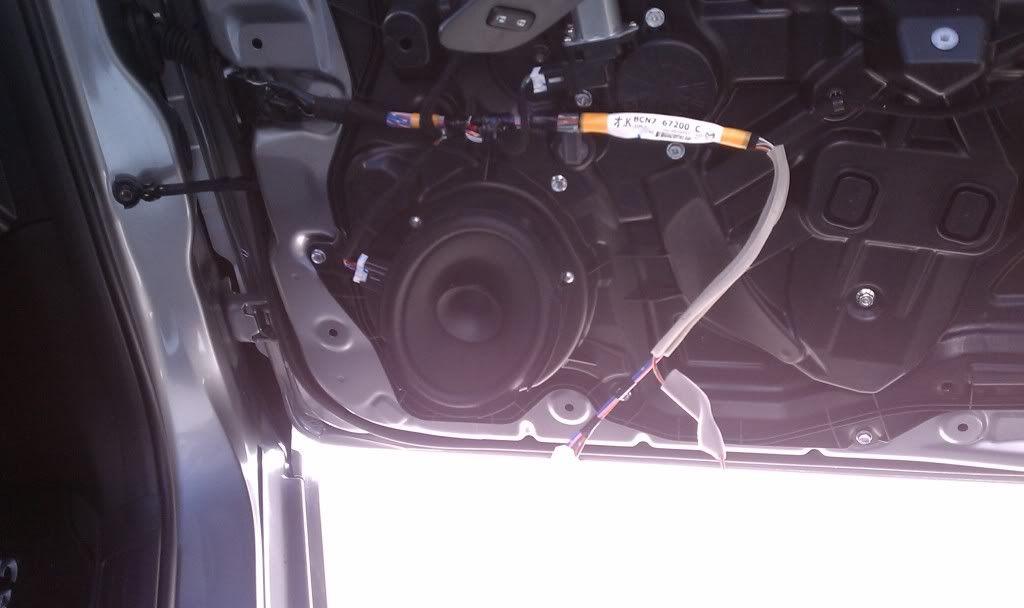

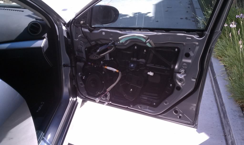

Here is the front door with the panel off.

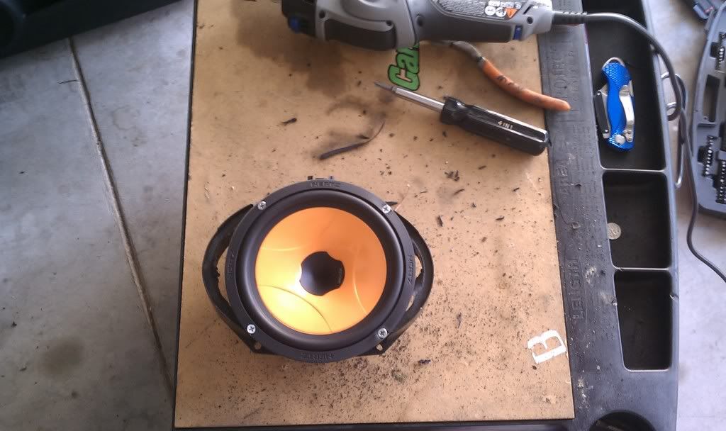

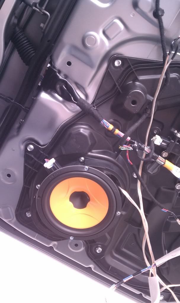

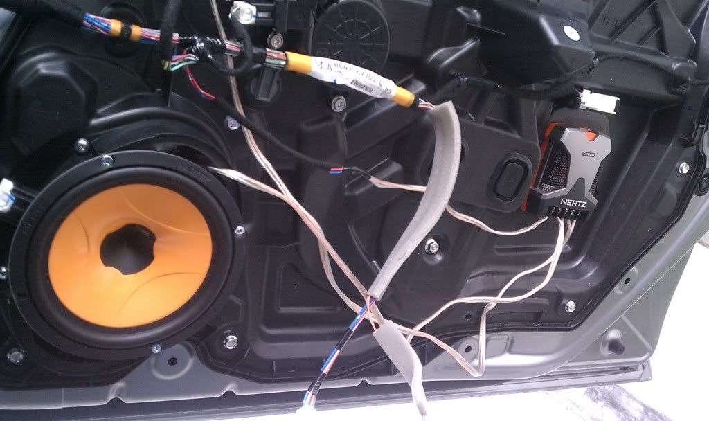

Used a dremel to cut out the stock speaker and make my new ones fit!
Speaker and Crossover installed

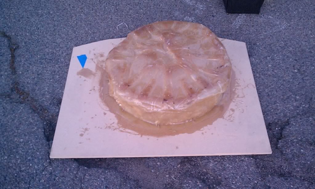

Now for the sub box

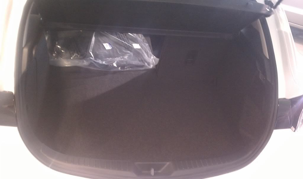

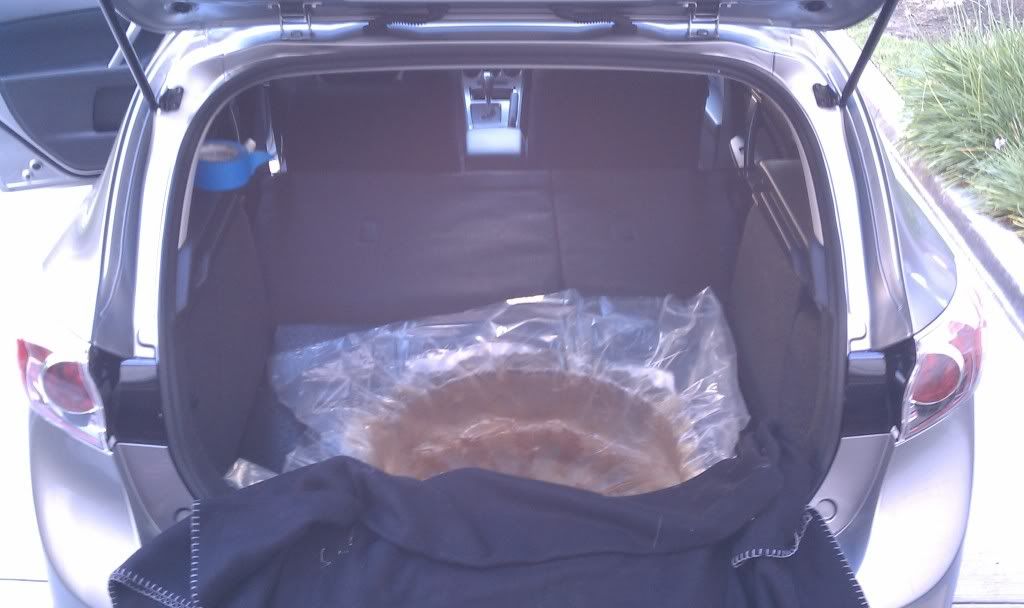

I pulled out the spare tire and junk but left foam there.

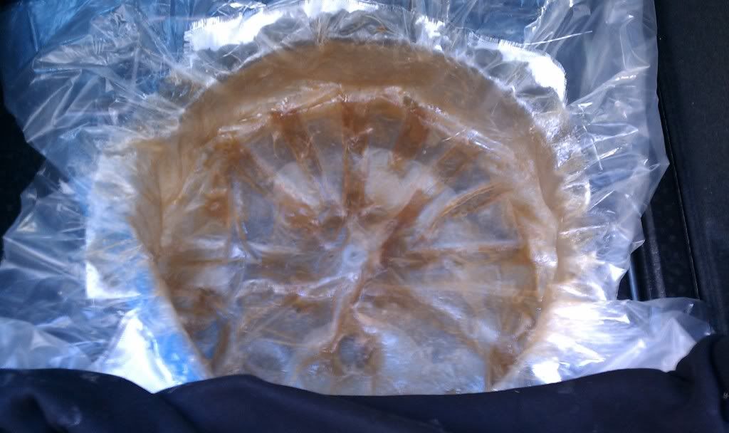

Laid down some plastic, then some fiberglass and resin. repeat till its 3-4 layers thick.
This is still very thin..
Let it dry.. which takes hours! then take it out trim it and glass it to the wood.

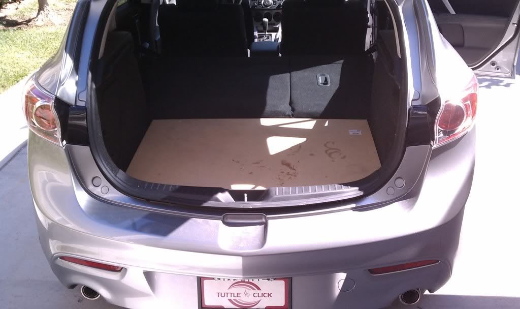

Let dry and test fit! Perfect!
Next.. route out a circle for the sub and drop it in! Looks like i have about 6.5" mounting depth for a sub..
Now for the sub box
