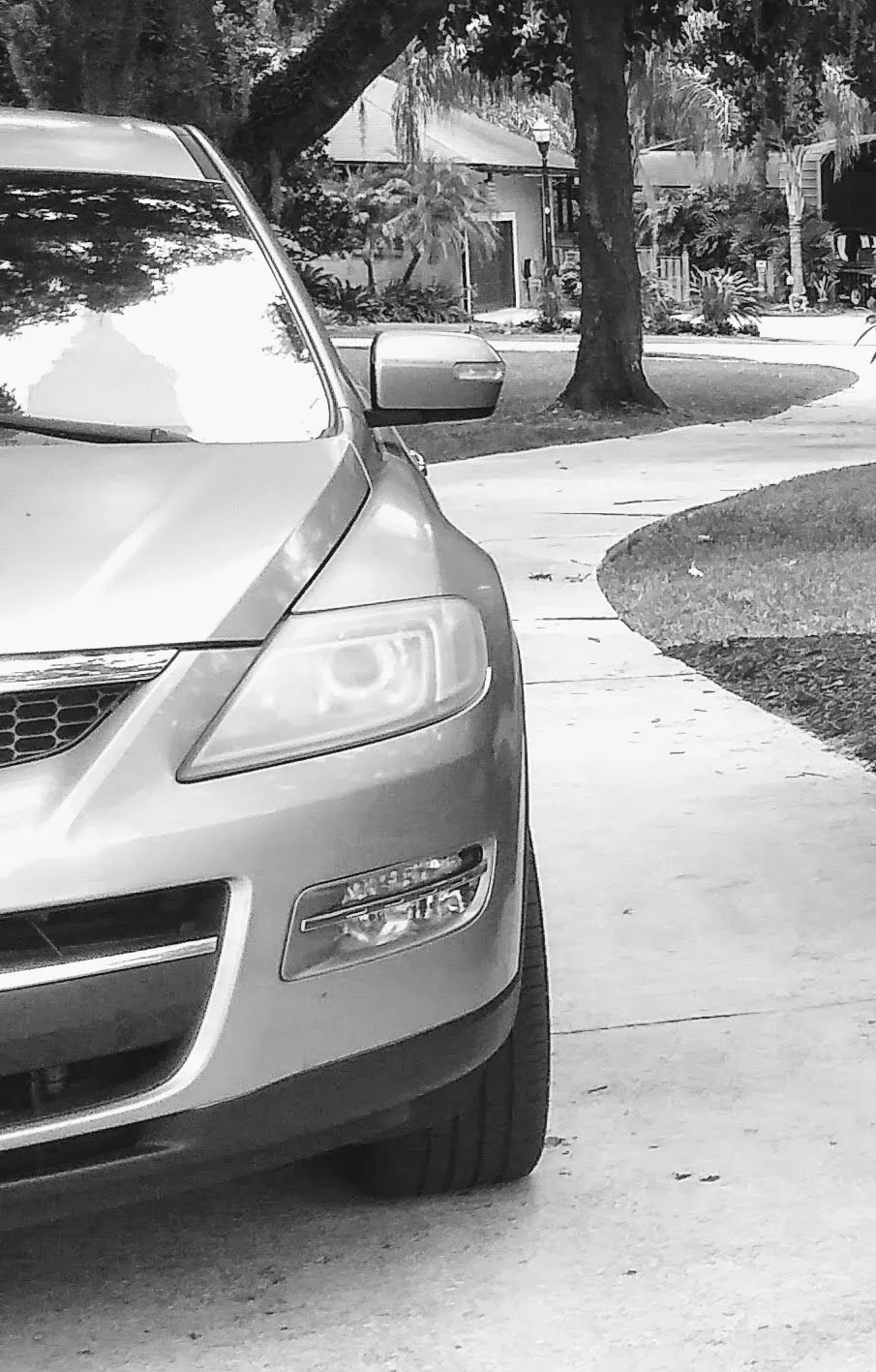

Excited about approaching this milestone. I'm less than two thousand miles away from hitting the mark to join this club.
-Miguel
Jacksonville, Fla.

Please include if transfer case is serviced and waterpump was replaced. Great to hear high mileage Gen 1s, its always issues with PTU and waterpumps that is all over the internet.
Hi, this vehicle is 2WD and does not have a transfer case. It is still fine working with the original waterpump. Hope that helps you.
Great to hear, Miguel! Hope it keeps you on the road for another 200k :)
What items did you replace outside of spark plugs, brake pads, rotors, filters, oil (motor & trans) and coolant?
I’m due to hit the 200k mile club shortly as well! I have a 2010 GT AWD and have been changing the transfer case fluid with every oil change. It’s a pain in the rear but it’s still hanging in there. The water pump is still working as well. I frequently check the temperature gauge and check the oil to make sure it’s not turning into a milkshake.
