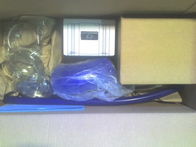

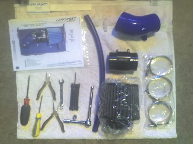

Received the box on Monday and had to wait until Wednesday to do the install. The parts are nicely packaged in the shipping carton - and the instructions (same as what's in the PDF on CorkSport's site) are well written and easy to follow.
Here are a few pics of the process-
Freshly opened box with instructions removed:
Parts and tools laid out(I didn't have a 10mm long socket - go buy one!):

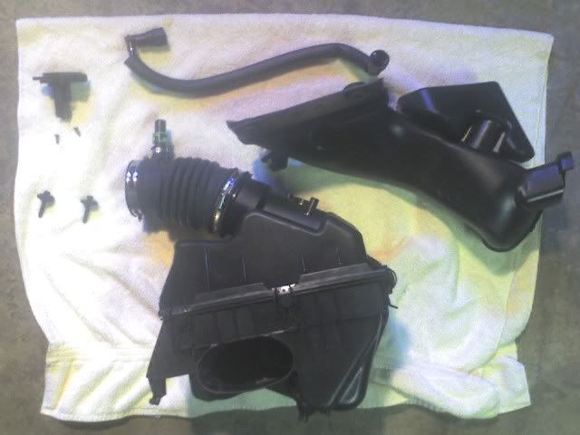

The stock setup:

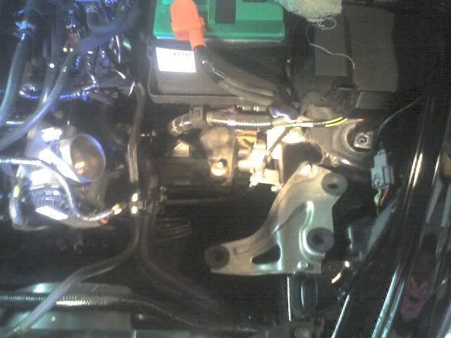

All gone:
The removed parts:

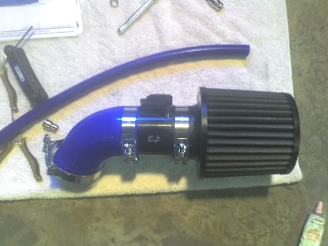

Assembled RAI ready to go in:

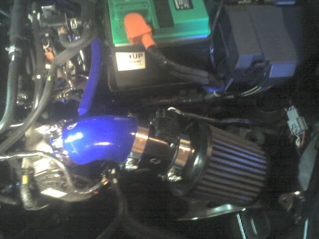

Done and done:
Install took less than an hour, and I'm not really much of a mechanic - except on bicycles :-) (could be done in less than half an hour, but I'm kinda OCD and like to have everything in order).
Looks great and things seem really well made. Have not gotten to drive it much yet, so I can't say much about the performance aspect (later) but it does seem to pull better and feels torquier(is that really a word?). Has a nice sound when you get on the gas, too!
All in all - i'm excited to get some miles on it and see what sort of difference it makes.
