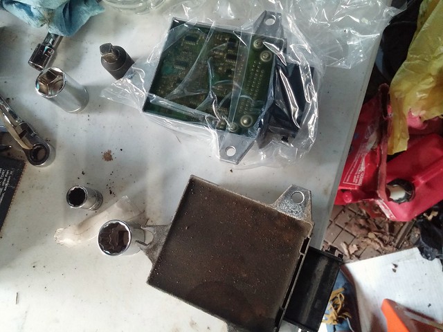

Ugh, I'm so sorry, but I definitely threw mine away when I got my new part. There is the website mazda-tcm.com that specifically calls out the problem at hand. What I can do though is post photos of the old and new TCMs side by side. You'll see on the old one that there is a thick coat of dirt/potential corroded electronics covering the bottom side.
Transmission Control Module by Monk Ratava, on Flickr
Transmission Control Module old v new by Monk Ratava, on Flickr
Thanks for positing the pics and pointing out mazda-tcm.com. The TCM module looks like a board housed inside a heat sink with anti-vibration/weather seal coating. Do you have another close-up pic without glare/reflection? Now I'm even more sure these failures are likely due to some common things like loose joints or bad capacitor, likely due to heat, since mazda-tcm.com provides the service to recondition your old one with "high-quality electronic components only and a special compound to fill MAZDA TCM".
