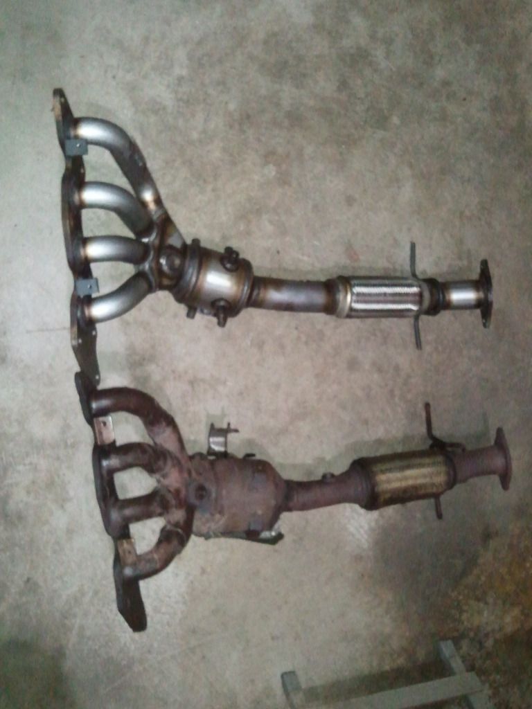

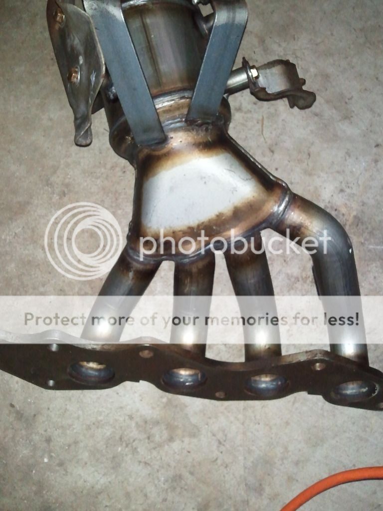

Okay. Here are some pics comparing the two. I moved the braiding to keep the flex pipe together for the OEM one for my measurement/photo purposes. These show them from the top:
This shows the Pacesetter from the bottom. It has a smaller collection area, and a notably smaller cat. And it looks to be stainless, but it has the same magnetic properties of the OEM one, so I am guessing it is probably 409 stainless and not 304. The brackets and such that are welded on do look like they will accept the OEM heat shields with minor tweaking of the shields. They are pretty thin, so they are forgiving. I test fit a couple of them today, but there are some hardware discrepancies. If you order the Pacesetter, you will want to have a handful of extra M6 x 1.0 metric bolts that are 10mm long as there are no studs on the Pacesetter unit to take the factory hardware, if in fact yours are still any good. Mine were so rusty I was worried I would break them off, but they did come off with a little heat and PB blaster:

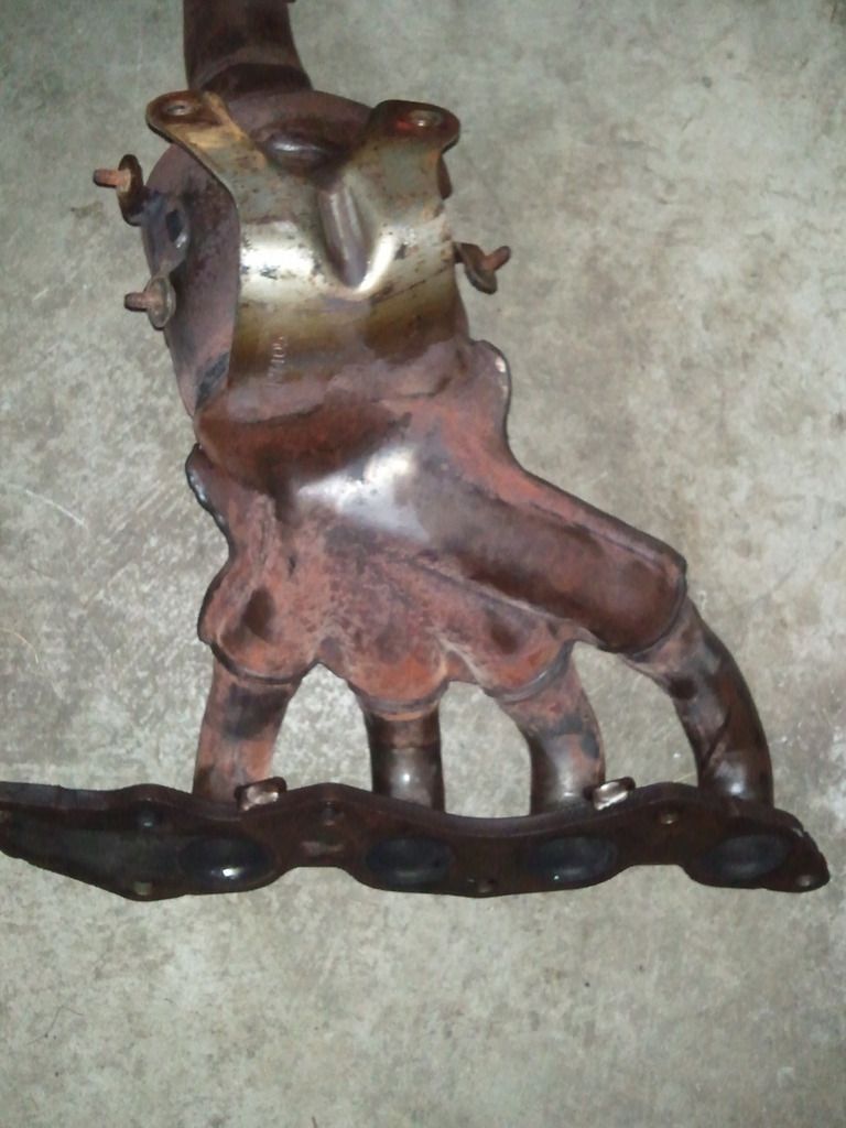

Bottom of OEM:

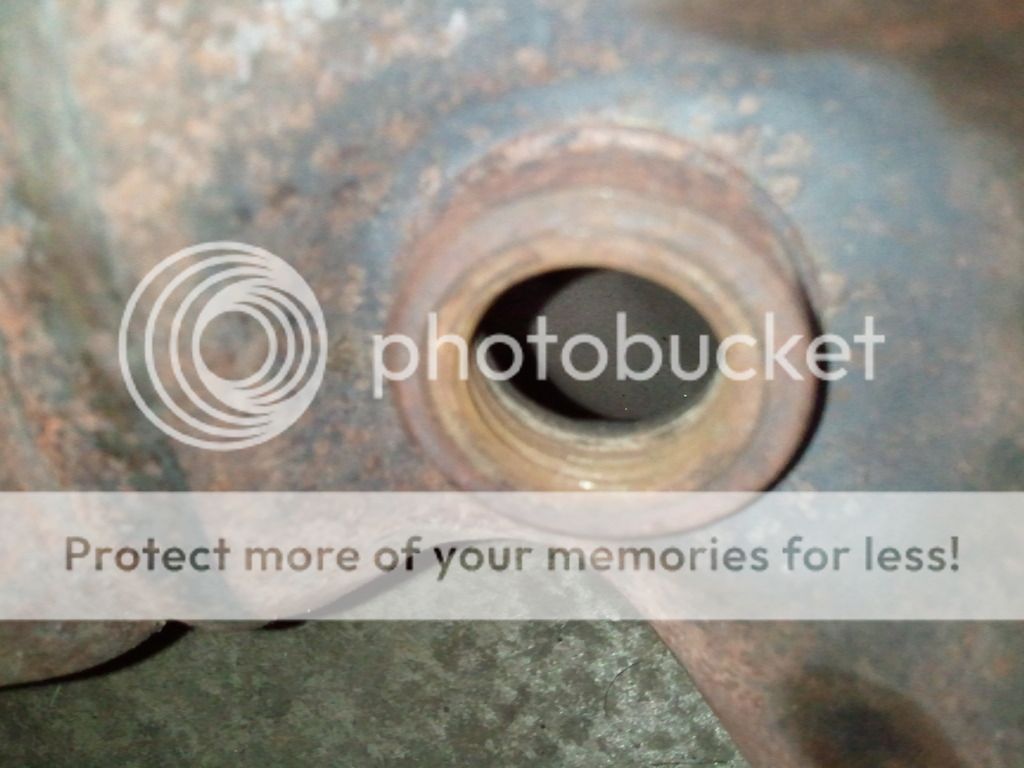

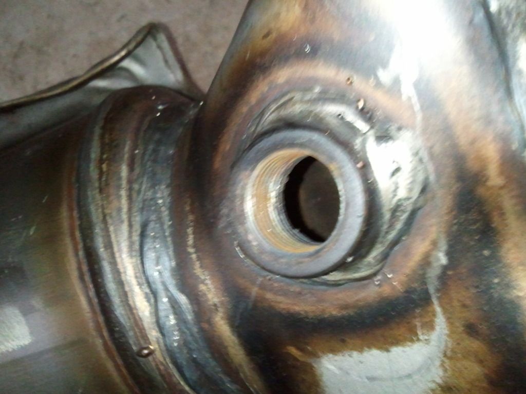

OEM bung for bank 1 O2 sensor:

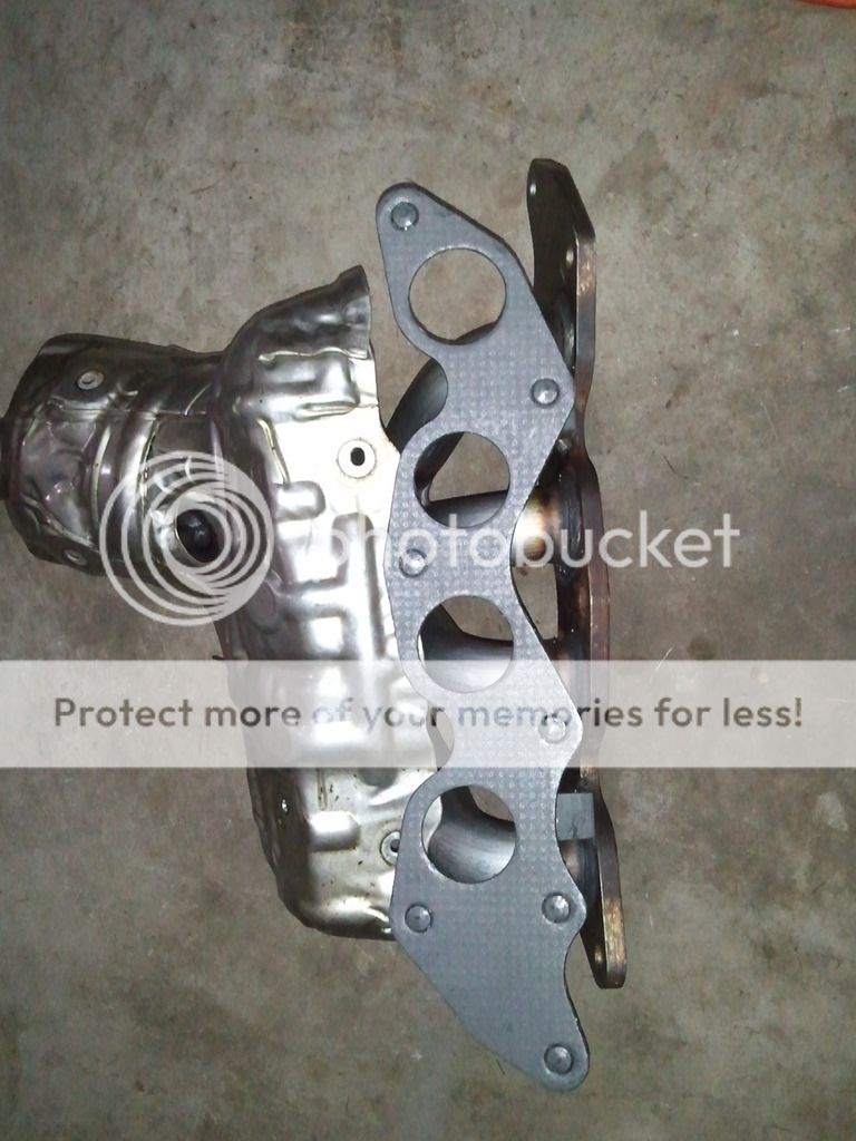

Pacesetter bung for bank 1 O2 sensor:
Pacesetter manifold gasket:

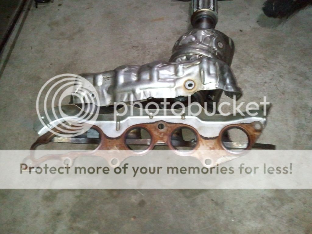

OEM manifold gasket; I kinda like the way the OEM one has shielding on it's upper edge to help protect the plastic valve cover:
There you have it... I would like to cut just behind where the bank 2 O2 sensor goes and weld the flange there on both of them. I have to say the Pacesetter one seems better in that section because it doesn't use a kink type bend there, and it is a full 2.25 inches, as opposed to the 2.125 inches on the OEM one. The company that makes the flanges I ordered only has them in 2.25 inches, so I will have to build up that area a little bit with metal when I weld it. I wanted to get the Walker part before I make any cuts though, just to be sure the length will come out right for the standard replacement part. I am wondering if I could have just ordered the catalytic converter/exhaust manifold assembly for a Ford Fusion to begin with. I notice they have a really short exhaust manifold and a much longer cat though.

That front bung doesn't look too deep to cause an issue. I thought it was the rear bung that was longer but after rereading I realize you said front. I would definitely get an oem style gasket for it. I've had bad experiences with that type of exhaust gasket leaking. Answer to above question, yes the EGR sources from cylinder 4 through a port in the head that leads to EGR valve. Gases are introduce through a second port on intake side beside cyl 4. EGR valve bolts to back side of head and connects to both ports.

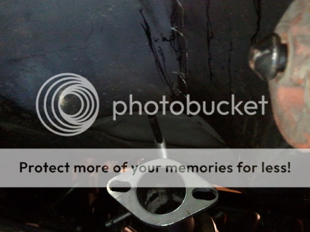

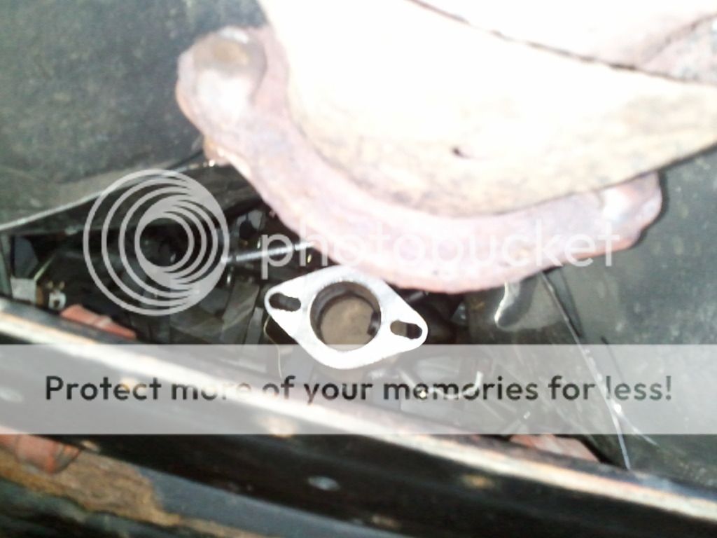

I was able to modify the flanges to accept a 4.125 bolt spacing, but it took a lot of time with a carbide reamer and a rotary file in my cordless drill. It made the edge of the flange really thin, but they should still work. I am a little discouraged right now because I drove my car up on a stump in the yard today and climbed under it to take a peek. The flanges look identical to the ones on the Mazda5, but the bolts seem a little smaller on the Fusion. The other difference that I noted was the angle. The Fusion flex pipe has what appears to be a 40 degree bend on the end of it, as opposed to the 20 degrees of the OEM Mazda unit, and the 28 degrees of the Pacesetter aftermarket unit that we bought to replace it. The angles are approximate as measured with my angle gauge and two of them could be affected by worn out flex sections.
From what I could measure with my tape measure, the length to the center of the elbow from the front of the flange (on the first cat/flex side) of the Fusion was 9 7/8" looking at it from the side. From the middle of the elbow to the back of the flex assembly measured to the face of the flange was 4 1/2". The Fusion definitely benefits from more room to work on the exhaust in the flex pipe area.

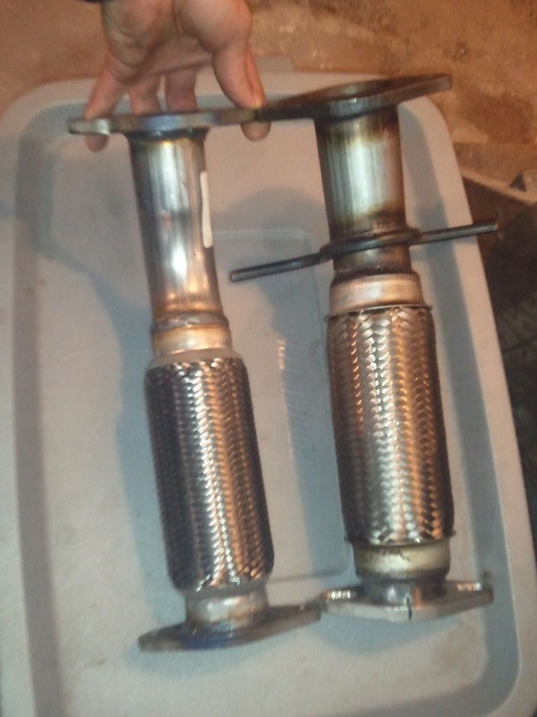

So now I am waiting to hear back from the welding supply store that I purchased the welder from (it does have a 3 year warranty) and I am also waiting until they get gas for the welders at work. The good news is that the flex pipe arrived from Canada today. It is almost an exact match to my measurements and that was a very good feeling to have that confirmed. So if we mod the existing exhaust manifolds with the flange, they will accept a standard replaceable flex pipe. I even test fit the pacesetter unit after cutting it and friction fitting the flanges, and it all worked out great. The only other thing that will have to be added to a replacement flex pipe is a hanger like the Mazda OEM units have. The one thing I could see is that if you have a heat shield that is coming apart, you might have to drop one of the little under-body cross-braces to get it to fit without chewing up the shield, but my stainless shields did great and I was able to rotate it into place with the hanger and all. The flex assembly I got from Canada is EXD (Exhaust Direct) part number X-2436. The Walker number is 52436 and is also on their part.

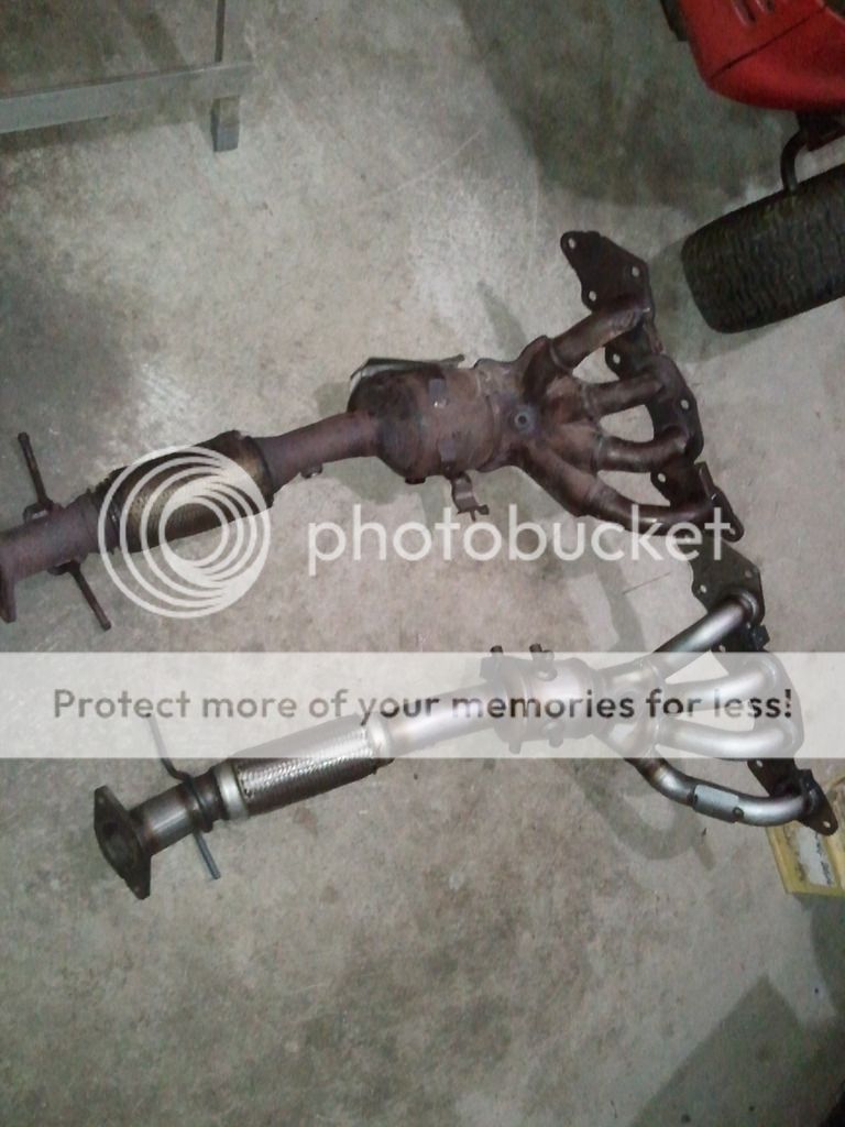

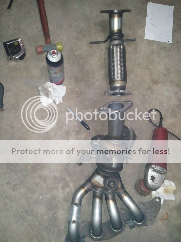

Here are some photos: First from Pacesetter unit cut.
Next is in the car from underneath with the manifold temporarily bolted.

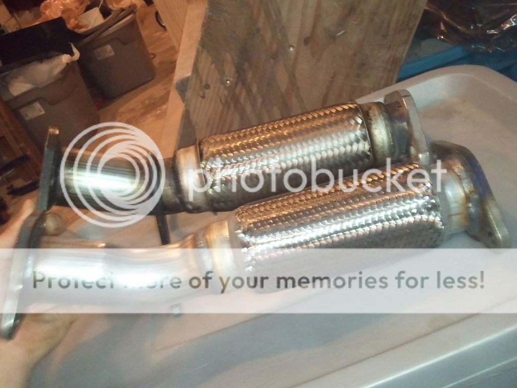

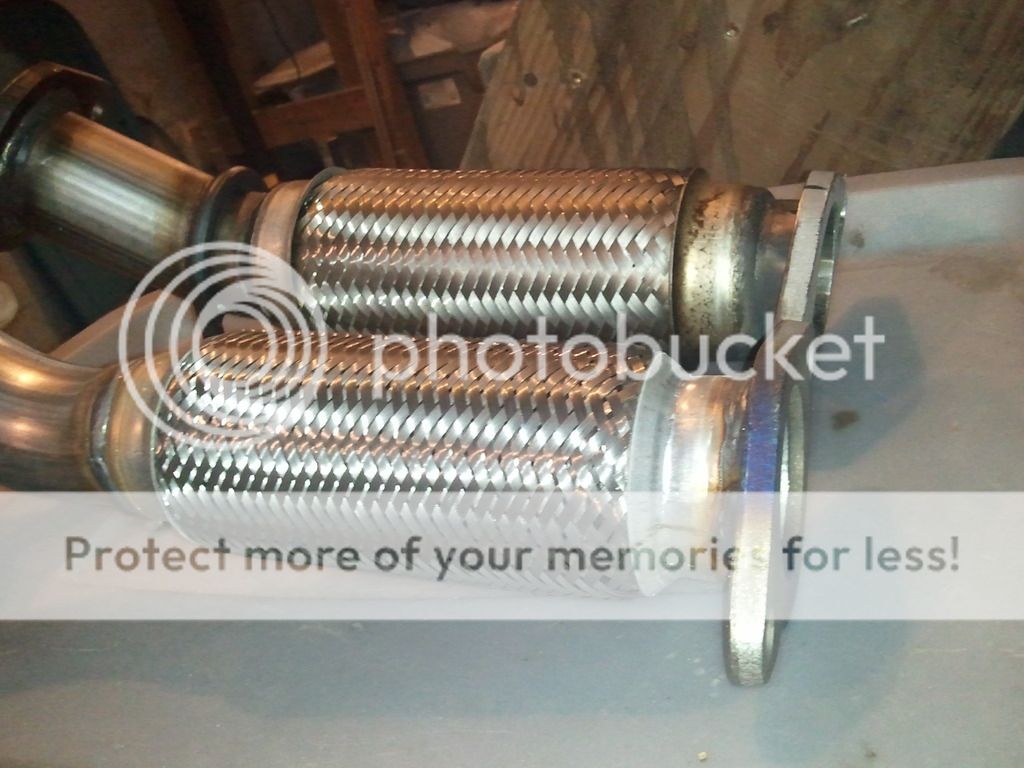

Here are side by sides of the two new flex assemblies.

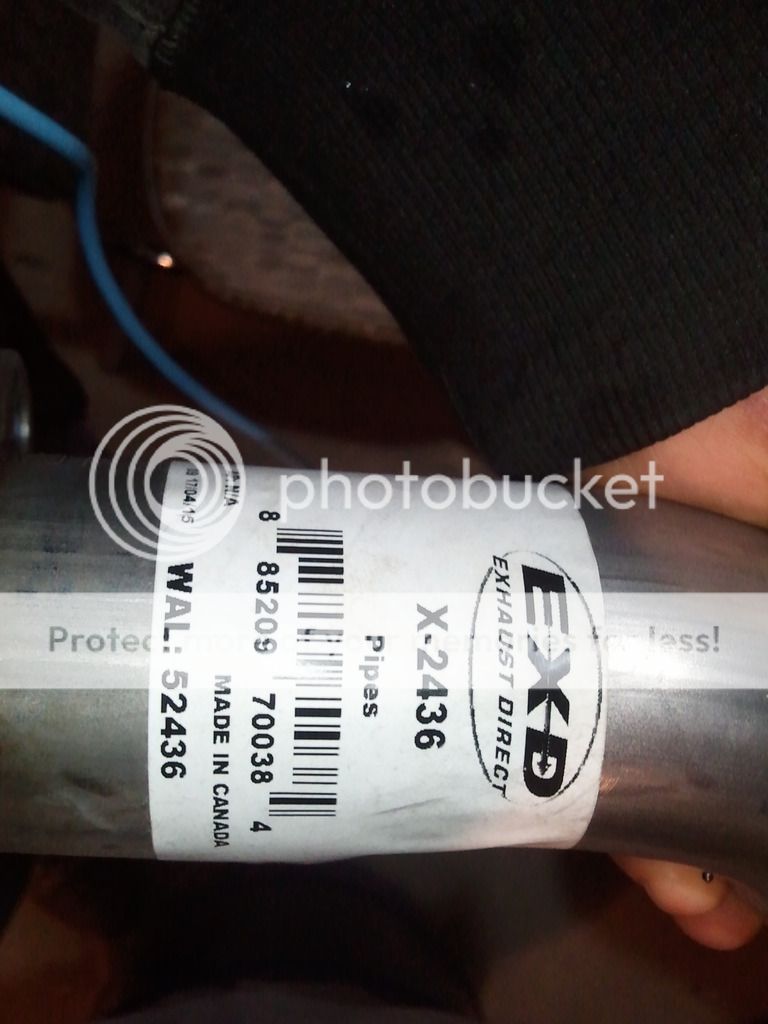

Finally the part number.
