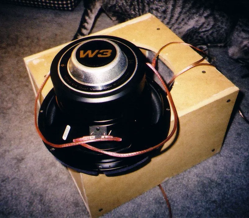

I use one JL Audio 10W3D4 Sub...Dual Voice Coil at 4 ohms, ran parallel, makes it 2 ohms, running 300W, sounds very good, tight, deep and kicks well enough for me (wow) The box isn't very pretty, but if I paint it or carpet it, should be fine...
