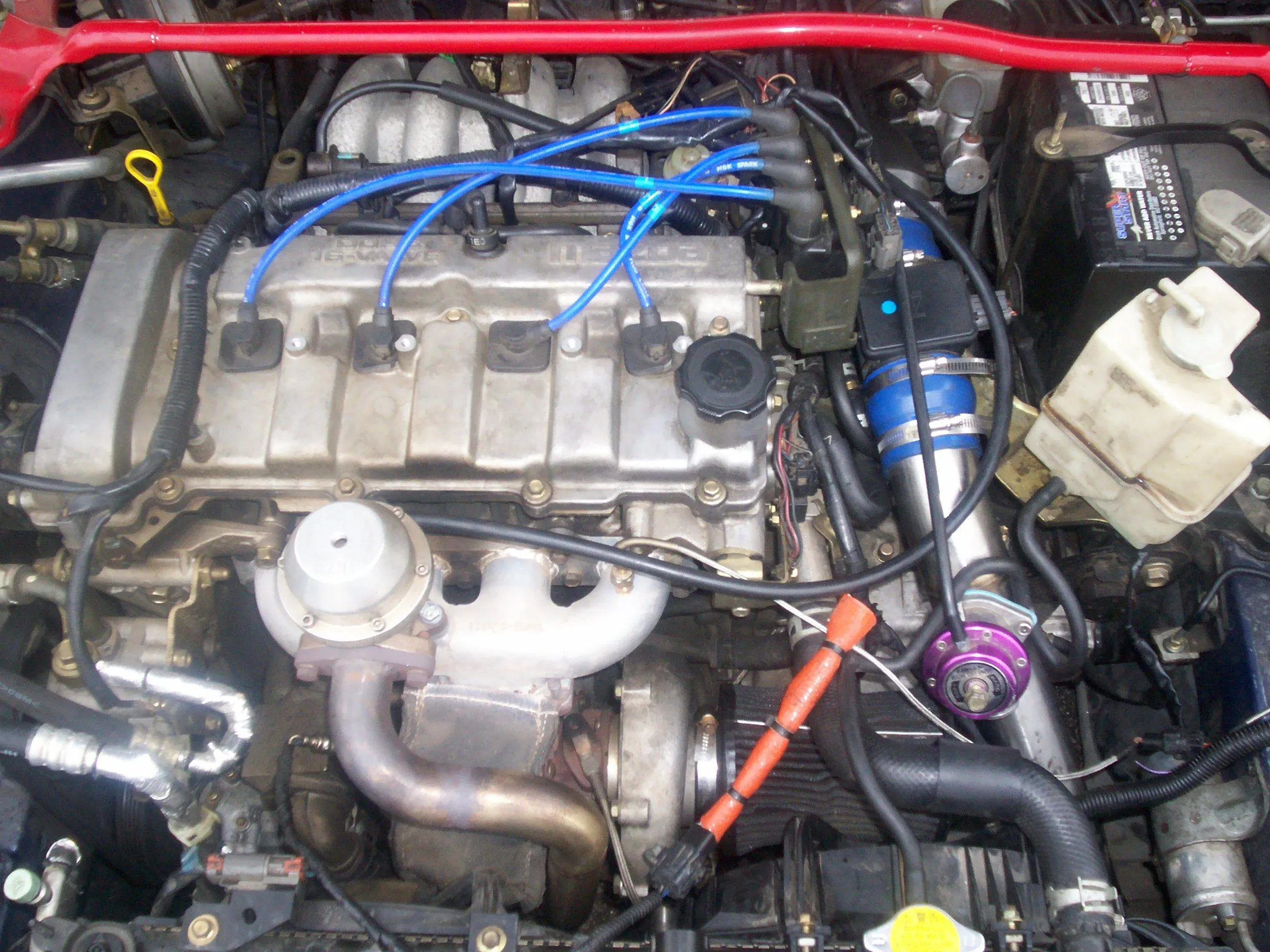

This is my setup, the only reason i changed coils is that the stock coils would
overheat and start to miss. Havent had any problems with these, just
rearranging stuff to make them fit.

that certainly makes it clear what needs trimming. thanks.

if you do plan on doing this...see if you can find a 626 valve cover...you'll be happier with the way it looks.
