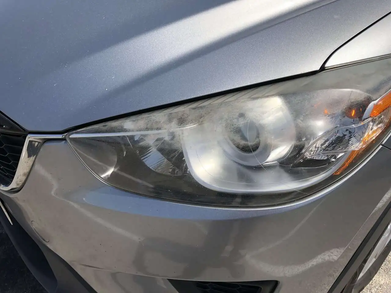

Our 2014's headlights are looking a little degraded along the tops of the lenses. I'd like to do a restoration, but I'm concerned about the textured areas along the top edge that show up under the edge of the hood. Has anyone tried restoring their 1st gen headlight lenses? How did you handle those textured areas? Did you wet sand, dry sand, or something else?
I've done dry sanding and 2K clearcoat on other headlights with good success. But I'm not sure how well sanding will work with those textured areas on the lenses.

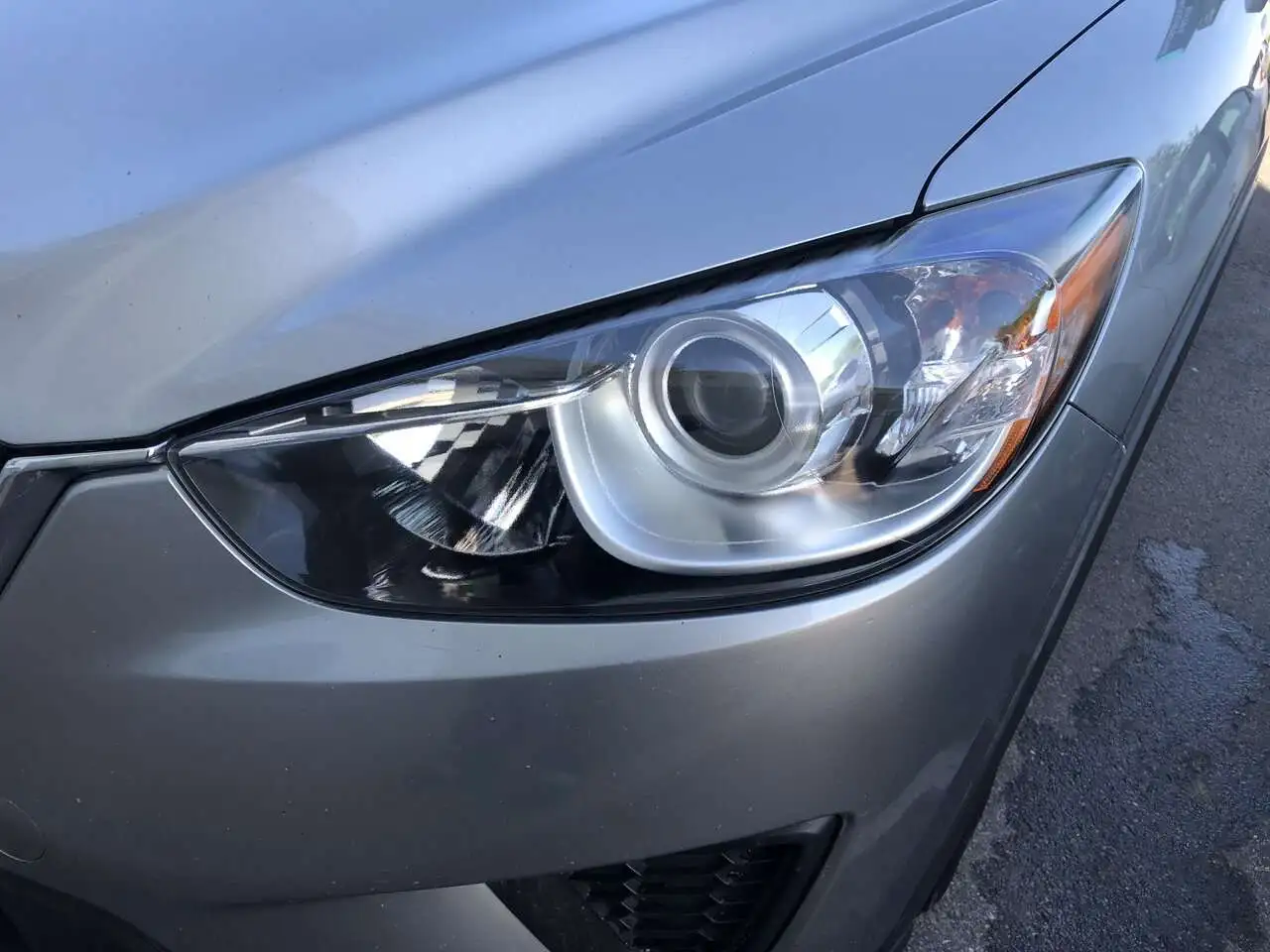

Man is this a timely post on this subject. Just 2 days ago I finished restoring my headlights on my 2014 touring. My before and after pictures look just like your before and after pictures (except for one tiny run that you have to hunt for LOL - must be careful about runs as the coating calls for a medium wet coat with a 50% overlap - done twice).
I used Meguiar's PlastX and Meguiar's Headlight Coating. I just rubbed the polish with an old coarse washcloth using mostly circular motions and occasional back and forth horizontal strokes. Then taped newspaper around headlights and wiped with rubbing alcohol before spraying. Total investment of about $18 and some elbow grease.
I bought mine at Walmart for basically the same prices as Amazon.
To answer OP's question, I just polished the textured areas along the top surface a little bit to clean them - saw no need to do much as they don't illuminate anything.. Concentrated efforts on the clear portion that the bulbs shine through. Very satisfied with the improvement at little cost. Has to be one of the biggest bang for the buck things I did on this car. Easy job really. Just don't rush if you decide to do it.
Edited (again) to add: My headlights have some minor clouding/crazing on the INSIDE of the lens but you have to get close to see it. Can't do anything about it and is minor enough to not be concerning. I'll do them again in the future before buying new headlights if at all possible.
UPDATE: Don't know if I'm being premature in posting this in case the Meguiar's clear coating really does dry to a hard finish, but yesterday while checking out how it was holding up, I rubbed the lens lightly with my thumb and it left very tiny scratches from my dry skin. I'm wondering if it really is a somewhat soft plastic coating rather than a clear paint topcoat which dries harder. Regardless, no more swiping with a paper towel while giving the windows a quick cleaning when removing road grime especially in winter between car washes. Need to be gentle cleaning them if scratch easily.
Just thought I'd put this out there for anybody contemplating going this route. Might pay to use something that dries hard. I may have been better off just giving them a wax coat after polishing. At least that can be easily renewed (and removed if so desired).
I don't know what the professionals use but Tomescu might have gotten a durable, long lasting restoration on his headlights.
This is timely, I just noticed a lot of scratches in that same area of my headlights as in @Tomescu photos.

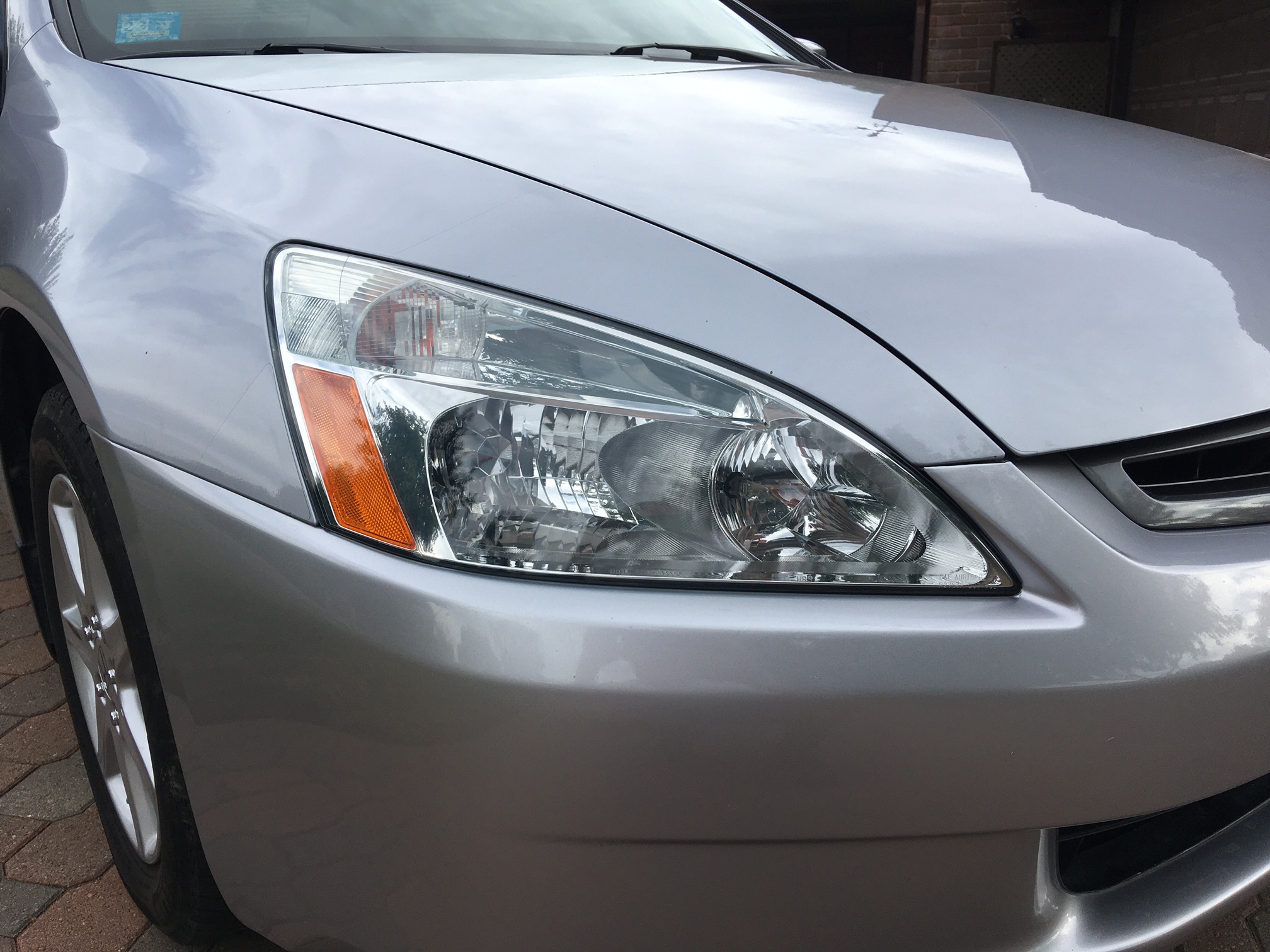

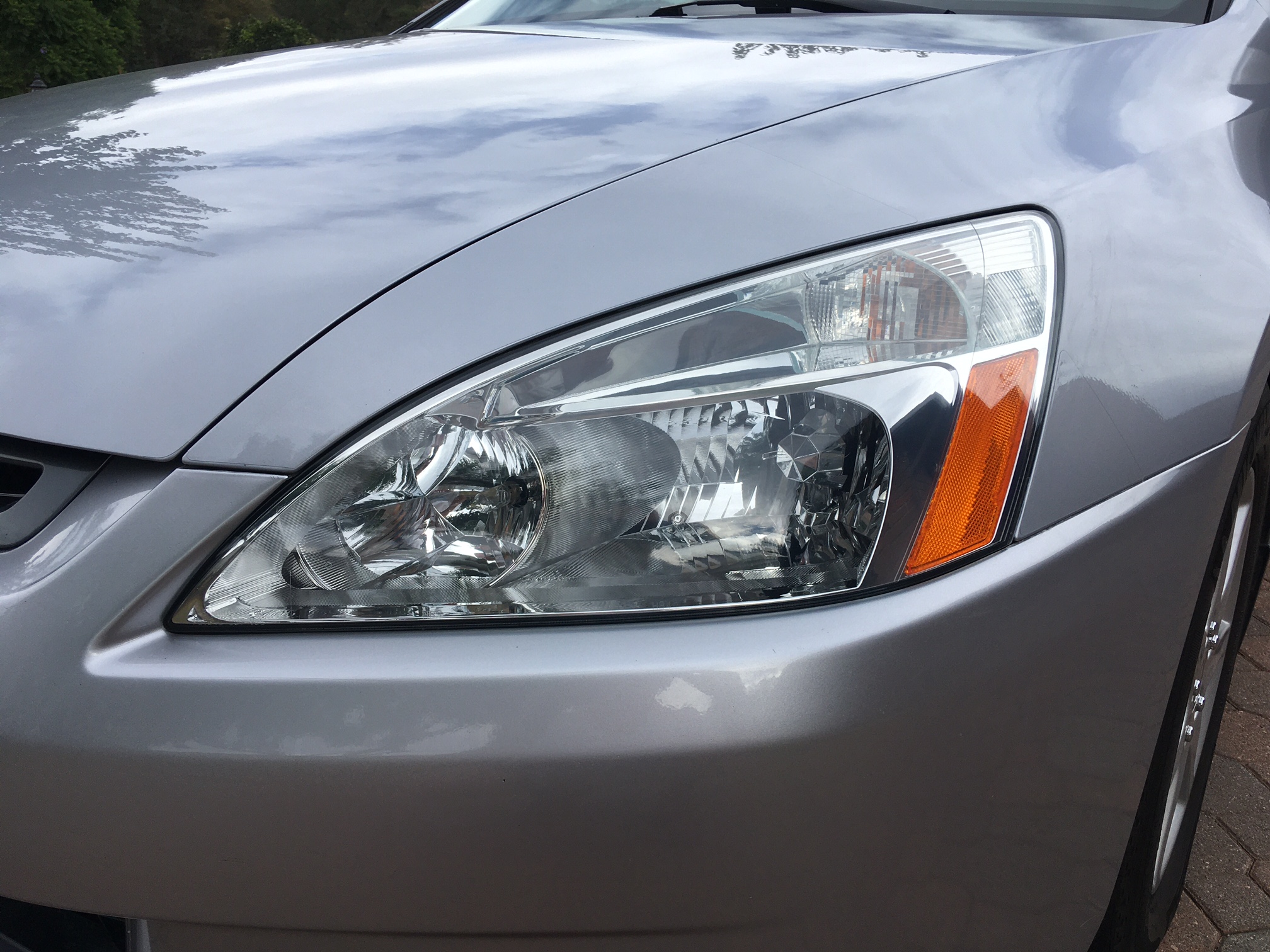

I just finished doing the headlights on my 2004 Accord using the Sylvania kit. It was $20 from Amazon. The lights are oem so the finish was definitely going away, not terrible, but yellowed along the top third where they get more sun. The kit includes 400, 1000, and 2000 grit sandpaper, but I didn't use the 400 because I didn't think they needed it. Took about two hours, it could be done in less time but I'm fussy and prepped for a longer period of time than the directions call for. I didn't think to take a "before" pic but the lights were in typical condition for a 19-year-old vehicle.
I think this kit would work well even on the textured surface of a Mazda's lights. The spray cleaner in the kit is really good at removing the yellow, and rather than try to sand that area I'd just hit it with the spray and a toothbrush. Save your elbow grease for the smooth portion.

Your car looks really clean for an '04 and the headlights look great too. Hopefully my 2014 vintage headlights will look that good in another 10 years. That Sylvania kit looks worthwhile. Does the clear coat dry to a hard finish?
Thanks. The topcoat is supposed to dry to a hard finish but mine had only cured for a couple of hours by sunset today. I bought the kit based on testing done by YouTube's Project Farm. I have seen reviews on the Sylvania kit and the clarity should remain anywhere from a couple of years to several, depending on the amount of sun exposure. Sylvania sells an "essentials" kit for $10 that appears to be a way to touch-up the clarity when it starts to fade without having to go through the sanding process again. It would just be a matter of wiping the headlights with the cleaner and then applying a new topcoat. That could be done in less than five minutes, so I think the Sylvania kit is pretty good.
