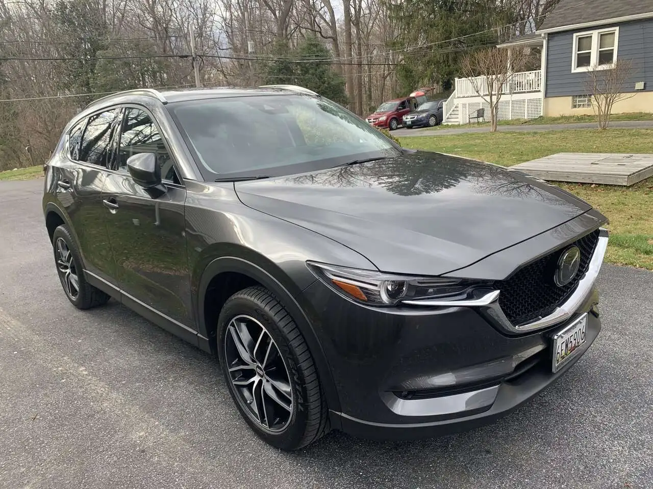

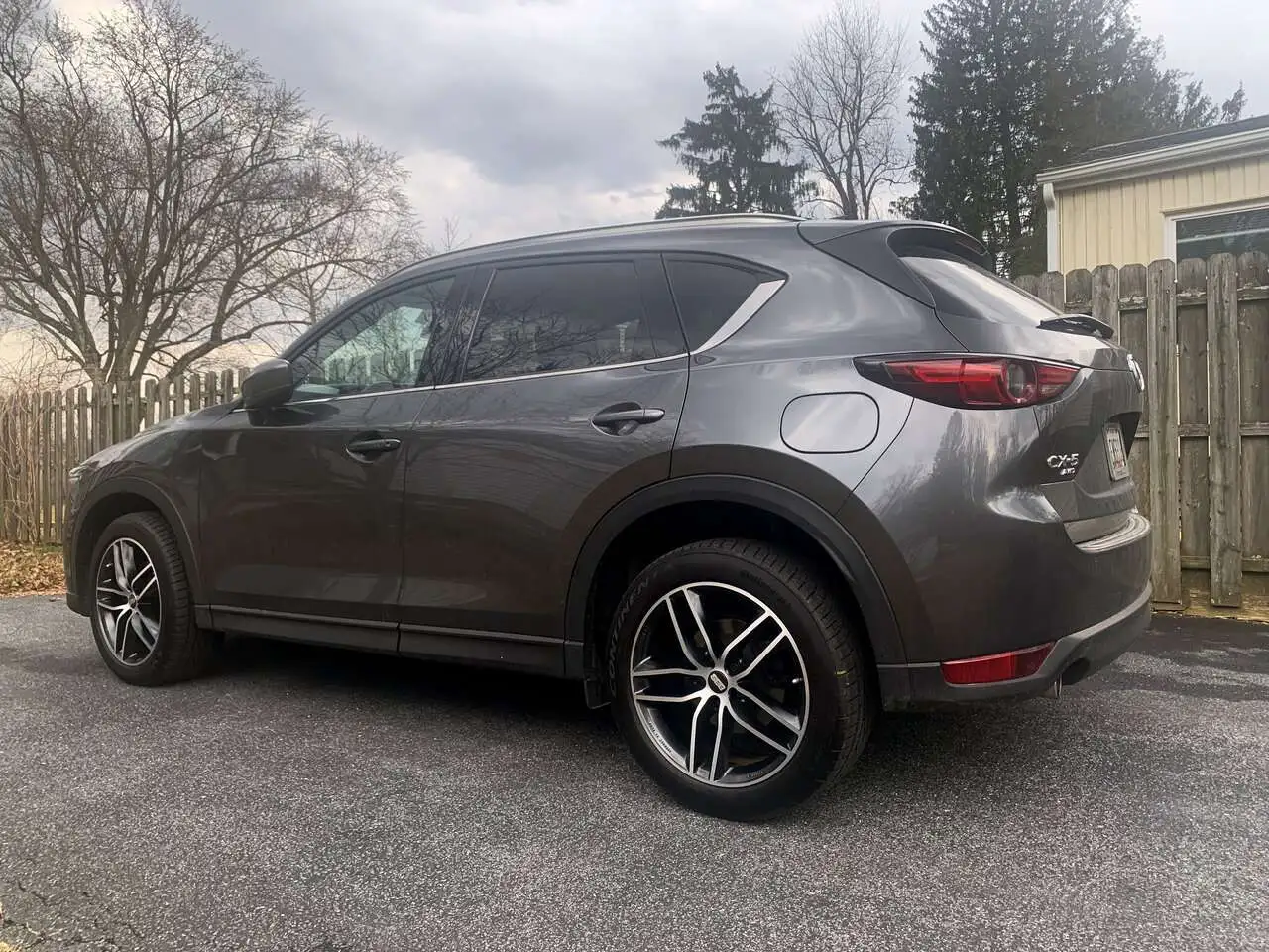

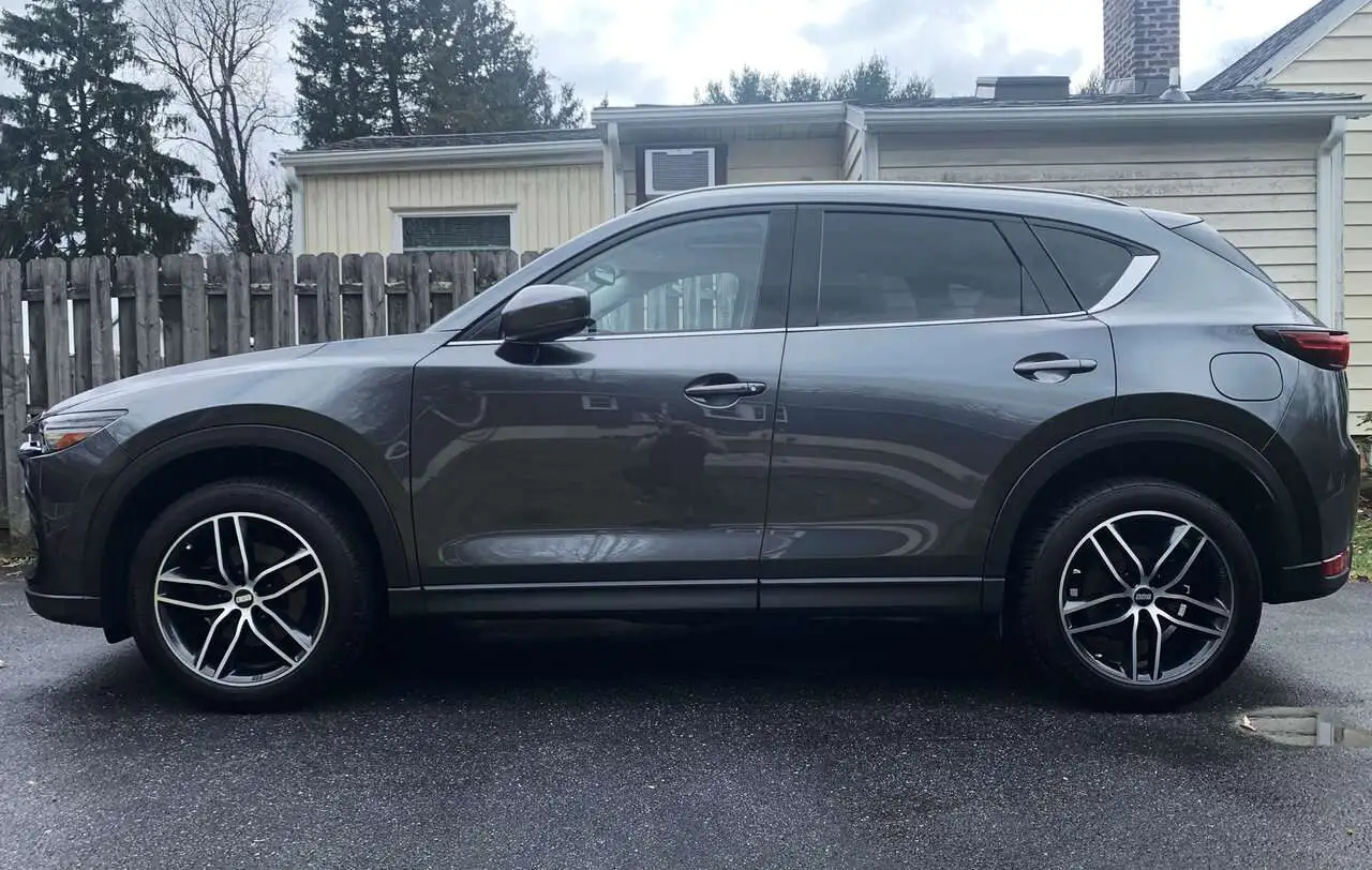

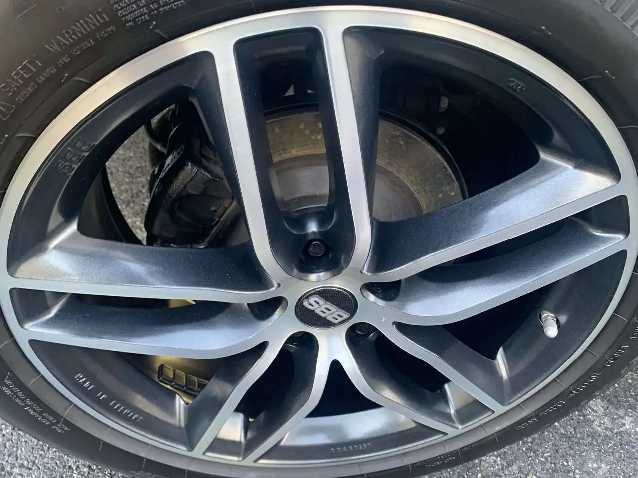

I do indeed. They started their life in the Brilliant Silver color. They were then powder coated using Prismatic Pearl Black, with extra metallic flake added. They used Alien Silver underneath as well to make it look more charcoal rather than rich black, and then of course adding more flake to it also helped. The wheels were then machine cut, and then finally clearcoated using Prismatic's Soft Clear.

Nice. That looks great on the machine gray which I also have.
I think the key to the Machine Gray is going a shade or two darker, or much lighter. When we were looking at many of Prismatic's samples like Evo Gray, Kingston Gray etc they almost clashed. You could probably get away with not using the alien silver underneath, but my friend who did the work was curious how it would come out, and my wheels were the test dummy. They would still be on my car if my wife hadn't become so obsessed with them. She drives a 2018 Tuscon Limited Ultimate in Metallic Gray and they just happen to share the same bolt pattern and same hub size. If I had to do that over again, I may have gone with gloss over the soft clear, but the soft clear does have a unique look to it. They look really great on her car and she is happy with the look.
