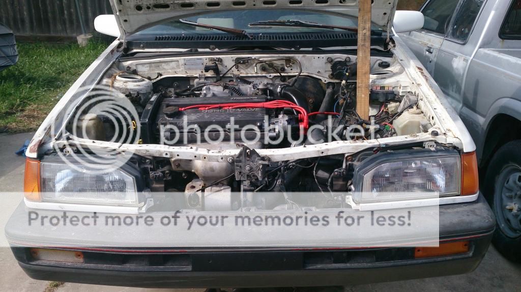

So I haven't posted on this forum for a while now, well any forums for that matter, really. Just thought I'd share my project. It's taken me about 4 years to get to where the car currently sits and I'm so close to finishing my short term goal I can taste it.
***I'd like to add that in no way am I a pioneer in this swap. It's been done a few times and each time slightly different. I owe a lot of gratitude to the Yahoo Mazda 323 GTX group, Darrek at Corcksport for taking the time to talk on the phone with me when I first began, ClubProtege, Ford Laser, several facebook groups and many other sources.
My short term goal is to produce one strong (don't laugh, haha) GTR drivetrain swapped GTX running on stock BPD ECU with a BF GTAe body kit. (Hence the title "1988 Mazda 323 GT-RAeX") I don't know I thought it was kinda funny, haha!

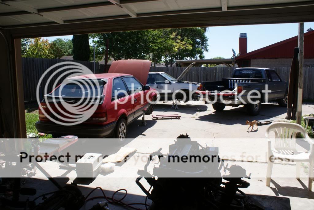

Purchased 2 1988 Mazda 323 GTXs in 2010 within 2 months of each other. I should've played the lottery cause I couldn't believe I found 2 GTXs in Texas on craigslist in such a close time frame, haha!

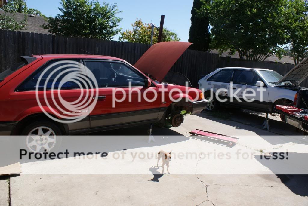

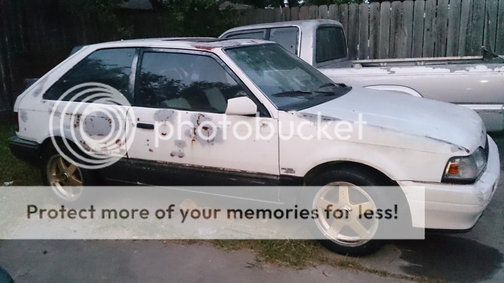

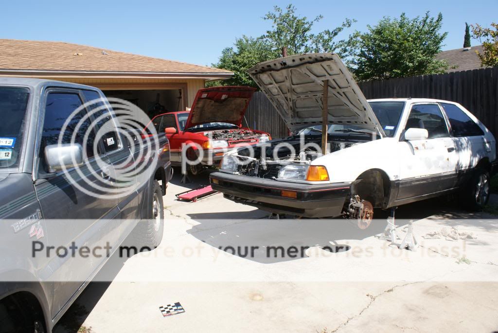

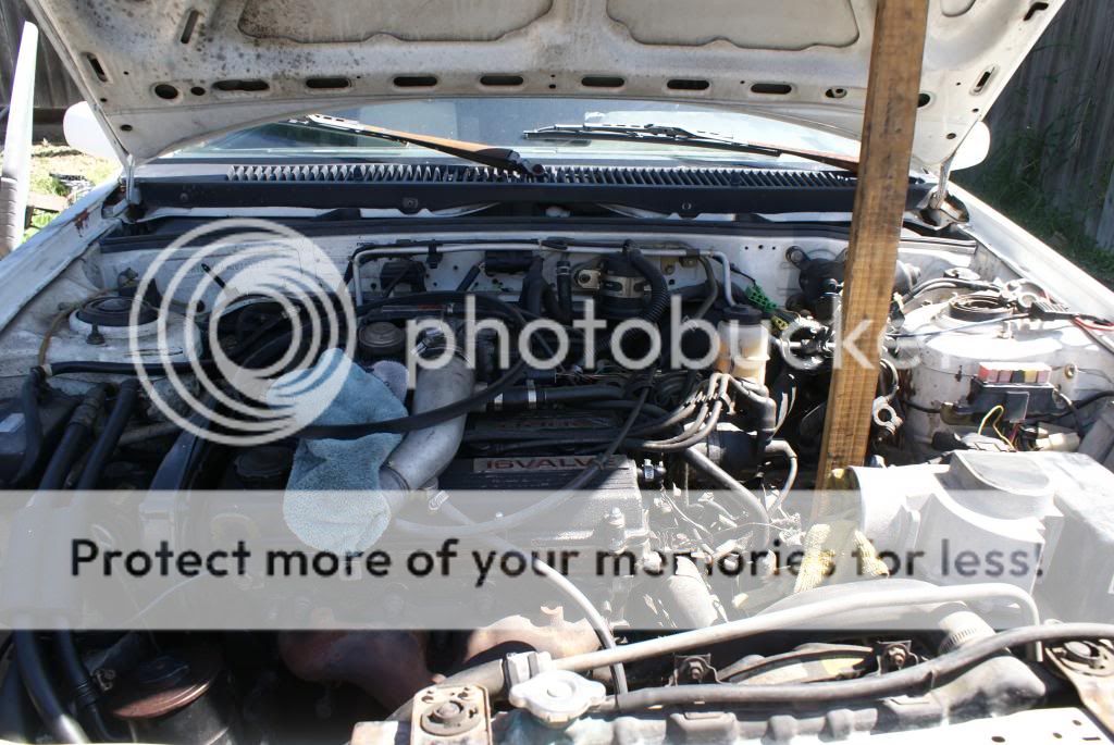

First is the red one bought in Houston bone stock with over 220K miles on the odometer and looked to be fairly well maintained even though engine lost compression in all 4 cylinders and transmission pretty much on it's last tooth. I was still able to drive it all the way home! Sale is actually pending to one of my good friends and fellow SMACC member who also owns a Speed6.

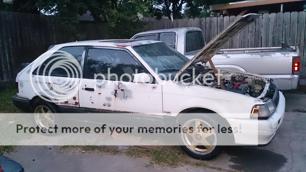

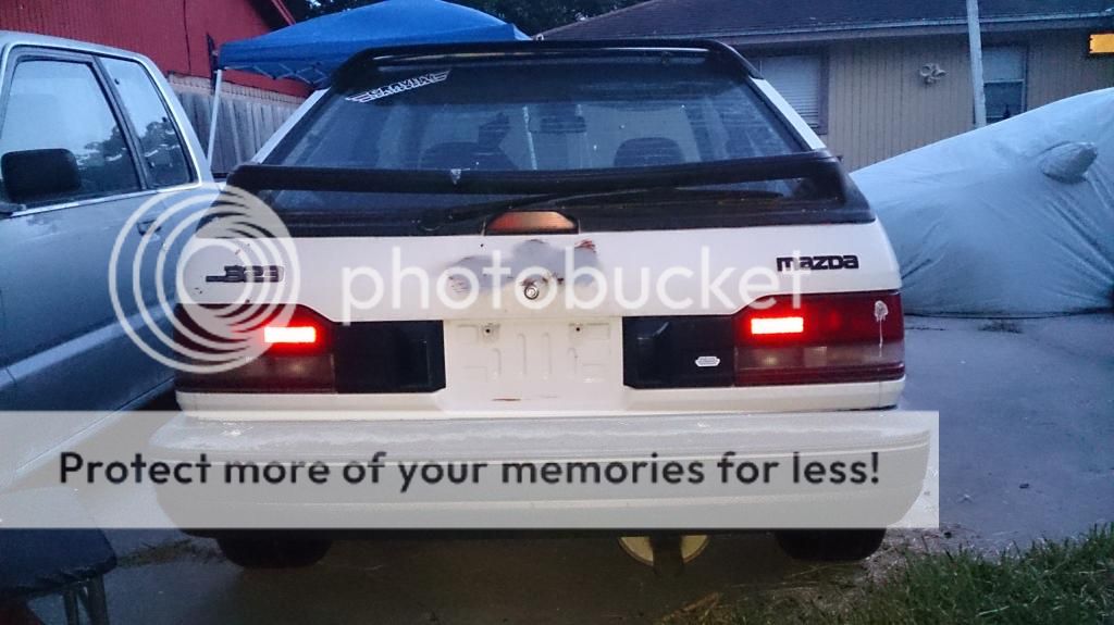

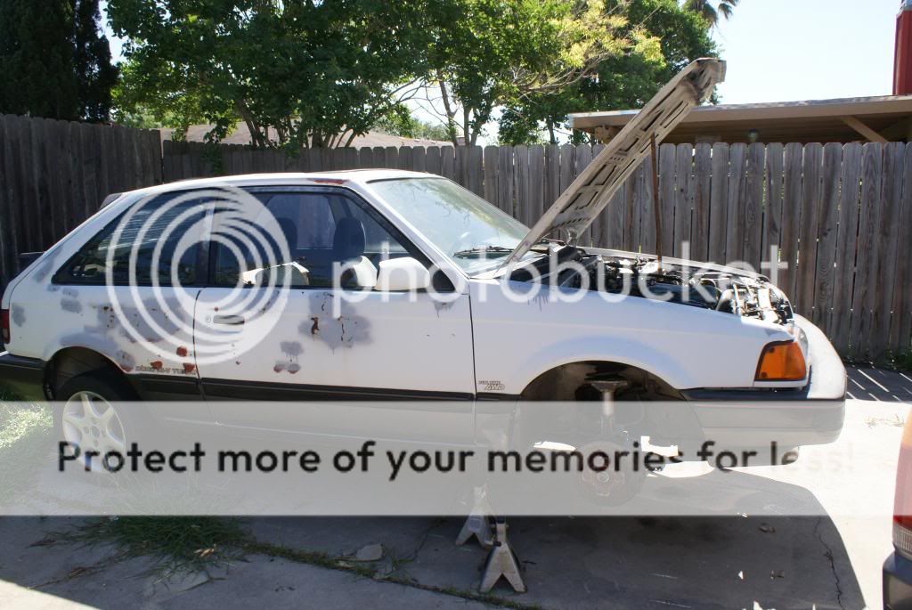

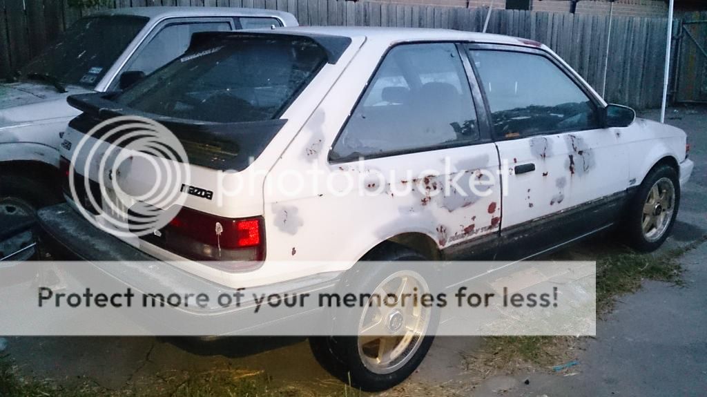

Second is the white one bought in College Station with over 140K miles on the odometer. Almost stock, except for boost gauge, AFR gauge, Momo hub and steering wheel, OZ wheels, solid shifter bushing on the tranny side, and glass sunroof mod. It had to be trailered due to bald tires and expired tags. This one I'm keeping and has undergone some modifications (remember it's still a work in progress so bare with me, haha). List as follows:

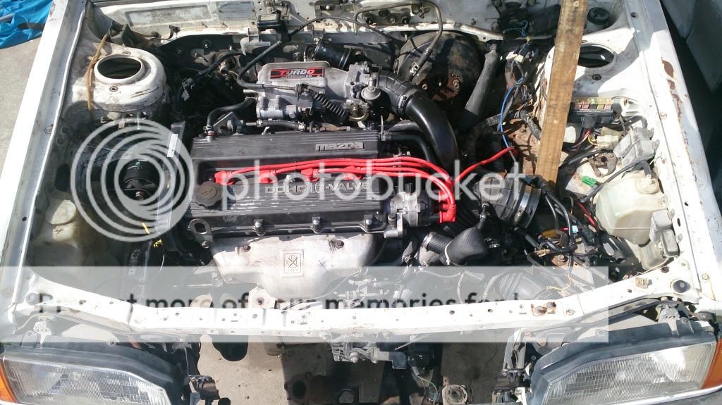

Engine and Drivetrain:

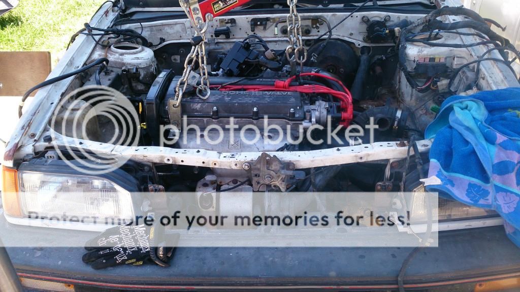

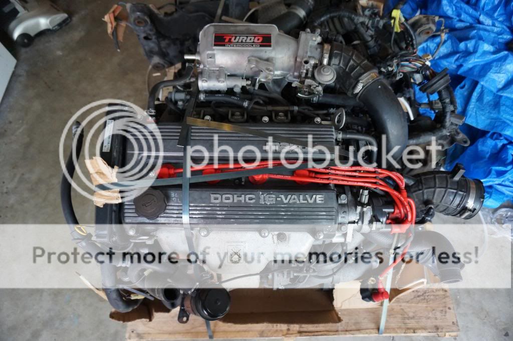

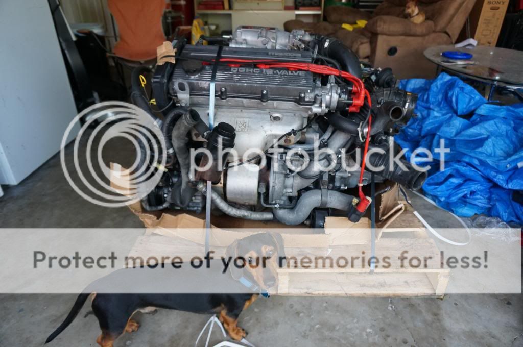

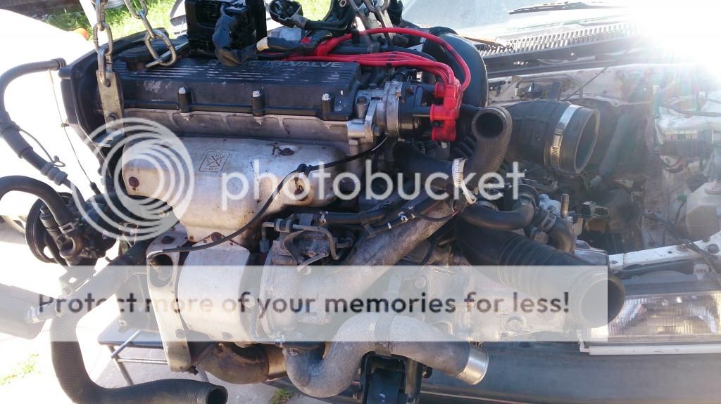

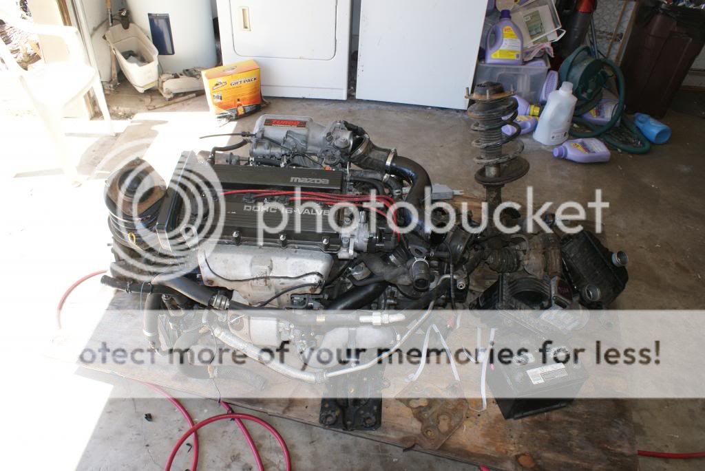

1.8 JDM BPD from Mazda GTR (passenger mount possibly needs modifying)
BPD Engine Harness and ECU (Waiting on wiring harness to be finalized)
GTR AWD Transmission (Still need to fab up the driver's side mount)
GTR Viscous LSD Center Diff

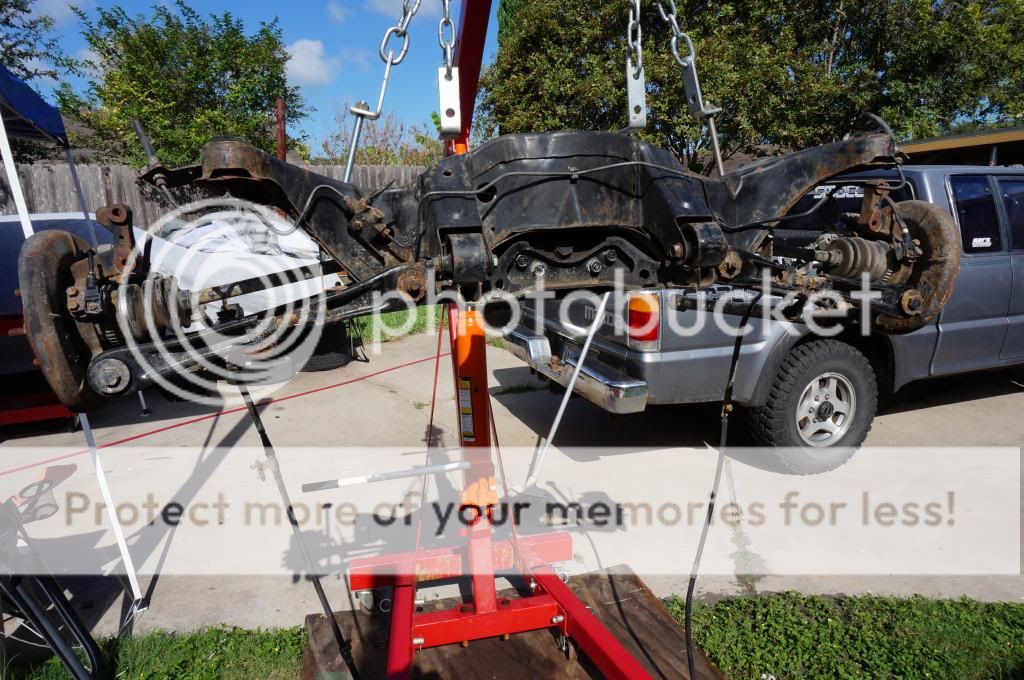

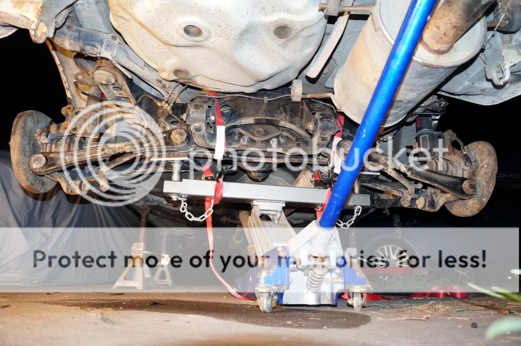

Complete JDM GTX Rear Subframe swap w/Viscous LSD

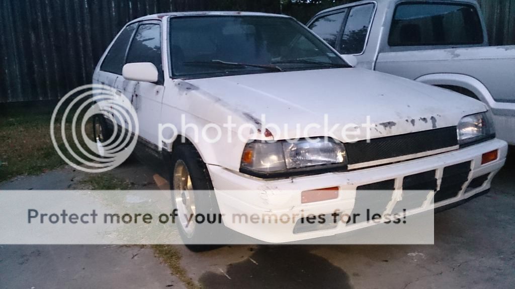

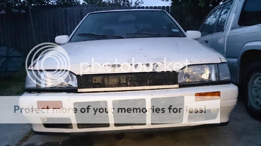

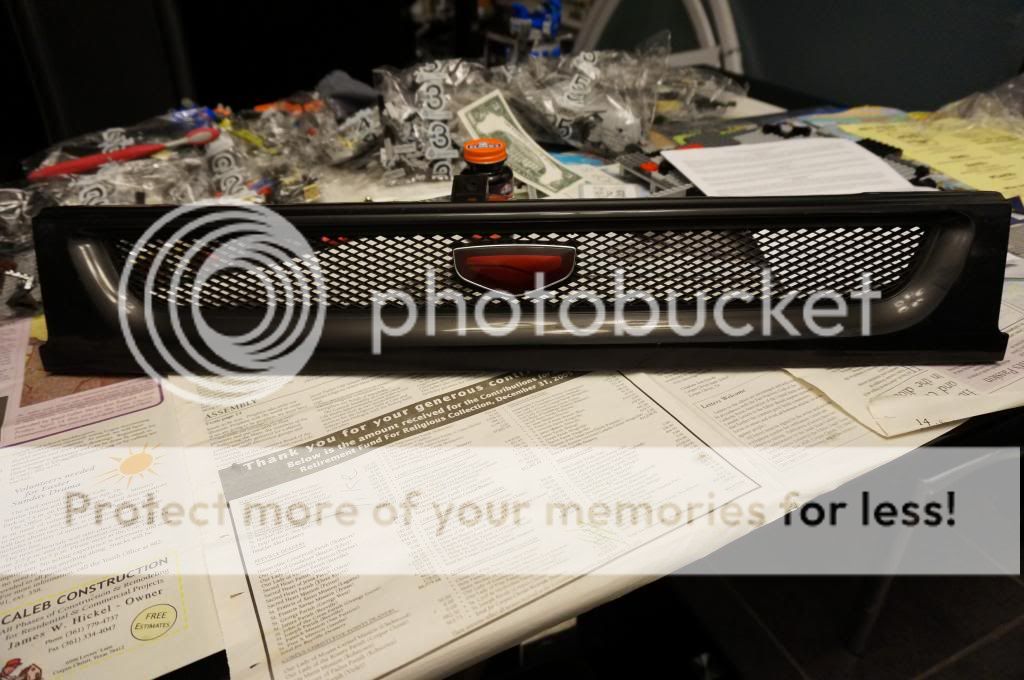

JDM Mazda GTAe grille and front bumper
JDM Mazda GTAe rear bumper (On hand, need to install)
JDM Side Skirts (On hand, need to install)
JDM Headlights and corner lights
EDM Fenders with side markers (Not sure if I'm going this route with JDM corners)

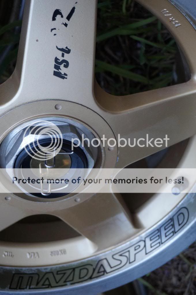

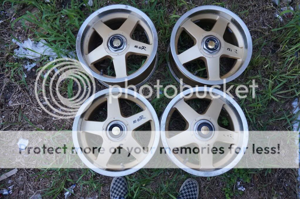

JDM Mazdaspeed MS-01R Gold w/polished lip 15x7 4x100 +35 (Needs refinishing)

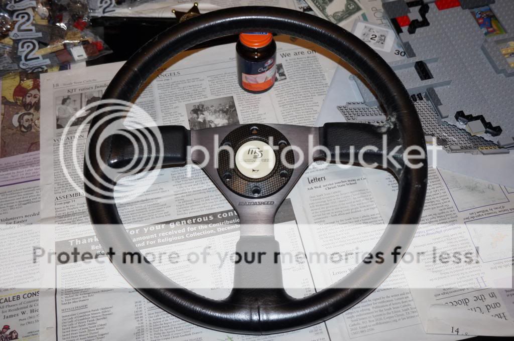

JDM Mazdaspeed Steering Wheel and horn button

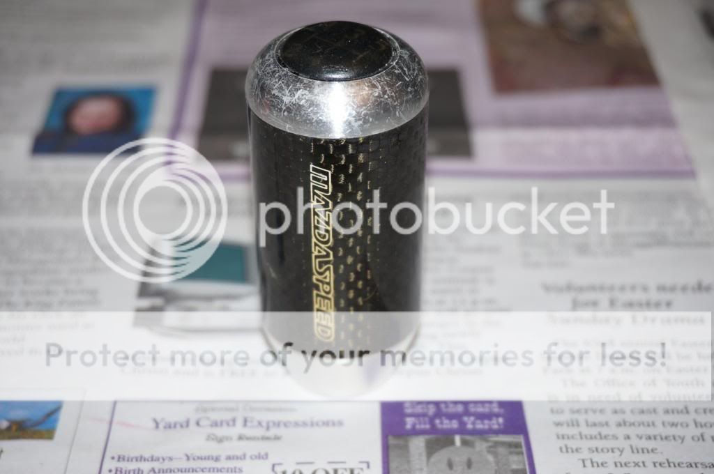

JDM Mazdaspeed Carbon Fiber Gear Knob

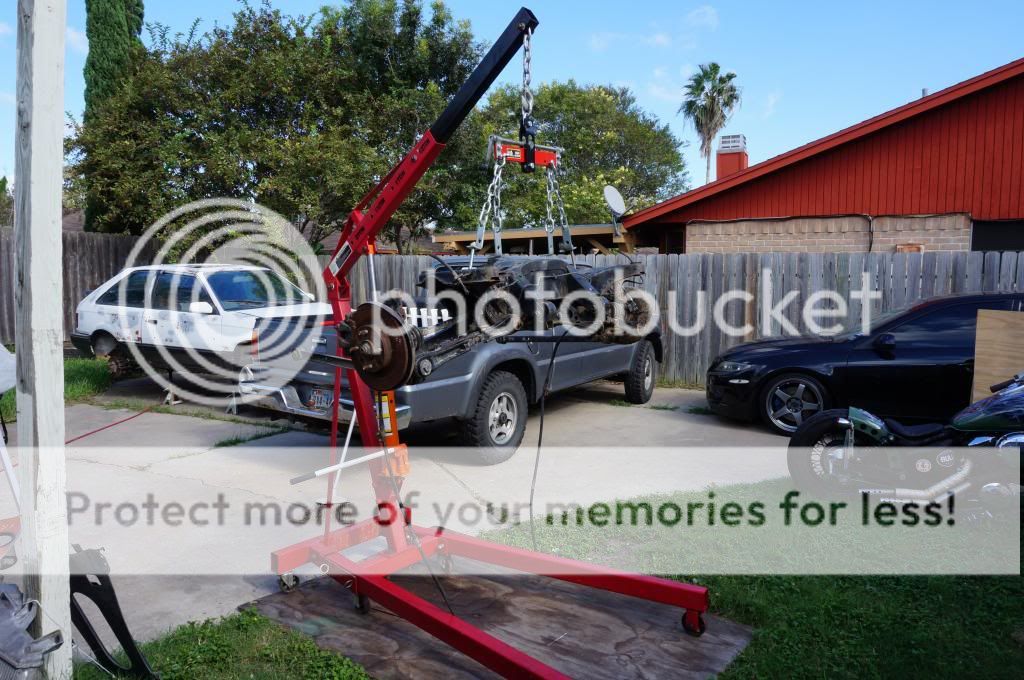

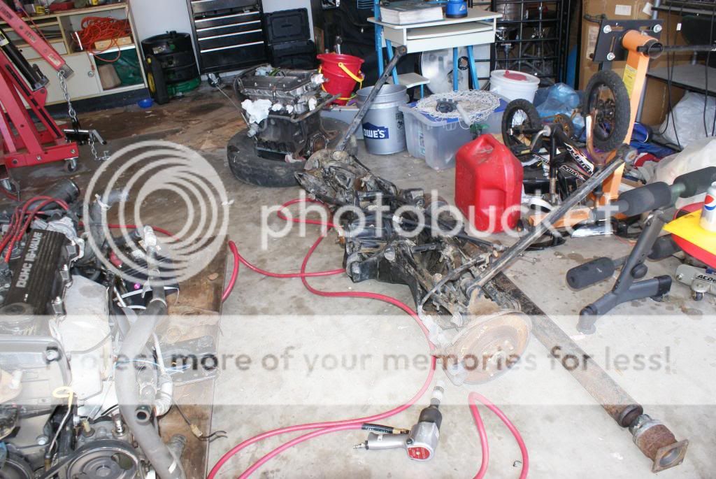

JDM GTR Drivetrain
JDM GTR Drivetrain

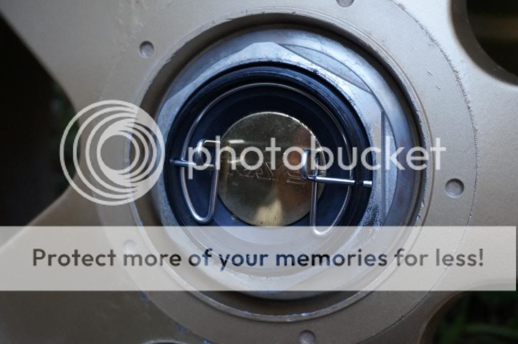

My knob needs polishing, hahahaha!

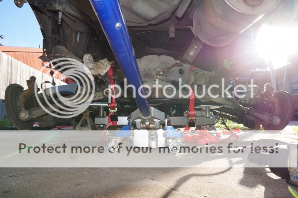

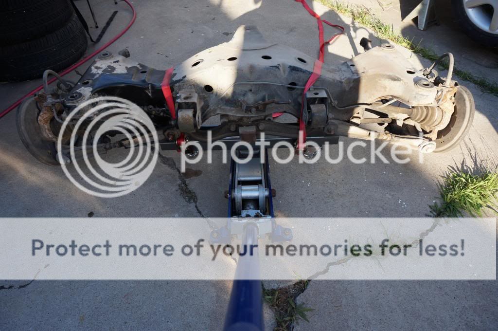

JDM GTX Rear subframe:

Awesome i just picked up a mazda 323 gtx myself and now i got another build to work of..... Where did u get the front bumper and grill
Thanks, congrats on your purchase. The bumper and grille I was lucky to find from a guy in Australia. I picked up the bumper, grille and side skirts for 500, but shipping was what hit me hard. I paid more for shipping than the whole lot, haha! There's a guy selling a pretty clean one on the Mazda 323 GTX Facebook group. But prepare yourself. It's a very rare, desirable, and expensive bumper because it's very functional when going FMIC. That's the downside to owning a GTX, parts are rare and sometimes expensive. But if you're determined, you'll find what you want and have a fun little car. If you're not already part of the yahoo GTX groups, club protg, Ford Laser, and the many Facebook pages, join up. There's a ton of good information on those sites.
Here's the GTX Facebook group. Request to be added and scroll down till you find the GTAe bumper for sale. Good luck, dude.
https://m.facebook.com/groups/211102012252587
Yea i figured it would be a pain to get the bumper set up but im definitely going to be asking some questions.. Your build is looking awesome car is coming along nice
Awesome looking work. Question though, why keep the white car instead of the red one? Looks to be in a bit rougher shape.

I'll be more than happy to answer as many questions as I can and point you in the right direction when I can't. I'll be the first to admit, though, I've got a lot to learn when it comes to hard core engine building/tuning so dont expect much outta me there, haha! Did you take a look at the bumper on Facebook? I believe he's asking $1000 which is what they're going for, and it's clean. But you could always offer less. Who knows.
Thanks philrab, I appreciate the compliment. Everyone asks me that!!!! Hahaha! And you're absolutely right. But the white one has less miles ( not that It really matters since almost everything is getting replaced) it doesn't have cruise control, which is a little rare, I wanted the challenge, and basically I like white better than red, hahaha! I really wanna paint it Whitewater Pearl, same as the MS6. In fact, I have a quick update:
Turns out my friend isn't gonna buy the red one after all. So I'm planning on returning that one to completely stock and use it as a lil recreational cruiser.
