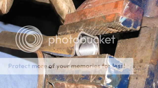

Here are my new lca, just need a clean up and coat of paint.

Modified lower control arms for adjustability.

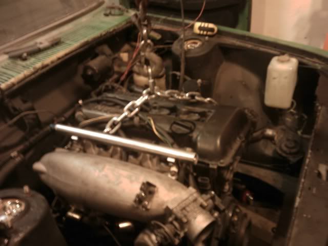

Oh and did some work on her tonight.
Sorry I didn't get measurements or more pictures but there is A LOT of room between the frame and the oil filter. Optical illusion.
but the KA is going the way of the dodo. I got a GREAT deal on a black top sr20 with a built head, knock off greddy intake manifold and microtech lt10 ecu for $2000. Need to sell all my KA stuff now.

S13 Blacktop SR20DET
Greddy knock off manifold
Greddy rocker arm stoppers
Greddy valve retrainers
HKS 272 cams
ACT 6 puck sprung clutch.
Everything else stock.
