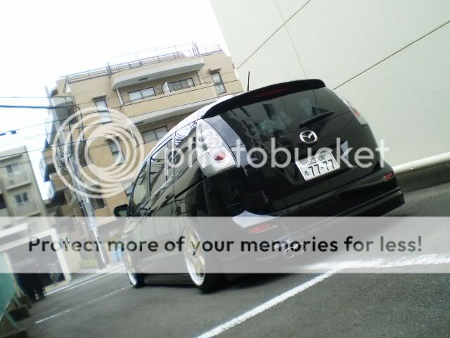

Heres a pic to give you an idea...
UNfortunately I do not know the size of these but man I wish I did.

Google jdm door spacers. Lol. Picking up the 5 tomorrow at 5pm. Hopefully be able to test fit the rims Thursday morning. I'll have my D2s installed later next week. That black Premacy is Tits. Feelin that stance and its almost exactly what I'm shooting for. So pumped to rip into this car.... thanks for all the posts.
