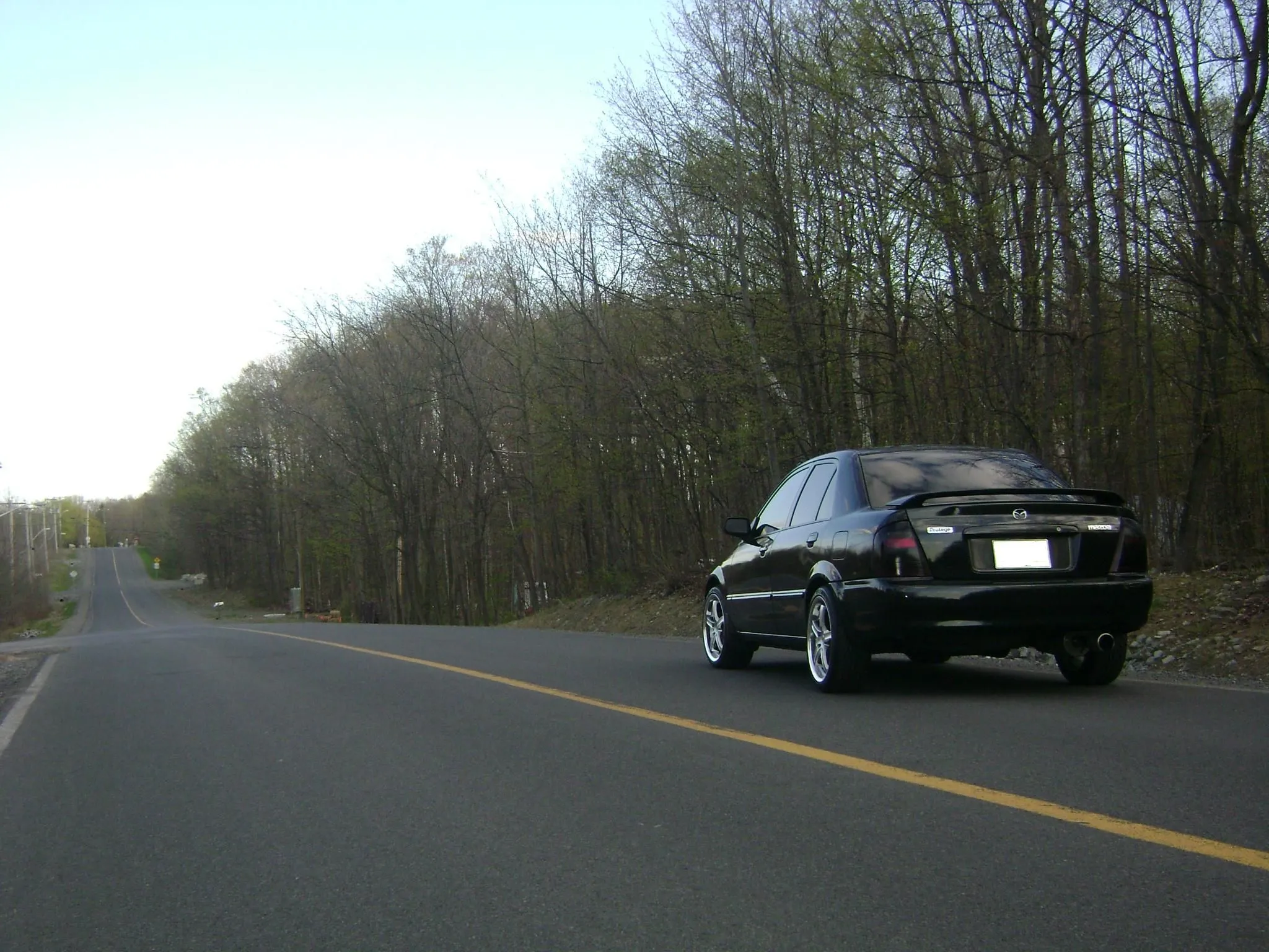

A lot of people said that 17x8 couldn't fit on our cars but some of us tried it out for REAL and with success. I just put on my 17" TSW Nogaro Wheels which are 17x8 with a 40mm offset on 215/40R17 Nankang Ultra Sport NS-II tires on stock suspension, no drop or nothing.
Tires will rub slightly when I have more than 300 pounds in the back seat going over moderately bumpy roads (And we have very bad roads as it is in Quebec). It's only the rear tires that rub. When there is nobody in the back seat, I can take turns as fast as I want without rubbing.

i don't think anyone said they wouldn't fit, they would just rub... Plus you're at stock ride height, lower your car and then we'll talk...
If I lower the car, add some camber and adjust a few things it can work better than what I actually have right now. AWR had their P5 pace car with a big drop with 18x8 40mm offset and Anthony said that it was better dropped with camber for wheel and tire clearance.
