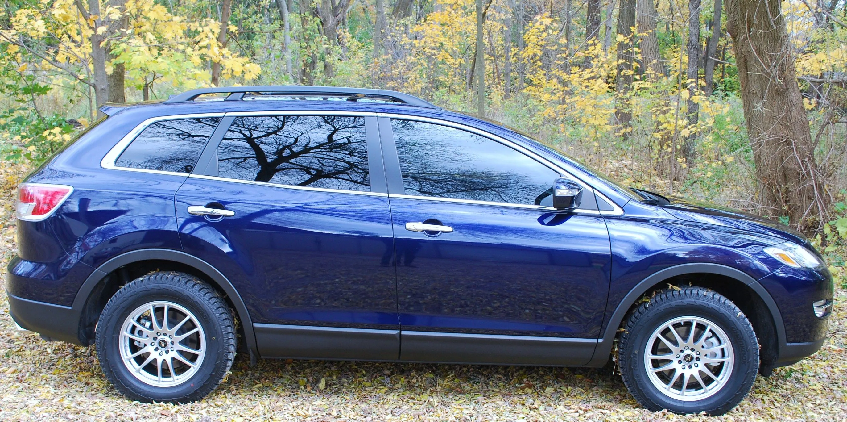

I installed 17" Hankook iPike RW11 winter tires with alloys on mine, see picture.
Looks good. I think I'm definitely going to go with the 17's now. It doesn't look as bad as I thought it would with only 17's. Thanks for the pic. How much did you pay for the Hankook's?
