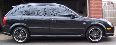

Stock height? I am as low as I can go with 18x7.5's 50mm offset w/ 215/35/18's. Stock height you would be fine with 48mm. I'm pretty sure 48mm offset will work if you roll the fenders if you are lowered.

Also...I have 215/35/18 with +40 offset. Lowered with Tein S-Tech. Had to roll fenders but the wheels looking amazing pushed all the way to the edge.

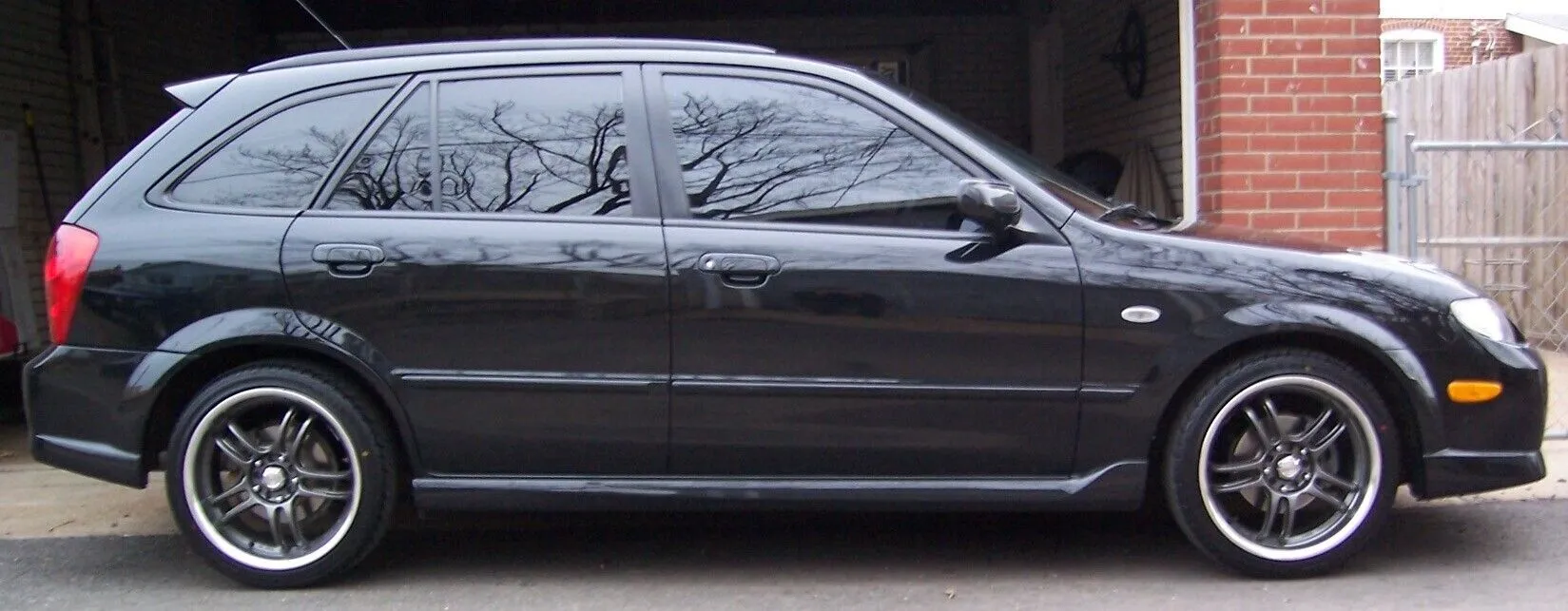

i love the look of my 18's........but im on 225/35/18 tires and the ride is much rougher than the 205/45/17 stock mazdaspeed rims/tires.
i got a set of 18's and my stockers, look better on 18's but handles way better on 16's

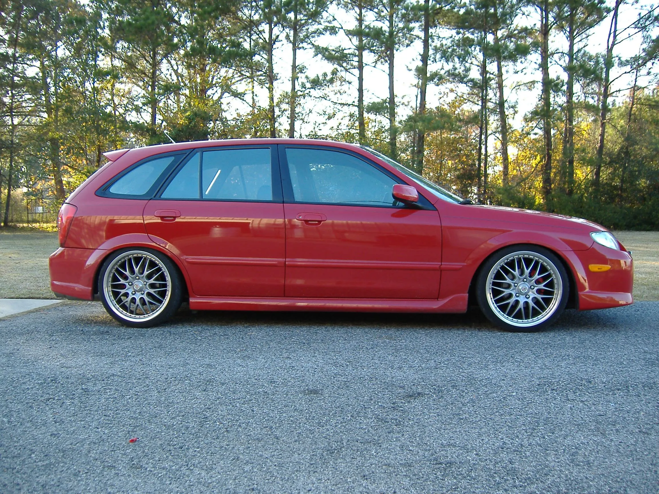

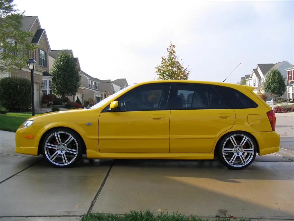

18" +45 offset. 215/35-18 tire
I've got the same ENKEI's as the blue sedan pictured above.
Mine are 225/40/18 with stock springs, the tires ride very hard (feels like I dropped the car the ride is much much stiffer). The offset I think is +45 or +42?? When there are passengers in the back and I hit a speedbump it rubs slightly on the drivers side.... I think if I was running 215/35/18's there would be no rubbing.
