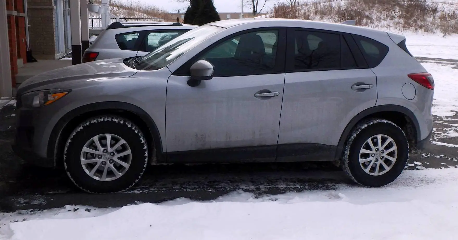

this is my 2015 CX-5 GS AWD with Mazda 5 16" rims and winter tires. The original rims are 17" & 50 in the offset, this Mazda 5 are 52ET, I was checking some Mazda 6 rims and are 60 offset and measuring I think they may touch the calipers @ the front, this ones fit perfectly.
