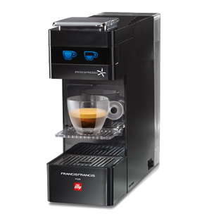

Don't apologize! It's good to mention potential solutions that may be more practical depending upon the intended application. The OP didn't disclose the intended application. A Honda EU2000i would be perfect for serving up quick shots of espresso in ski area parking lots. Very festive! I have a Francis Francis Y3 and it cranks out delicious shots with minimal effort:
Since it's less than 4 inches wide, it would fit nicely in the back of a CX-5.
