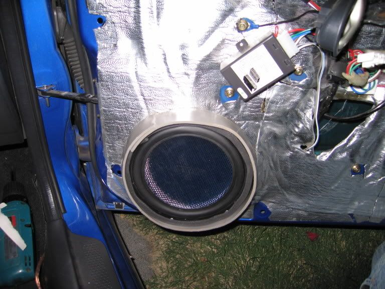

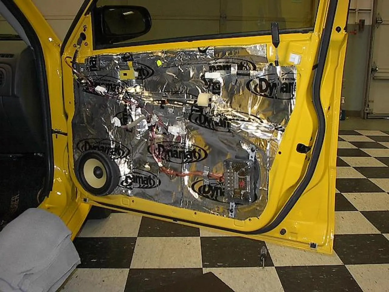

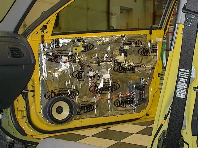

My solution was to use 3/8" HDPE plastic. Here's how it turned out:
I had issues with 3/4 mdf baffles. My Focal KP's hit the door panel. It was a close fit and nothing touched at rest, but when I played them loud, they hit the door. Put a holes in the surround from plastic burrs that I missed when I cut the ring off.
I guess if I'd counter sunk the driver, it would've been ok. But I just cut up some 1/2 and it was fine.
