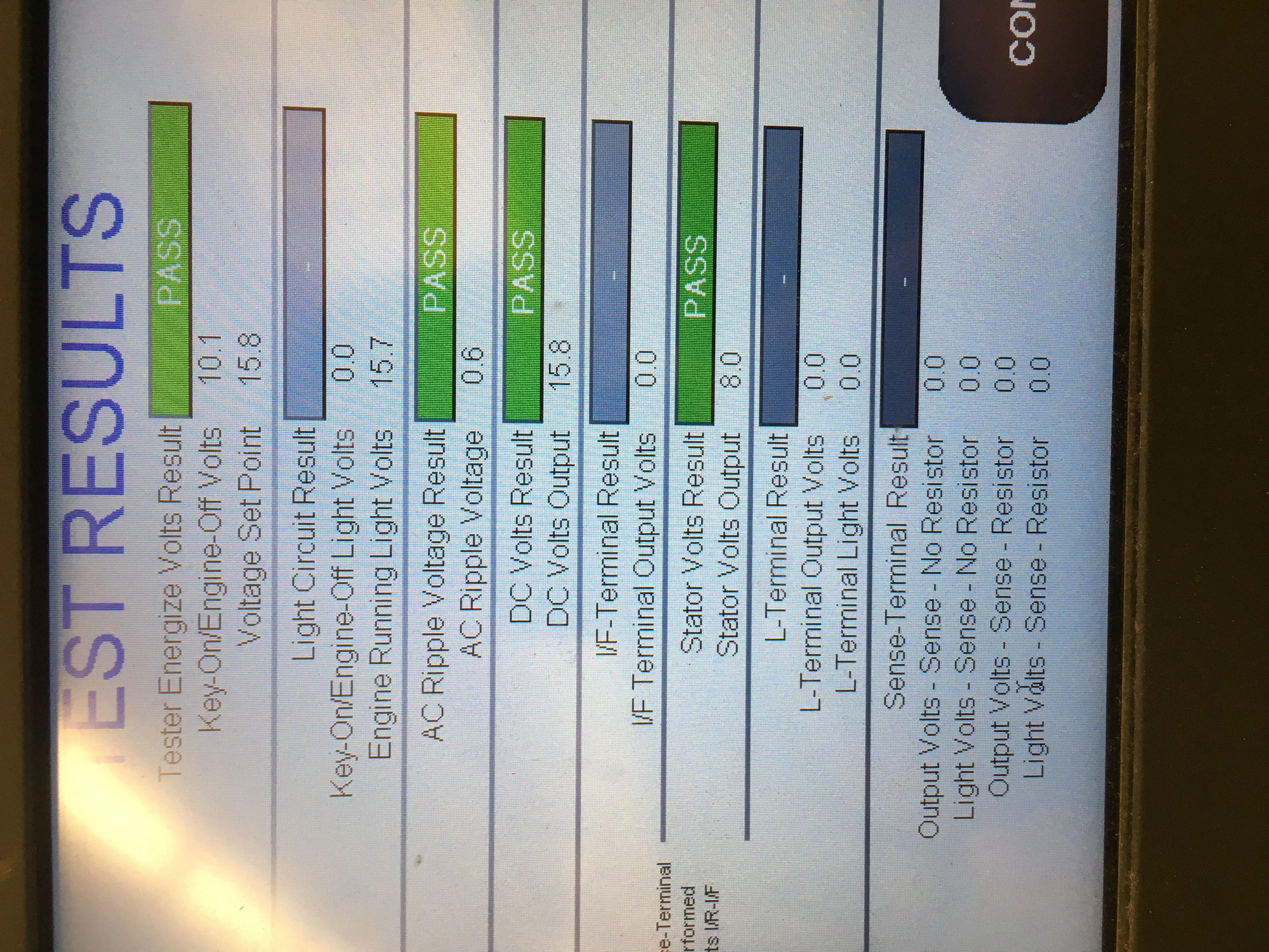

I took the alternator that isn’t in my car and got it bench tested today. The machine couldn’t have been spinning more than 2000 rpm and it says 15.8 volts. Seems high to me. Bench test attached.
Yeah, they all say "PASS" but that sounds wrong to me.
You'll eventually cook your battery especially if it goes all the way to 17.9 Volts at higher RPMs. Not to mention blowing your headlights and other bulbs and circuits as well as a whole bunch of erroneous CEL codes.
I don't think the volts should go past about 14.5 Volts

I got a new alternator, installed and tested it with every single button I could turn on from the inside, high beams, heated defrost, and no battery light at high RPMs.
It's nice having a real alternator, DBElectrical (for our cars) are junk. They are making them produce more voltage it seems. The one that was in my car bench tested at 16V, and I bench tested the Advance Auto Parts (CARQUEST) alternator at 14V.
