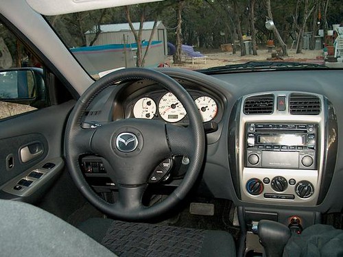

So I guess I'll go ahead and attempt to compile a comprehensive list (including pictures) of all the differences between the 4 models offered on the Protege5. Here goes:
2002
This was the first year the P5 was offered in the US. It was basically an ES with hatchback styling, but a couple other minor differences.
Standard Equipment

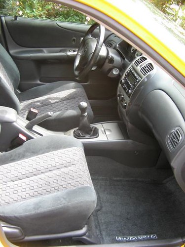

  • Flip-up cupholders
  • No tiptronic automatics

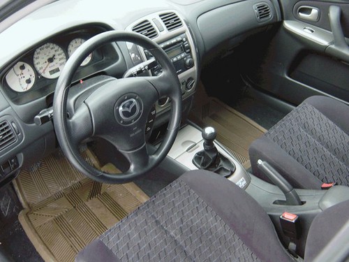

  • Different manual shift knobs

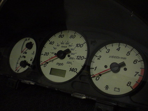

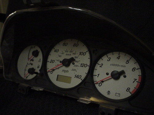

  • White colored gauges

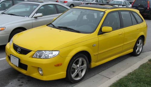

  • Different style wheels
  • Roof Rack
  • No clear side markers

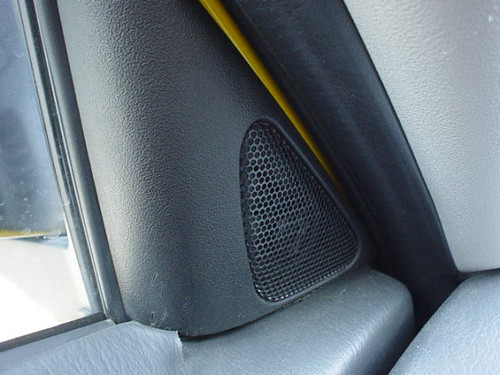

  • No tweeters
  • No leather option
Optional Equipment

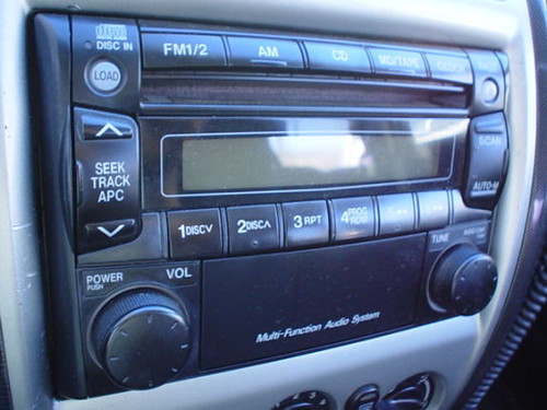

  • In-dash 6CD Changer
  • Sunroof
  • Side airbags & ABS brakes *package requires Sunroof*
Flip-up shallow cupholders
Regular automatic transmission (no tiptronic available)
Different manual transmission shift knob

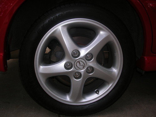

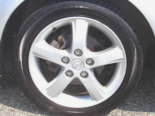

Swirl styled wheels
No clear side markers on fenders
No tweeters next to side mirrors
In-dash 6CD Changer *optional*

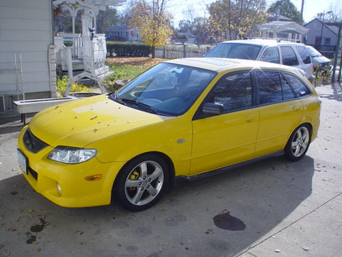

2002.5
The mid year 2002 refresh models, and the 2003 models were almost exactly the same, but not quite. The 02.5 came with the following options:
Standard Equipment

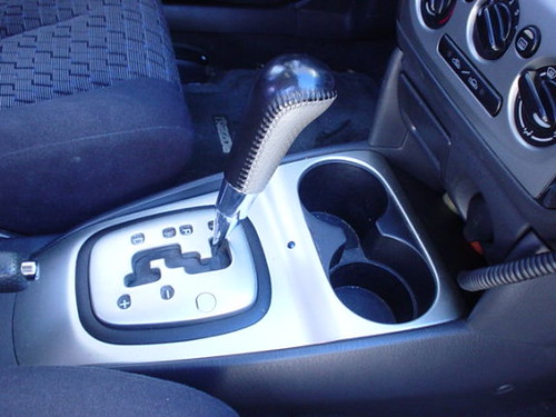

  • Open cupholders
  • Tiptronic automatics

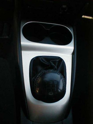

  • Leather manual shift knobs

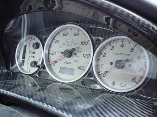

  • Silver colored gauges (automatics had tiptronic cutout)
  • Restyled wheels
  • Clear side markers
  • Tweeters
  • Roof Rack with added baffle to reduce wind noise
Optional Equipment

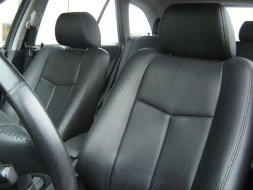

  • Leather
  • 6CD Changer
  • Sunroof
  • ABS
  • Side airbags *6CD Changer, Sunroof & ABS included in package as well*

  • Open cupholders
  • Restyled wheels
  • Tweeters

  • Leather

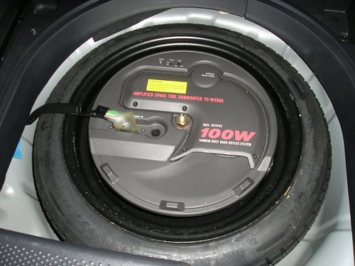

  • Spare tire subwoofer *only a couple months before 03.5 models were launched*

Open cupholders
Tiptronic automatic transmissions
Silver colored gauges w/ sport mode cutout for automatics
Restyled wheels
Clear side markers on fenders
Tweeters

Leather *optional*

This was the last of the P5 models to come out and there was a very limited number of them available. They had all the previous options, except for the roof rack and midnight blue color, and received a unique spare tire subwoofer.
Standard Equipment
  • All option from 02.5 & 03 minus roof rack and midnight blue color

Spare tire subwoofer!!

So if the subwoofer was available '03, are all of the cars that year pre-wired for it? Maybe that's a new thread in itself.
