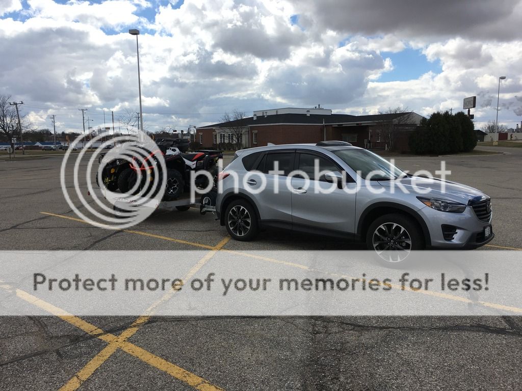

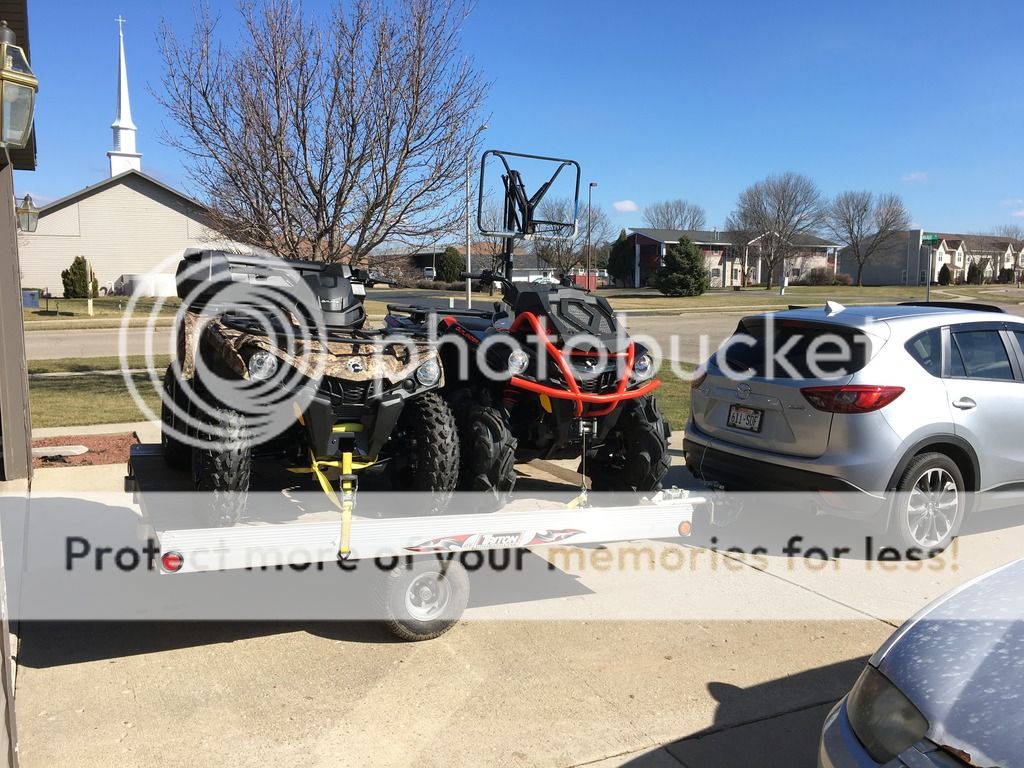

I towed our 2 four wheelers yesterday. Believe me, I am encroaching if not over 2000lbs. I found no issues with power, I did have issues with bumpy roads in which I felt the trailer making the rear of the cx5 dance around a bit. My load was very well distributed.
So I certainly believe air bag inserts would help.
I think that would tow better on bumpy roads if your trailer had a longer tongue and/or the trailer had bigger wheels/better suspension. Also, the tow ball looks to be an inch or 2 too low for that trailer. A riser would help. Airbags in the rear springs may or may not improve it but that would just be a Band-Aid fix for what amounts to a tow setup with poor geometry/balance.
I've towed a lot of trailers over the years using various tow vehicles and getting the geometries right is just as important as the proper tongue weight balance and more important than exactly how heavy it is.

I have found that usually when "the trailer making the rear of the cx5 dance around a bit" it is because of to little tongue weight. Fortunately this is easy to check Go to your hardware store and get a couple of 40 lb bags of water softer salt, or play sand, or cement. (Whatever you or a neighbor can use). Put first one and then two bags on the deck of the trailer as close to the front as possible (Right under the front ATV.) Go for a ride and see what you think. I have a trailer that I tow a lot that has a fixed load. It didn't tow well so I tied the above and 40 lbs did the trick. There are now two 20 lb lead bricks bolted under the trailer.

That is a nice trailer The larger wheels will last longer. A leaf suspension is one of many good suspensions. If I was going across country and had the choice I would take that one. The Tirton trailer is also a quality trailer it is aluminum construction, torsion spring suspension, and smaller wheels. Nothing wrong with any of that. Yes, small wheels will cause more abrupt trailer movement when going over bumps and holes. but it should be fine. I pull a trailer with 8 in wheels and have taken it to multiple states over all kinds of roads and at all speeds up to 70 MPH. No shake, no dance, no sway. It just goes where it's towed to.
I would keep the trailer, raise the ball to make it level, and play with tongue weight. That trailer should tow just fine.
