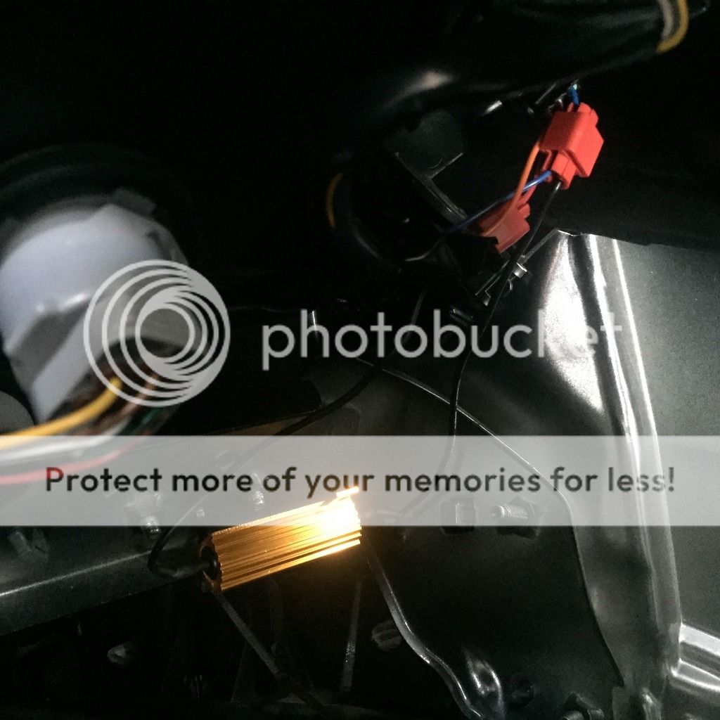

Like the way you described with two-color LEDs. Front turn signal blinks in on-off-on-off instead of on-weak-on-weak pattern during the night like those Euro cars! This makes front turn signal more distinctive during the night and easier to see by the opposite traffic. Unfortunately hyper-flash is always the issue when we switched to LEDs for turn signals. Using resistor is just a patch and it generates heat. The best way is to find a relay which is suitable for LEDs.
Thanks for your testing 72Dime. Some photos of your resistor installation would be appreciated. As noted above, an LED compatible flasher module would be the best solution, but no one has been able to locate where the flasher module is physically located, or at least my question on this point was never answered.

I use those switchbacks as well. Have been using resistors since me 2013 cx5, easy to wire cheap and in that application they dont really get hot. Also it's the engine bay, plenty of metal to mount it on. I just secured mine on the ledge under the hood with some cement type adhesive.

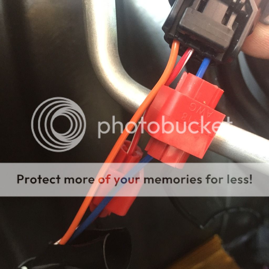

So I finally got around to putting the resistors in. Very simple and straight forward. I taped the blue (negative) and the red/white stripe (blinker) wires with T taps and secured the resistors to a metal brace with a zip tie. Works great, looks great, even better at night. Cheers!!!

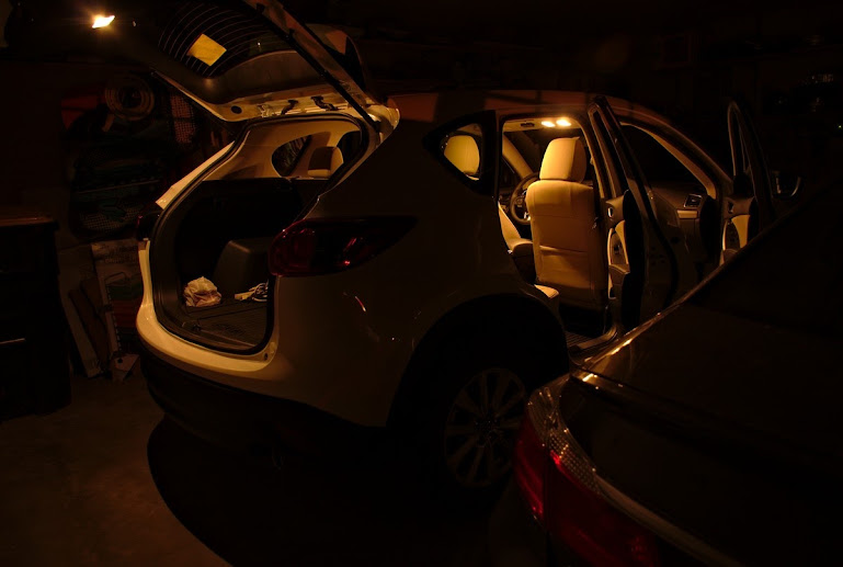

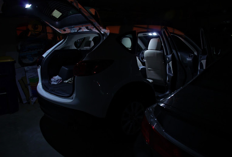

Just replaced mine with this set:
11x White Interior LED Light Package Kit for 2013-2015 Mazda CX5 CX-5 FREE TOOL
I took some RAW photos of before and after with my DSLR in manual mode (same zoom, aperture, shutterspeed, ISO, base curve, and white balance). I'd say that the LED bulbs are not any brighter than the stock bulbs, but I prefer them not too bright for safety, and they use less energy. Though, I'm looking for a brighter bulb for the cargo (on the inner side of the tailgate), any suggestion?
The set came with two pairs for the license plate, I installed the smaller/dimmer one. Both pairs are not bright enough to affect the backup cam.
Stock bulbs:

LED bulbs:
ZzQhDRwyuyLeIyxuYn0s5X4lKIV0t5vP2bTjQHQviqw0p2XWKKz8=w769-h518-no
Your photography is amazing. Best one yet of 43 pages! Thanks for taking the time to create those quality pics and sharing it here! Much appreciated. Great contribution.
