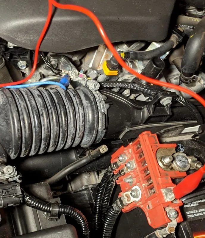

I removed the cover from the positive terminal connection block and connected the positive terminal (orange wire) and engine ground (blue wire) to a 12 volt battery from my lawn tractor. This keeps the electronics 'alive' while replacing the CX-9 battery - that way I don't have to re-program all the settings stored in memory.
Using a 10mm wrench or socket, disconnect the negative terminal (black cable) from the battery first, then the positive terminal (red cable). Loosen the two battery hold down 'J' bolts (also 10mm), unclip from the brackets, remove the hold down assembly and set aside.

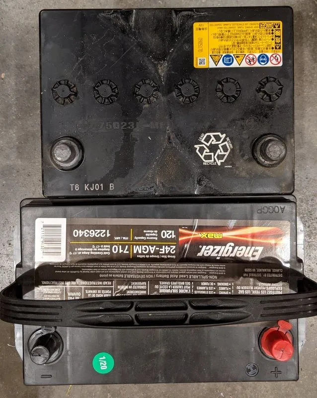

Group 24F vs OEM Group 35. 24F is about 28-30mm longer, but almost exactly same width and height. The 24F case is ~255mm in length.
There's approximately 243mm between the plastic protrusions on each end of the battery tray, but the distance to the ends of the tray is just slightly under 270mm total inside length - lots for a 24F!

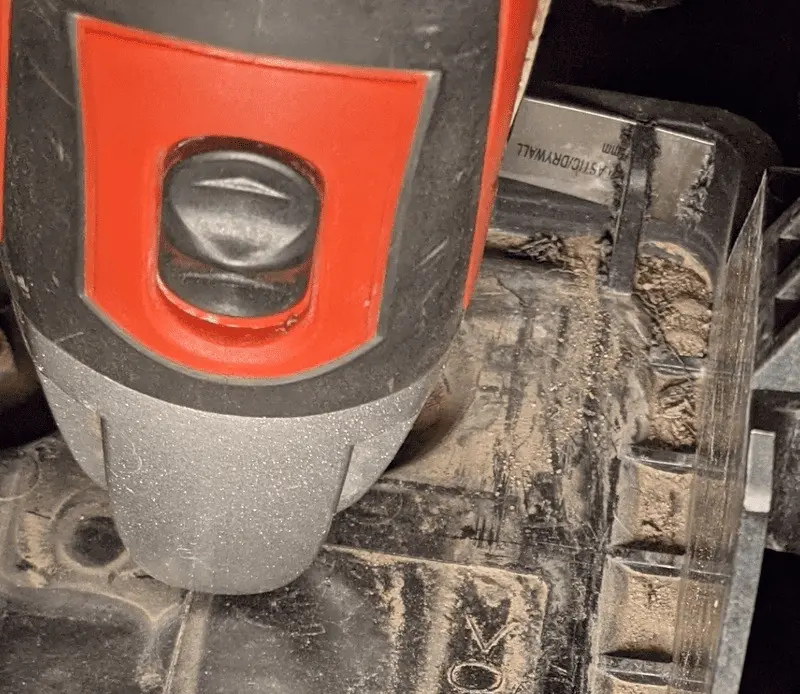

The protrusions are in awkward spots to remove with most tools. An oscillating tool is VERY handy for making these cuts. If you don't have one I'd suggest borrowing one if you can. A hacksaw blade could probably be used, either with a holder that grips only one end of the blade, or just a bare blade (though your hands will need protection from the teeth).
Here I'm cutting the protrusion flush with the bottom of the tray. Notice the angle of the blade relative to the tool.

Notice the position of the blade - one of the great things about these tools is that you can rotate the blade into a variety of positions to make cuts in places no other saw can get into.

I believe both flooded and AGM Group 35 batteries are often better than the OEM battery. Compared to a flooded battery, the AGM battery I bought has roughly 11% more Cold Cranking Amps (710 vs 640) and Cranking Amps (885 vs 800). Reserve Capacity is 120 minutes vs 100, and Amp Hours are 70 vs 57. I suspect most of that is due to the increase in size from the Group 35 to 24F (~12% increase in length).
The only specs I could find for the OEM Panasonic battery show the following - but I don't know if the rating is consistent with North American batteries:
Cold Cranking Amps: IEC 350, JIS 533
Reserve Capacity: 118 minutes
Amp Hours: 70
