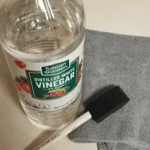

I bought a used CX-5 with the same issue on the infotainment screen. I used white vinegar and a micro-fiber towel and it cleaned it off real nice! Looks brand new now!

I followed the advice in this thread: Anti-glare coating coming off infotainment screen (My detailer stained/damaged the anti-glare coating) so I used white distilled vinegar and a microfiber cloth to remove the rest of the damaged coating, finished with window cleaner/paper towel and a lense cleaner cloth ~10 minutes. It's not as shiny, it's a smidge dull, but I plan on buying a screen protector film.
