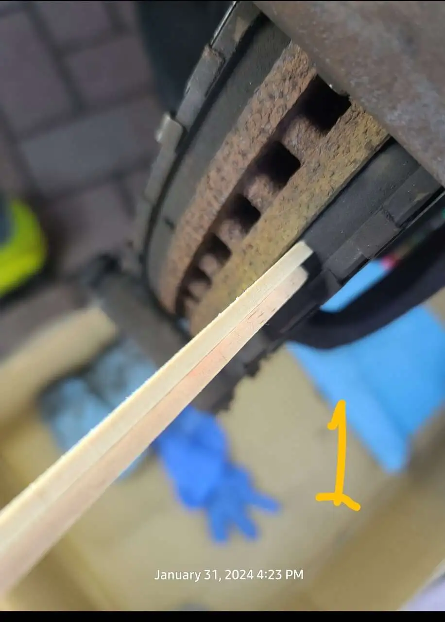

1) Current Front Wagner OEX at 52k usage

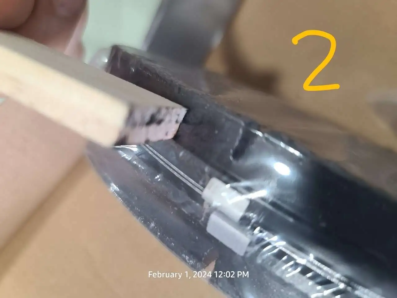

2) picture of new front unused Raybestos eht1258H with the paint stick 👌

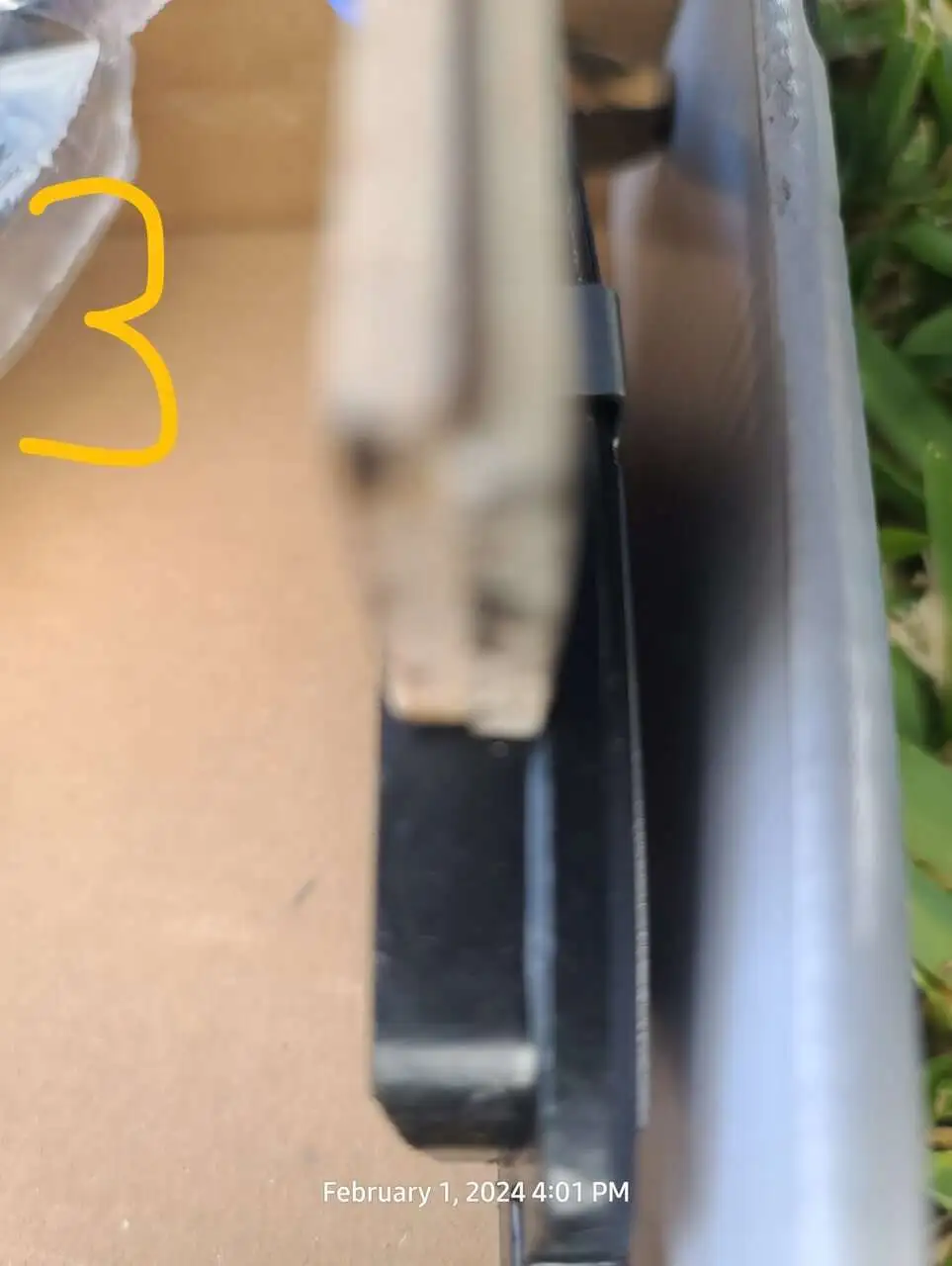

3) New rear raybestos eht1934H

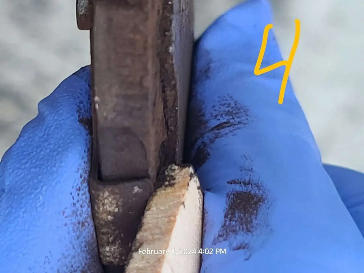

4) Old rear Wagner 28k miles

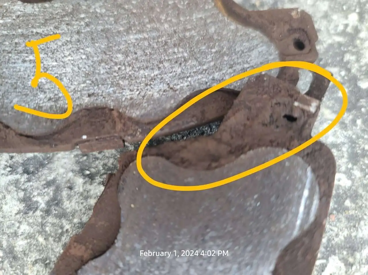

5) The build up of the dust powdered on the pad

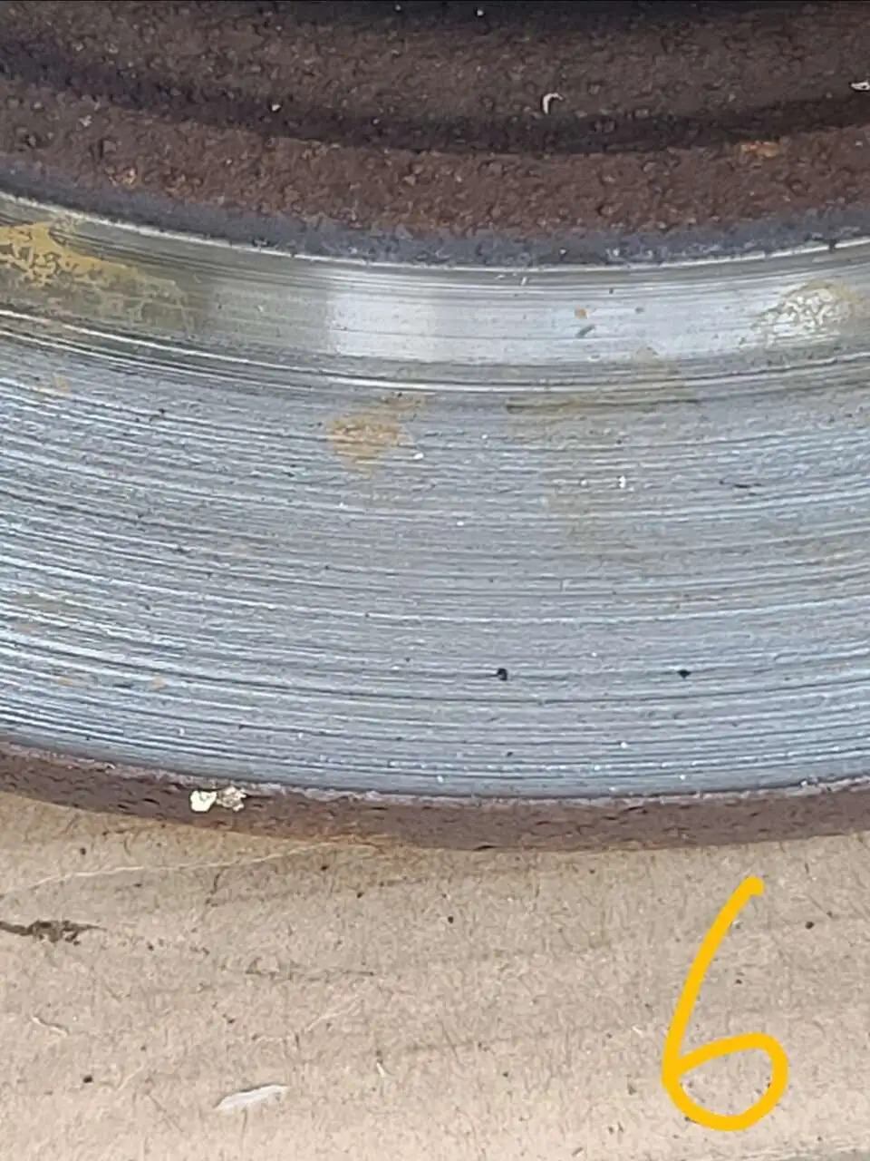

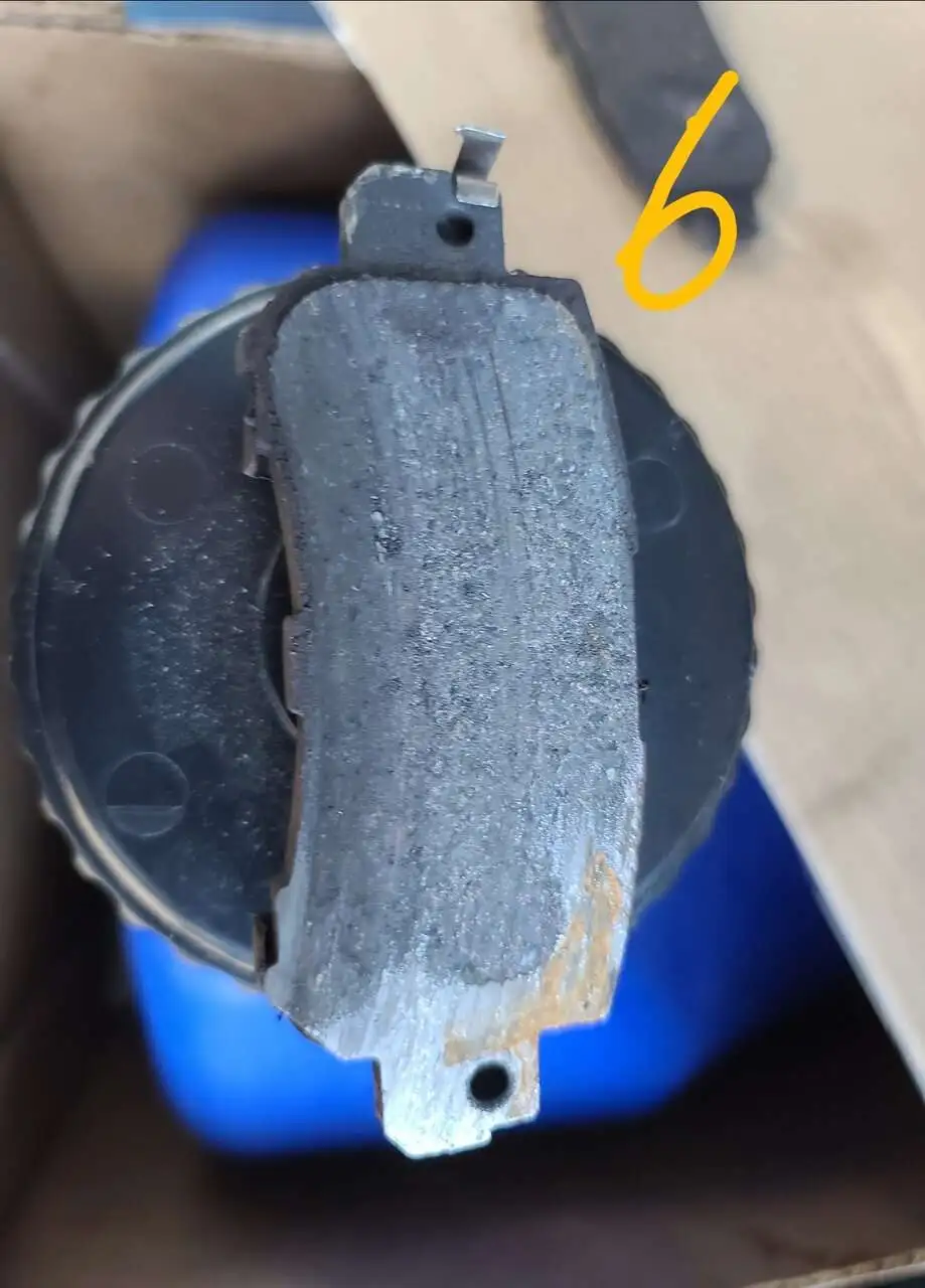

PS) My rear Wagner for Cx 5 didn't last as long to. I think about 35k and was metal (6) main issue was the brake caliper not releasing and destroy my break rotor and pad. There was a bit of life on it. Maybe 5-7k more. If everything had no issues. But it 100% wear out faster then OEM
